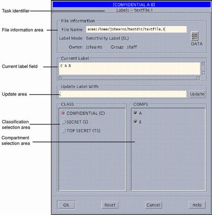

  1. Display the File Manager and navigate to the directory containing the file.
  2. Select the file and choose Labels... from either the popup menu or the Selected menu.
    This step causes the Labels dialog box to be displayed (see figure below).
  3. Click Cancel to close the Labels dialog box.
    Figure 5-11 File Manager Change Label Dialog Box in SL Mode
    Graphic
The file's label appears in the Current Label field. The label will be a sensitivity label or CMW label (combined), depending on how your user account is configured.

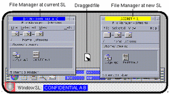

  2. Display the File Manager at the file's current sensitivity label and the File Manager at the new sensitivity label in the same workspace.
    This step entails opening a second workspace at a different sensitivity label, displaying its File Manager, and occupying the original workspace. For a detailed example of this procedure, see "Tour: Occupying Workspaces with Applications at Different Sensitivity Labels".
  3. Drag the file icon from the source File Manager to the File Manager at the new sensitivity label (see figure below).
    Figure 5-12 Dragging a File between File Managers at Different Sensitivity Labels
    Graphic

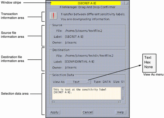

    This causes the File Manager Confirmation dialog box to be displayed. See figure below.
    Figure 5-13 File Manager Confirmation Dialog Box
    Graphic
  4. Click the Apply button in the File Manager Confirmation dialog box to complete the transfer.
