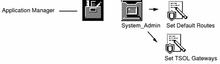

  2. As root, at label admin_low, enter the defaultrouter using the Set Default Routes action, or the tsolgateways using the Static Routing Configuration action.
    See "Set Up Routing" for more explanation.
