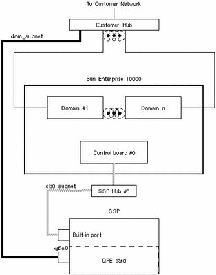

The following table and figure describe the two-subnet network configuration.
Table 2-2 Two-Subnet Network Configuration| Subnet | Name | Description |
| Primary | Domain Subnet or dom_subnet | SSP and the domains |
| Second | Control Board Subnet or cb0_subnet | SSP and the control board |
In Figure 2-1, the Built-in port is le0 for a SparcstationTM 5 and hme0 for a Sun UltraTM 5.
