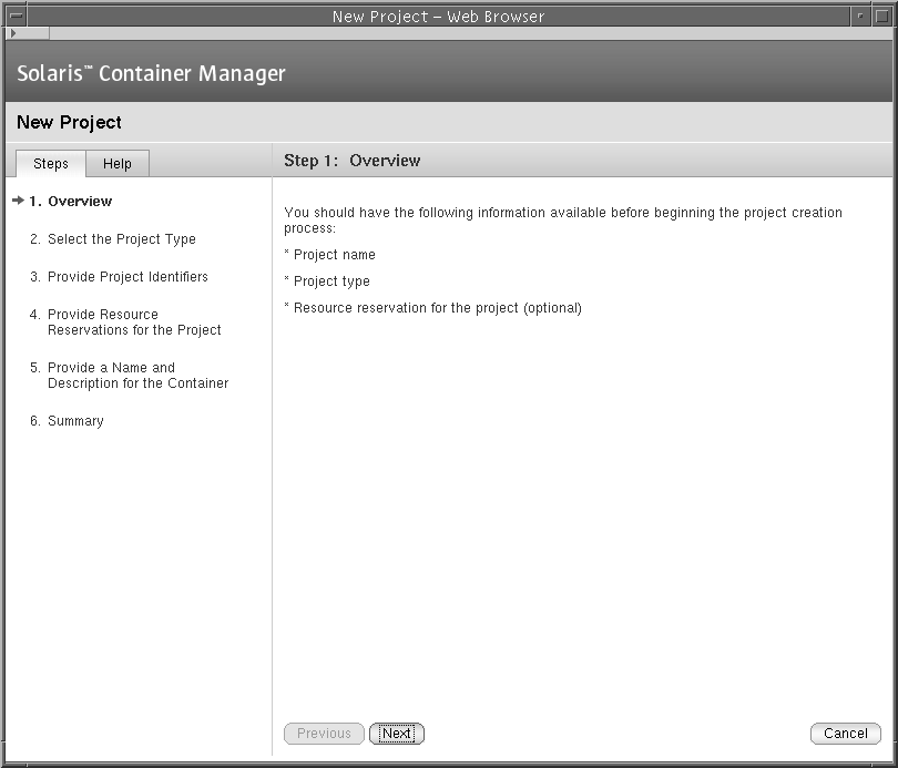

Use the New Project wizard to create custom projects. You have the option to create and save just the container to the Containers view. Or, you can complete all wizard steps to create a project. The same wizard is used for both situations.
If you choose to create just the container, the name is saved in the Containers view. You can use the container to create one or more projects at a later time. For more information about how to activate a project, see Activating or Deactivating Projects.
If you choose to create a project, you also make a container as part of the process. After you finish creating the project, the container is saved to the navigation window of the Containers view. You can use this same definition to create additional projects that are associated with multiple hosts. The definition for all these projects, including the name and project type, will be the same for each of the hosts. You can vary the resource reservations of the project per host, or you can make them all the same. This flexibility is provided so that you can meet resource needs as conditions vary. For more information, see About Container Properties.
The New Project wizard guides you through the project creation process. You should have the following information available when creating a project to move readily through the wizard:

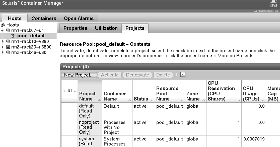

To automatically bind a project to a specific resource pool:
Select the resource pool name from the navigation window in the Hosts view.
If needed, click the key symbol next to the host name to expand the list. The resource pools that are assigned to the host are displayed.
Select the Projects tab located in the right pane.
The Projects table appears.
You are not required to assign a resource pool as part of the container creation process.
Click the New Project button from the host project table or the host resource pool table.
The New Project button is always available from a table that appears in the right pane, regardless of which of the methods you selected.
The New Project wizard is displayed. The Overview panel is the first panel to appear.
Only the user-based container type is available if you are running the Solaris 8 release.
If you want the container to manage processes that are identified by either a UNIX user name or UNIX group name, you should create a user-based or group-based container. The project type that is selected during the creation process determines whether the finished container is user-based or group-based.
Start the New Project wizard, as described in To Start the New Project Wizard.
The Overview panel appears.

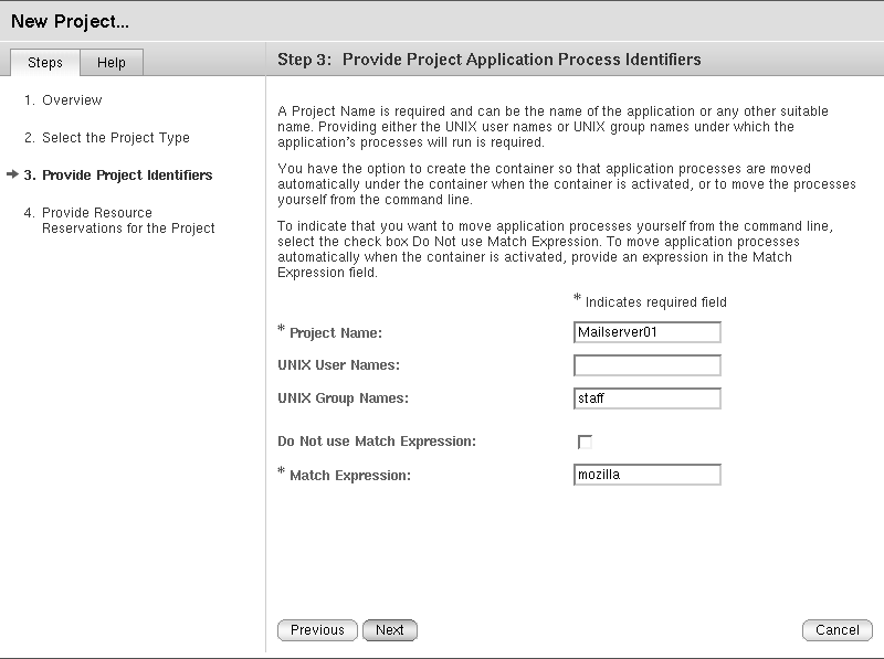

Use an application-based project to manage the processes that run in a particular software application. You can create an application-based project that moves the processes automatically or one that enables you to move the processes manually.
If you can provide a match expression that is truly unique to the application, you can add this expression to the project. You must also provide the UNIX user ID or UNIX group ID under which the processes will run. Additional users or groups that have the right to join the project at a later time can be added as well. To automatically move processes into the project, you must provide all required project identifiers when the corresponding wizard panel appears. The software then moves all matching processes automatically for all the projects that are based on this definition.
If the application does not create truly unique identifiers, then you will want to move the processes manually or start the application inside the project. If you want to move the processes manually, create the project with only the UNIX user ID or UNIX group ID under which the processes will run. Additional users or groups that have the right to join the project at a later time can be added as well. Then move the processes with the newtask -p command. For more information, see Moving or Starting Processes in a Project.
Use this procedure to determine the correct match expression to identify the processes corresponding to the application you want to manage. This expression is required in the New Container wizard to move processes automatically into a container.
From a terminal window, start the application that the application-based container will manage.
To see a list of all processes that are running, in a terminal window type:
% ps -cafe |
In the CMD column, locate the corresponding executable name.
Choose the expression that will uniquely identify the application's processes.
The following is an example of output from the ps - cafe command in a search for Mozilla:
% ps -cafe
UID PID PPID CLS PRI STIME TTY TIME CMD
username 8044 7435 IA 50 19:47:09 pts/11 0:00 /bin/ksh -p /usr/sfw/lib/mozilla/mozilla
In this example, the unique executable name is mozilla. Likewise, a correct match expression is mozilla.
When you know the name of the application, you can use the grep command in conjunction with ps -cafe to locate the correct match expression. The following is an example of output from the ps - cafe | grep tomcat command in a search for Tomcat server. This example has been condensed for space, leaving the irrelevant information.
% ps -cafe | grep tomcat nobody 27307 /usr/j2se/bin/java -classpath //usr/apache/tomcat/bin/bootstrap.jar:/usr/j2se/l |
In this example, the executable name is java. However, the correct match expression is tomcat. In this case, the match expression is the argument instead of the executable name, as java does not uniquely identify the Tomcat processes.
The following example shows how to use the pgrep command to find the PID. The PID verifies that you have identified the unique match expression for finding the desired process:
% pgrep -f tomcat 27307 |
The PID for Tomcat server is 27307. This number matches the PID from Example 4–2. This match confirms that the match expression tomcat corresponds to the Tomcat server process.
start the New Project wizard, as described in To Start the New Project Wizard.
Select Application as the project type for the container.
The application-based project container tracks processes that are associated with the application. For more information about this project type, see Table 3–2.
Provide a name for the project.
The name must be unique and not exceed 32 characters. This name identifies the project in the navigation window, status tables, and resource utilization reports. If a duplicate name is typed, the creation of the project fails.
A container name cannot be changed after the creation procedure is finished.
Provide either the UNIX user names or UNIX group names under which the application's processes will run.
The UNIX user names or UNIX group names under which the application's processes will run must be supplied. If these names are not provided, the corresponding processes will not be moved under the container until they are supplied. Separate multiple entries with a comma.
Determine whether you want to move application processes under the project automatically when the container is activated or to move them manually from the command line.
To indicate that you want to move application processes manually from the command line, select the check box Do Not Use Match Expression.
To move application processes under the project automatically when the project is activated, provide an expression in the Match Expression field.
You can use wildcards in the Match Expression field to identify the processes that are associated with an application. Examples of match expressions using wildcards are moz, cat that identify the processes associated with Mozilla and Tomcat respectively.
The match expression must be supplied to automatically move the application's processes to the container. This expression is case sensitive. To determine the correct match expression, see To Determine the Match Expression for an Application.
If a match expression is not provided at this time, the application's processes will not be moved under this container until this expression is supplied.

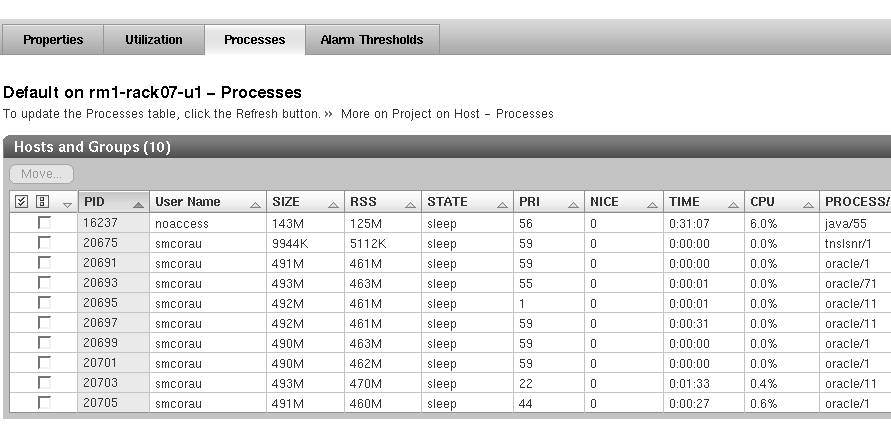

Move the corresponding processes.
From the Container Manager GUI, click the host in the navigation window.
Click the Projects tab.
The Projects table is shown.
In the Projects table, click the project name. Note that the project name is underlined to show it is a link.
The Projects Properties tab is shown.
Click the Processes tab.
The Processes table is shown.
Select the processes to be moved.
Click the Move button.
The Move Process dialog box appears.
Select the new project (containers) for the process from the list of projects (containers).
Click OK.
Repeat Step 5 until all processes are moved.

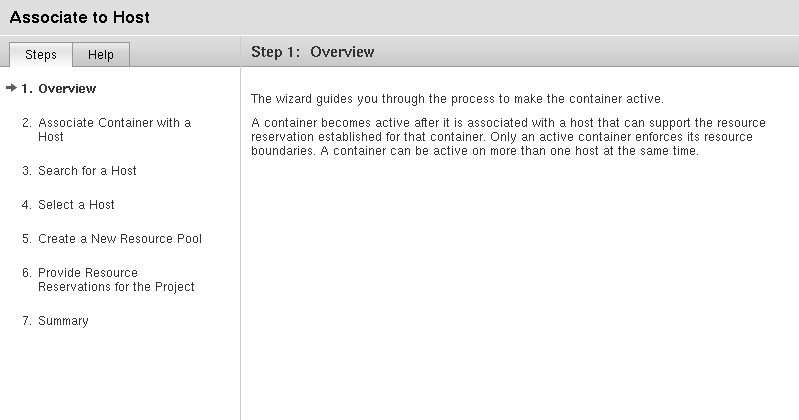

An existing container can be used to create new active projects with the Associate Host to Container wizard. You activate an inactive project or deactivate an active project with a button.
If the Container Manager GUI is not already open, access it as described in To Start the Container Manager GUI.
In the Containers view, select the name of the container.
If the container is part of a group, select the group from the navigation window to display the containers in the right pane.
Select the Hosts tab in the right pane.
The Hosts Associated with this Container Definition table appears. All hosts that the selected container is currently associated with are listed in the table.
Click the Associate Host to Container button.
The Associate Host to Container wizard appears.
Follow the wizard instructions for typing a host name or finding an appropriate host.
In the Hosts view, select the host with which the container is associated.
Select the Projects tab in the right panel.
A table appears that lists all projects that are associated with that host.
To enable the Activate button, select the check box of the project to be activated.
(Optional) View and modify the properties of the project.
Click the name of the project in the Project Name column of the table.
The Properties tab appears.
(Optional) Modify the resource reservations for the project and click Save.
For more information, see Modifying Containers and Projects.
Click the Activate button.
The project is activated and the resource boundaries are being enforced by the kernel.

Information about the processes that are running in an active project can be obtained from a table in either the Hosts view or the Containers view. The same Processes table and identical information is provided in both views.
Processes are listed one per row and the following information is available:
The process ID.
The owner of the process (the UNIX user name or login name).
The total virtual memory size of the process in Mbytes.
The resident set size of the process in Mbytes.
The state of the process. Values include the following:
cpuN – The process is running on CPU N where N is an integer.
sleep – The process is sleeping, or waiting.
run – The process is running.
zombie – The process is terminated.
stop – The process is stopped.
The priority of the process. The higher the number, the higher the process priority.
Nice value that is used in priority computation.
The cumulative execution time for the process.
The percentage of recent time that is used by the process.
The name of the process, which is the name of executed file. The number of lightweight processes (LWPS) in the process.
