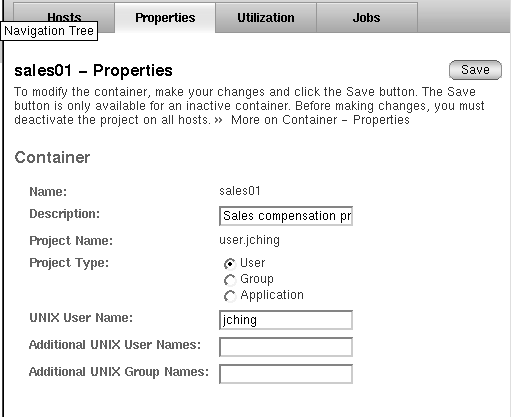

From the Containers view, a separate property sheet is available from which you can modify the container. You can make changes to one container at a time. You cannot use the resource change job feature to make changes to multiple containers.
The following example shows a completed property sheet for changes to the sales01 project instance.
Figure 4–2 Sample: Property Sheet for Modifying a Container
Property Sheet for Modifying a Container Screen

  4. Select the Properties tab from the right pane.
    The property sheet for the selected container appears. You can make the following changes in the text fields:
    • Description – Provide the description of the container.
    • Project Type – Provide the User, Group, or Application.
    • UNIX User Name – Change existing entry for UNIX user name.
    • Additional User – Change existing entries or provide additional valid UNIX user names. Separate multiple entries with a comma.
    • Additional Group – Change existing entries or provide additional valid UNIX group names. Separate multiple entries with a comma.

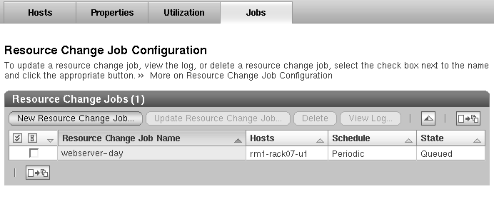

  4. Select the Jobs tab from the right pane.
    The Resource Change Job table is displayed.
    Figure 4–3 Sample: Resource Change Job Table
    Resource Change Job screen
  5. Click the New Resource Change Job button located in the table.
    The Resource Change Job wizard appears. The Overview panel appears.
