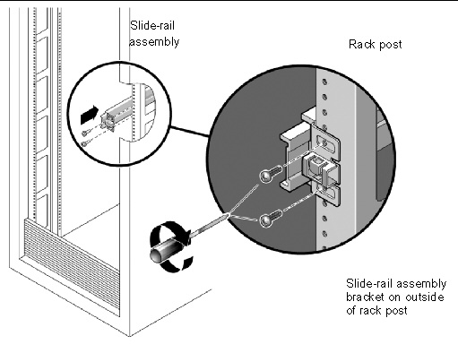

To attach bolt-on slide-rail assemblies to the rack:
1. Select hardware to match your rack posts from the bag of connectors that came with the slide rail kit.
If you use the caged nuts, press them into the holes from the outside of the rack until they clip into place. Once the caged nuts are in place, they provide threaded mounting holes.
2. Position a slide-rail assembly in your rack so that the brackets at each end of the slide-rail assembly are on the outside of the front and rear rack posts. (See FIGURE 2-3.)
3. Attach the slide-rail assembly loosely to the rack posts, but do not tighten the screws completely.
FIGURE 2-3 Slide-Rail Assembly Mounting to Rack Post
4. Repeat Step 1 through Step 3 for the remaining slide-rail assembly.

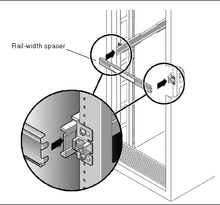

5. From the front of the rack, set the proper width of the rails with the rail-width spacer. (See FIGURE 2-4.)
| Note - The rail-width spacer, shown in FIGURE 2-4, is shipped with the bolt-on rail kit. Use it to set the rails to the proper width, then remove it. |
a. Insert the rail-width spacer into the slot on the inside of the slide rails.
b. Tighten the screws to lock the rails firmly to the rack posts.
c. Remove the rail-width spacer.
d. Confirm that the rails are attached firmly to the rack.
FIGURE 2-4 Setting the Rail Width on the Front of the System
6. Repeat Step 5 for rear of the rack.
On the rear of the rack, the slots for the rail-width spacer are on the inside of the rails, several inches from the ends.

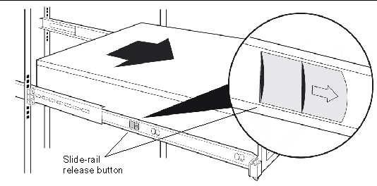

1. Push the slide rails into the slide-rail assemblies in the rack as far as possible.
2. Raise the server so that the rear ends of the mounting brackets are aligned with the slide-rail assemblies that are mounted in the equipment rack. (See FIGURE 2-6.)
3. Insert the server with mounting brackets into the slide rails, then push the server into the rack slowly, until the mounting brackets meet the slide-rail stops (approximately 12 inches, or 30 cm).
Push the server with mounting brackets gently. It will stop abruptly.
FIGURE 2-6 Inserting the Server With Mounting Brackets Into the Slide Rails
(Sun Fire X4140 Server Shown)
4. Simultaneously push both slide-rail release buttons towards the back of the rack, while pushing the server into the rack. (See FIGURE 2-6.)
5. Continue pushing until the front of the server is flush with the rack posts.
The slide-rail lock will latch, securing the server in place with an audible click.
6. Verify that the slide rails work correctly. See FIGURE 2-7.
a. Press the slide-rail release buttons while pulling the server out from the rack.
The server should slide about half way out of the rack, then stop.
b. Simultaneously press the gray slide rail release tabs while pulling the server further out from the rack.
The server should pull the rest of the way out of the rack, until the slide rails are fully extended.
FIGURE 2-7 Location of Slide Rail Release Tabs

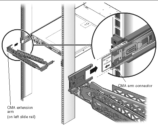

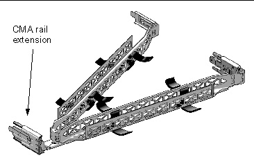

Use this procedure to install an optional cable management arm (CMA). FIGURE 2-8 shows the CMA.
FIGURE 2-8 Cable Management Arm (CMA)
2. Take the CMA to the back of the equipment rack and ensure that you have adequate room to work around the back of the server.
| Note - References to “left” or “right” in this procedure assume that you are facing the back of the equipment rack. |
3. If the CMA rail extension is taped to the CMA arm, remove the tape.
4. Attach the CMA rail extension to the left slide rail until the extension locks into place with an audible click. (See FIGURE 2-9.)
FIGURE 2-9 Inserting the CMA Rail Extension Into the Back of the Left Slide Rail
5. Verify that the CMA rail extension engages the slide rail, as shown in FIGURE 2-9.
| Note - Support the CMA in the remaining installation steps. Do not allow the arm to hang by its own weight until it is secured by all three attachment points. |

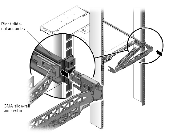

6. Insert the CMA’s mounting bracket connector into the right slide rail until the connector locks into place with an audible click. (See FIGURE 2-10.)
FIGURE 2-10 Inserting the CMA Mounting Bracket Into the Back of the Right Slide Rail
7. Insert the right CMA slide-rail connector into the right slide-rail assembly until the connector locks into place with an audible click. (See FIGURE 2-11.)
FIGURE 2-11 Inserting CMA Slide-Rail Connector Into the Back of the Right Slide-Rail Assembly
8. Insert the left CMA slide-rail connector into the rail extension on the left slide-rail assembly until the connector locks into place with an audible click. (See FIGURE 2-12.)
FIGURE 2-12 Connecting the CMA Arm to the Rail Extension Connector

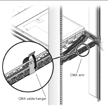

10. Attach the hook and loop straps to the CMA, and press them into place to secure the cables. (See FIGURE 2-13.)
For best results, place three hangers, evenly spaced, on the rear-facing side of the CMA and three on the side facing the server.
FIGURE 2-13 Installing CMA Cable Straps

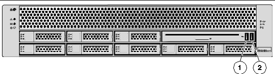

USB ports 2 and 3 are located on the front panel (FIGURE 2-17).
FIGURE 2-17 Sun Fire X4240 and X4440 Front Panel USB Ports

The video port connector uses a HD-15 connector, which is located at the lower right corner of the rear panel (FIGURE 2-16).
Four Universal Serial Bus (USB) ports are provided. USB ports 0 and 1 are located on the rear of the chassis (FIGURE 2-16). Ports 2 and 3 are on the front of the chassis (FIGURE 2-17).
