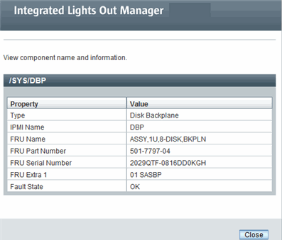

3. When a component is faulted, a radio button will appear to the left of the component name. Click on the radio button to check the fault status. If a radio button does not appear next to a component’s name, click on the name of a component to verify the status.
A dialog box appears with information about the selected component. See the following figure.
