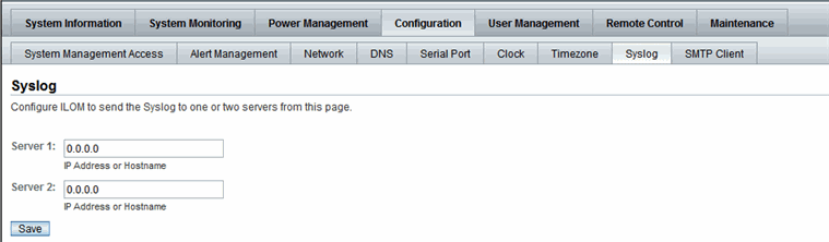

Configure Remote Syslog Receiver IP Addresses |
Follow these steps to configure remote syslog receiver IP addresses:
1. Log in to the ILOM SP web interface or the CMM ILOM web interface.
2. Select Configuration --> Syslog.
3. In the IP Address 1 and 2 fields, type the IP addresses for the two locations to which you want to send syslog data.
4. Click Save for your settings to take effect.
