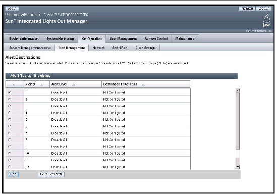

This section explains how to view alert destinations and configure alert settings for the ILOM.
The alert management view allows you to map alert levels to destinations (IP addresses). For example, you can configure it so that all critical alerts are sent to one destination and all non-recoverable alerts are sent to another.
An alert is generated when a sensor crosses the specified threshold. For example, if you configure an alert for critical thresholds, the ILOM sends an IPMI trap to the specified destination when any sensor crosses the upper or lower critical (CT) threshold.
All alerts are IPMI PET traps, as defined in the Intelligent Platform Management Interface (IPMI) v2.0. A special criteria, informational, is reserved for system events that are not related to sensors.
Each line in the alert management view is called a "rule". Each rule identifies an alert level and sends all alerts at that level to the specified IP address.
 Note - Because there are four alert levels and 15 alert rules, you can configure the system to send the same level of alert to multiple destinations.  |
Users with operator privileges can view the alert settings. Changing them requires administrator privileges.
1. Log in to the ILOM as Administrator or Operator to reach the WebGUI
2. From the Configuration tab, choose Alert Management.
The Alert Destinations page appears, displaying a list of alerts.
The alert table includes four columns:
Configuring an alert requires administrator privileges.
1. Select a radio button to select an alert in the table.
3. Select an event severity from the drop-down list.
4. Type the destination IP address for the alert.
The modified alert appears in the Alert Destinations table.
