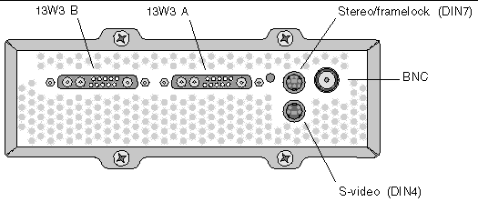

The connectors on the I/O back panel include:
- 13W3 analog video connector, marked B
- 13W3 analog video connector, marked A
- Stereo/framelock connector (7-pin micro-DIN)
- S-video connector (4-pin micro-DIN)
- Genlock In BNC connector
FIGURE F-1 shows the connector locations on the board back panel.
FIGURE F-1 Sun XVR-4000 Graphics Accelerator Back Panel I/O Ports
