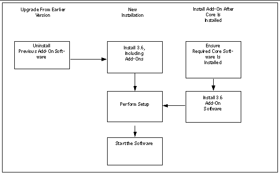

There are two ways to run the installation script. You can use either the traditional installation script, es-inst, or the GUI Install feature, es-guiinst. The installation method you choose determines which setup script automatically runs afterward. For example, if you used the GUI Install program for installation, es-guisetup runs by default.
For complete Sun Management Center core software installation instructions, refer to the current Sun Management Center release notes and to the Sun Management Center Installation and Configuration Guide.
The GUI Setup application enables you to set up the add-on software for the supported platforms through the GUI. For more information about the GUI Setup application, refer to the Sun Management Center User's Guide and the Sun Management Center Installation and Configuration Guide.
To Install the Software |
1. If necessary, install or upgrade to version 3.6 the core Sun Management Center software on the Sun Management Center server, agent, and console.
For details, refer to the Sun Management Center Installation and Configuration Guide.
During the course of installation, you will be prompted to check boxes for all the add-on products you want to install. Check the box for
2. If you have already installed core Sun Management Center 3.6 but have not yet installed this version of the add-on software, perform the following steps.
a. Install the Sun Management Center 3.6 add-on server software on the Sun Management Center server.
b. Install Sun Management Center 3.6 agent software and the add-on agent software on the platform(s) to be monitored.
See FIGURE 2-1 for high-level details of the installation process.
