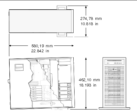

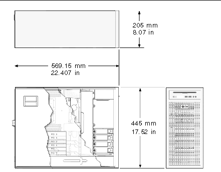

The physical specifications of the Sun Ultra 45 or Ultra 25 workstation are shown in TABLE B-1, FIGURE B-1, and FIGURE B-2.

FIGURE B-1 Workstation Dimensions With Stabilizer Open
FIGURE B-2 Workstation Dimensions Without Stabilizer
