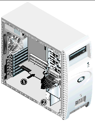

The left-side access panel must be removed to gain access to the system's internal components. See FIGURE 4-1 when performing this procedure.
1. Turn off the system and all of the peripherals connected to it.
2. Loosen the two captive thumbscrews located on the edge of the left-side panel closest to the rear panel (1).
3. Slide the panel towards the rear of the workstation (2). Tilt the top edge of the panel out (3) and then up (4) to remove it from the chassis.

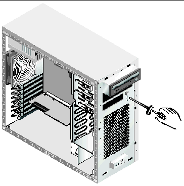

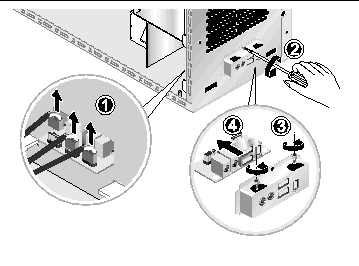

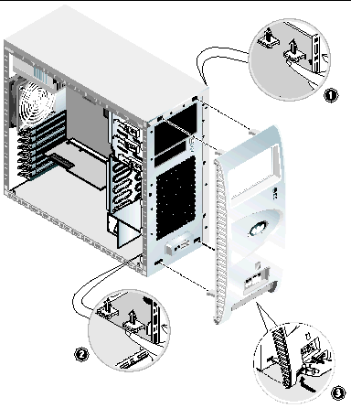

To remove the front bezel from the workstation:
1. Remove the CD/DVD drive as instructed in Section 4.5.2, Replacing a CD/DVD Drive.
2. Remove the filler panel in the second 5.25 inch bay (if a second drive is not installed).
3. After the CD/DVD drive and filler panel are removed, reach through the back of the CD/DVD drive bay and push the retention clips on the top of the bezel upward. See (1) in FIGURE 4-2).
4. Pull the top of the bezel away from the chassis.
5. Press the retention clips on the bottom of the bezel upward(2) to release the bezel and pull the bezel away from the chassis. (3)

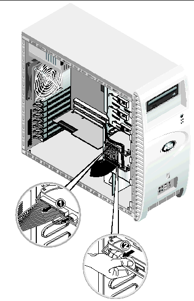

This procedure describes how to remove a hard disk drive. See FIGURE 4-4 when performing this procedure.
To remove the hard disk drive:
1. Turn off the system and all of the peripherals connected to it, then unplug the AC power cord from the system.
2. Remove the left-side access panel.
3. Disconnect the power and data cables from the drive (1).
4. Grasp the hard-disk-drive carrier handle at its center (2), then gently withdraw the drive from the cage.
5. If you are replacing the hard drive, unfasten the four screws securing the hard disk drive to the carrier and remove the drive.
Installation is the reverse of this procedure.

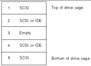

To install additional hard disk drives when one or more hard disk drive are already installed:
Caution - Make sure to observe the proper ESD precautions when installing the hard disk drive. |
3. Remove the empty drive carrier from the drive cage, if necessary.
4. Insert the hard disk drive into the drive carrier, and fasten the four screws to secure the hard disk drive to the carrier.
5. Gently push the hard disk drive carrier into the drive cage.
Use drive bays 2 and 4 if you are installing IDE drives. Use bays 1, 2, 4 or 5 if you are installing SCSI drives. Leave bay 3 empty or use it to store excess cable. See FIGURE 4-5 for positions of drive bays.
6. Follow the instructions for the type of hard disk drive that you are installing:
a. Connect drives in bays 1 and 2 to SCSI channel A and drives in bays 4 and 5 to SCSI channel B.
b. Use the target ID 0 for drives in bays 1 and 4. Use target ID 1 for drives in bays 2 and 5.
Refer to the manufacturer's documentation that comes with the hard disk drive to determine the exact jumper settings.
a. Change the jumper settings so that the drive that was installed first is the master and the newly installed drive is the slave.

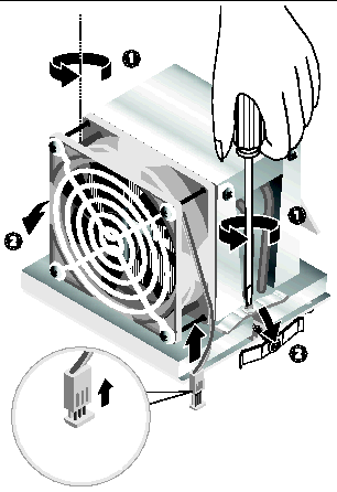

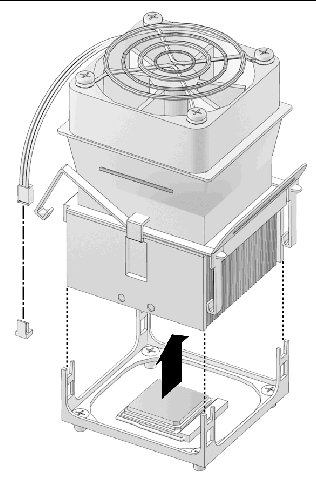

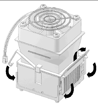

The procedures for removing a heatsink/fan assembly will vary, depending on the model of assembly installed on the motherboard. Make sure to identify the heatsink/fan assembly part number before doing the installation.
Caution - The heatsink can become extremely hot. Allow a few minutes for the heatsink to cool before attempting the upgrade. |

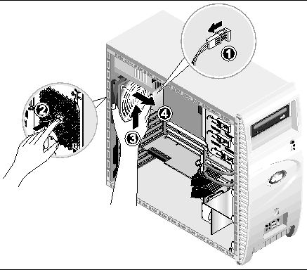

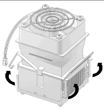

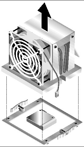

1. Disconnect the CPU fan cable from its connector.
2. Choose the bullet that corresponds with the heatsink/fan assembly installed on the motherboard.
3. Twist the heatsink/fan assembly to the right or the left, in order to break the seal with the thermal grease.
4. Lift the heatsink/fan assembly straight up and withdraw it from the board (see FIGURE 4-11 and FIGURE 4-12).
5. Place the heatsink upside down on a flat surface to prevent the thermal grease from contaminating other components.
6. Use an alcohol pad to clean the thermal grease from both the bottom of the heatsink, and the top of the CPU.
Note - Failure to clean the CPU before removing it could result in the accidental contamination of the CPU or other components. |

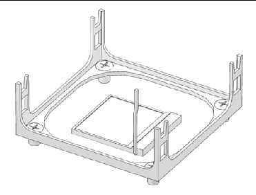

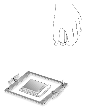

7. First depress, then pull, the socket retainer lever up to the fully open, perpendicular position (see FIGURE 4-13).
8. Lift the CPU out of the socket, leaving the retainer lever in the open position (see FIGURE 4-14).

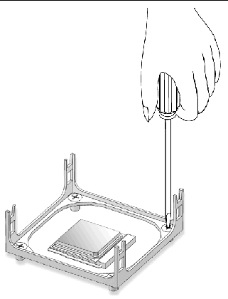

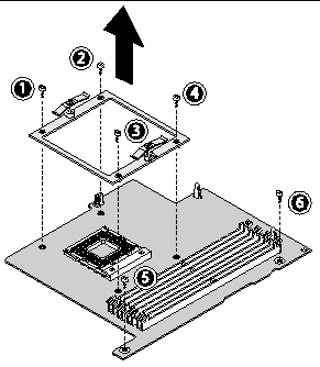

9. If you are replacing the heatsink, take the appropriate step below:
a. Remove the 4 screws fastening the original retaining bracket to the motherboard.
Keep the screws for installing the new retaining bracket.
b. Install the new retaining bracket onto the motherboard and fasten the four screws.

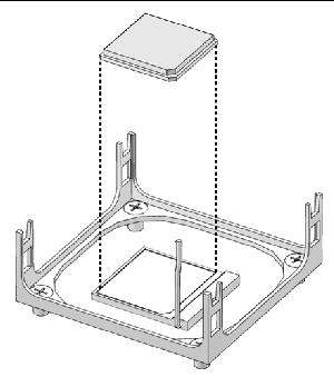

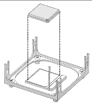

To install a heatsink and CPU:
1. Observe the ESD precautions and preinstallation procedures described in Section 4.2.1, ESD Precautions.

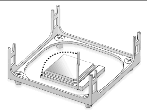

2. Ensure that the socket retainer lever is in the fully open, upright position (see FIGURE 4-17).
3. Align the CPU to its socket so that pin 1 of the CPU (indicated by the notched corner) is aligned with hole 1 of the socket, (indicated by the arrow in the corner of the socket).
4. Insert the CPU into the socket (see FIGURE 4-18).
Note - When correctly aligned, the CPU should drop effortlessly into the socket. Do not attempt to force the CPU into the socket in order to seat it. |
5. When the CPU is positioned in the socket, press down on the socket retainer lever to lock the CPU in place.

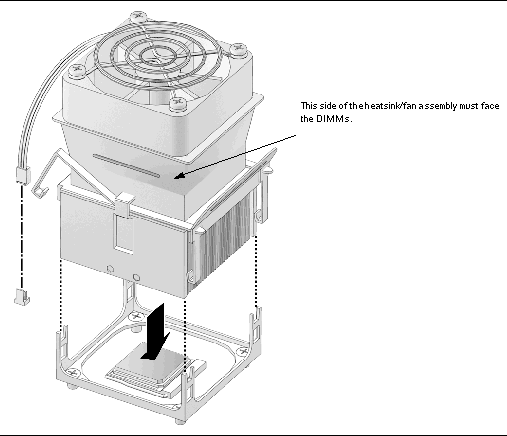

6. Carefully position the heatsink/fan assembly on the CPU, aligning it with the mounting posts to reduce movement after it makes initial contact with the layer of thermal grease (see FIGURE 4-19).
Note - Make sure that the side of the heatsink/fan assembly with the slit is facing the DIMMs. |
Caution - If the heatsink assembly is moved too much during its installation, the layer of thermal grease might not be distributed evenly, leading to component damage. |

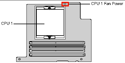

7. Connect the CPU fan cable to the connector on the motherboard (see FIGURE 4-19).
8. Fasten the latches on one side of the heatsink/fan assembly, then latch the other side (see FIGURE 4-20).

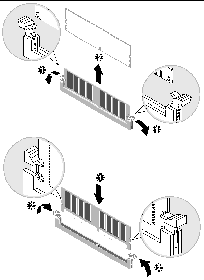

This section contains instructions for removing and installing a dual in-line memory module (DIMM). See FIGURE 4-21 when performing this procedure.
Note - Before removing any DIMMs from the motherboard, create a backup file to preserve any important data. |
3. Gently lay the system on its right side on a stable, non-slip surface.
4. Identify the location from which you will remove a DIMM.
5. Remove the DIMM by pressing down on the ejector bars at both ends of the DIMM socket.
Note - Place your forefingers on the top of the DIMM before pressing down on the ejector bars, to gently disengage the DIMM from the socket. |
Note - The DIMM socket is slotted to ensure proper installation. |

6. Install the DIMMs as instructed in Section 4.5.5.1, Replacing DIMMs.
The system automatically detects the amount of memory installed. Run the BIOS setup to view the new value for total system memory and make a note of it.

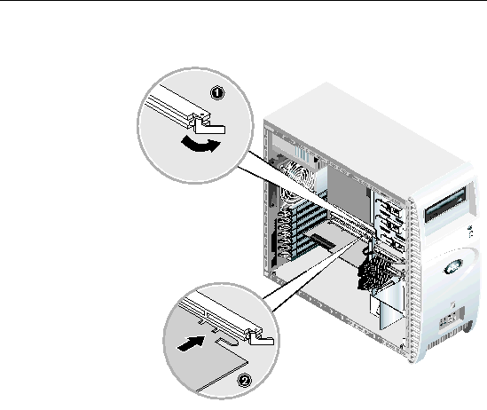

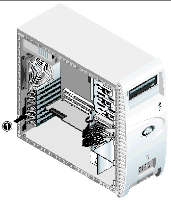

This procedure describes how to install a typical PCI card (including the host bus adapter) or AGP card. PCI and AGP cards may vary in the way in which they are installed in the system. For example: PCI cards may be either full-length cards or half-length cards; AGP cards are secured in the AGP card slot with a latch. Visually inspect each card to determine its mounting requirements before beginning this procedure.
4. Refer to the Service Label, attached to the inside of the access panel, to choose an empty card slot that is compatible with the card that you are installing.
5. Working from inside the chassis, compress the blue retention clip (securing the selected slot cover) until it passes through the cutout in the rear panel (see (1) on FIGURE 4-22). Then pivot the clip outwards.
6. Pull out the slot cover (see (2) on FIGURE 4-22).
7. Remove the PCI or AGP card from its protective packaging. If necessary, lay the card on an anti-static surface until you are ready to install it.
8. Refer to the bullet below that corresponds to the card you are installing:
a. Position the card over the selected slot (see (1) on FIGURE 4-23). If you are installing a full-length card, slide the forward edge of the card into one of the indentations in the card guide, located immediately below the drive cage (see (2) on FIGURE 4-23).
b. Press down on the card until it is completely seated in the slot.
a. Make sure that the card latch, at the forward end of the AGP slot, is completely opened (see (1) on FIGURE 4-24).
b. Position the card in the selected slot (see (2) on FIGURE 4-24). Ensure that the notch, on the bottom right corner of the card, engages the latch.
c. Press down on the card until it is completely seated in the slot.
d. Pivot the latch up and towards the rear of the chassis to secure the card in place.
Note - If the latch cannot be engaged with a minimum of force, the card is not correctly seated. Remove the card, reinsert it, and attempt to engage the latch again. |
9. Rotate the retention clip back into the chassis until the clip snaps into place (refer to (1) on FIGURE 4-25).
10. Connect any necessary adapters or cables to the card.

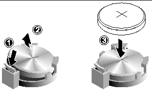

To remove and install the battery (see FIGURE 4-26):
4. If a mezzanine card is present, remove it and/or the PCI card in Slot 1 to gain access to the battery socket.
5. Insert a small flathead screwdriver between the battery and spring latch to dislodge the battery from its socket (1).
6. Lift up the battery to remove it (2).
7. Insert a new battery with the positive sign (+) facing up, and ensure that it is seated completely (3).

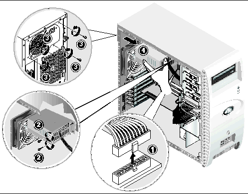

To remove the system fan (see FIGURE 4-27):
4. Disconnect the system fan's power connector from the motherboard (1).
5. Working from outside the rear of the chassis, press the spring-loaded button, at the center of the system fan (2).
6. While holding the button in, slide the fan up (3) and withdraw it from the mounting slots (4).
7. Detach the fan from its frame by unclasping the four tabs on the frame before pulling the fan away.

To remove the USB audio card assembly (see FIGURE 4-30):
2. Remove the left-side access panel and the front bezel.
3. Place the system unit on a flat, stable surface.
4. Disconnect the audio, USB, and IEEE 1394 cables from the audio board (1).
5. Working from the front of the chassis, unfasten the single screw securing the USB audio card assembly to the system's front panel (2).
6. Gently lift the audio assembly up and slightly away from the front panel.
7. Remove the two screws that hold the audio board to the metal frame (3).
8. Withdraw the audio card from the metal frame (4).

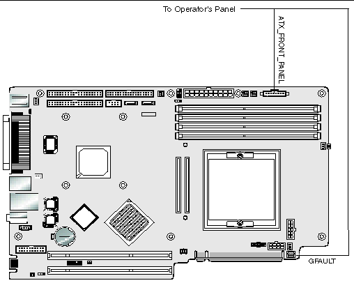

To remove the operator's panel:
4. Working from the front of the chassis, unfasten the single screw securing the operator's panel to the front of the chassis (see FIGURE 4-31).
5. Working from inside the chassis, grasp the operator panel cables and gently pull the panel into the chassis.
6. Disconnect the two connectors attaching the operator's panel to the motherboard and withdraw the operator's panel from the chassis (see FIGURE 4-32).

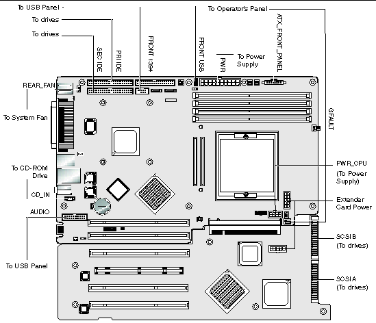

The following list of system cables have a connector at each end, and so may be removed or installed by the customer. All other cables are permanently attached to a system component at one end and must be removed or replaced along with the component.
Each cable connector on the motherboard and extender card is labeled to help you identify the cable to which it should be connected.
To remove and install system cables:
4. Ensure that all cable routing is correct, and that all of the cable connectors are properly seated, before re-installing the left-side access panel.
Use FIGURE 4-33 to identify the cable to be replaced.

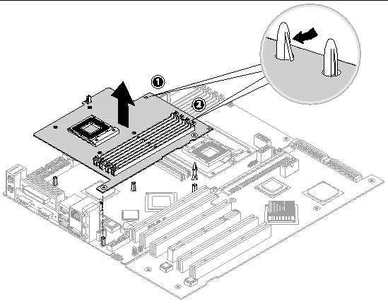

4. Remove the heatsink/fan assembly (refer to Section 4.5.4, Replacing a CPU) in order to expose four of the mezzanine card's mounting screws.
5. Unfasten the six screws securing the mezzanine card to the motherboard (FIGURE 4-34).
6. Use a pair of needle-nose pliers to push in the latch on each of the two white standoffs holding the card to the motherboard (see FIGURE 4-35).
Caution - When you push in the mezzanine card standoffs, make sure that you do not damage the capacitors that are located near the standoffs. |
7. Lift the mezzanine card straight up to release it from the two connectors on the motherboard.
8. Remove the CPU (refer to Section 4.5.4, Replacing a CPU).
9. Remove the DIMMs (refer to FIGURE 4-21).

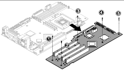

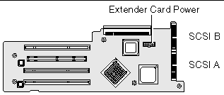

This procedure describes how to remove the Extender card.
3. Gently lay the system on its right side on a stable, nonslip surface.
4. Remove any PCI Cards installed on the extender card (refer to Section 4.5.6, Installing a PCI or AGP Card).
5. Pivot the front card guide (located below the drive cage) up and towards the front of the chassis.
6. Disconnect the SCSI data cable and the power connector from the extender card (see FIGURE 4-36).
7. Unfasten the audio cable (coming from the USB panel at the front of the chassis) from the FRONT_AUDIO connector on the motherboard.
8. Release the audio cable from the cable clip, located at the bottom left corner of the chassis, and lay the cable over the front of the chassis.
9. Unfasten the 5 screws securing the extender card to the system chassis (see (1) through (5) on FIGURE 4-37).
10. Gently lift the side of the extender card, that is next to the bottom of the chassis, approximately 1 inch.
11. Pull the extender card away from the motherboard to disengage the connector (see (6) on FIGURE 4-37). Withdraw the extender card from the system chassis and place the card on a suitable antistatic surface.

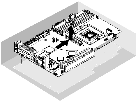

Note - The motherboard is not a CRU and should be replaced only by trained field service technicians. |

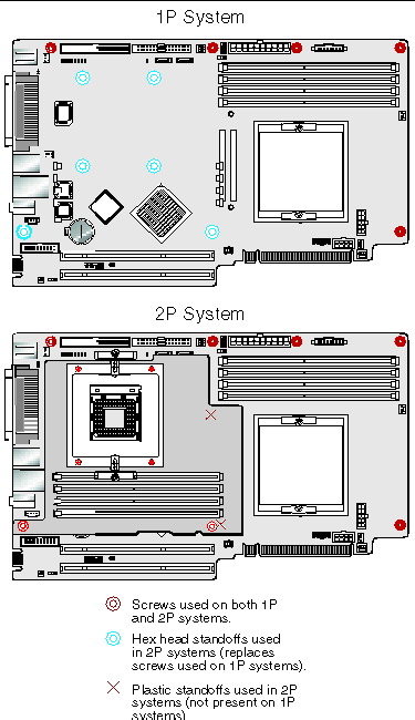

4. Remove any PCI cards installed on either the extender card or the motherboard (see Section 4.5.6, Installing a PCI or AGP Card).
5. Remove the extender card, as described in Section 4.5.14, Replacing the Extender Card.
6. Remove the mezzanine card (if present) as described in Section 4.5.13, Replacing the Mezzanine Card.
7. Disconnect all cables attached to the motherboard (see FIGURE 4-38).
8. Unfasten the motherboard from the chassis.
a. Use a hex-nut driver to remove 6 hex-head standoffs.
b. Remove five Philips head screws.
c. Use needle-nosed pliers to release the two plastic standoffs.
Note - Do not remove the four screws that secure the CPU 0 heatsink/fan assembly mounting to the motherboard. |
9. Slide the motherboard towards the front of the chassis (see (1) on FIGURE 4-40) and then lift it up to withdraw it (2).
Refer to the following sections to remove and replace the CPU and memory:
Caution - Observe proper ESD precautions when handling the new motherboard. |
