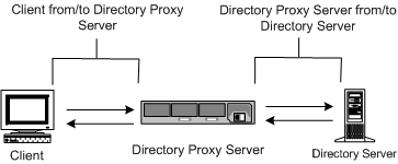

Directory Proxy Server has two separately configurable communication links. Each communication link can be plaintext or encrypted using Transport Layer Security (TLS) or Secure Sockets Layer (SSL) protocol. Availability of the two separate communication links enables you to configure TLS- or SSL-enabled communication between an LDAP client and Directory Proxy Server and between Directory Proxy Server and an LDAP directory. Figure 12-1 illustrates this capability of Directory Proxy Server.
Figure 12-1 Two Separate Communication Links in Directory Proxy Server

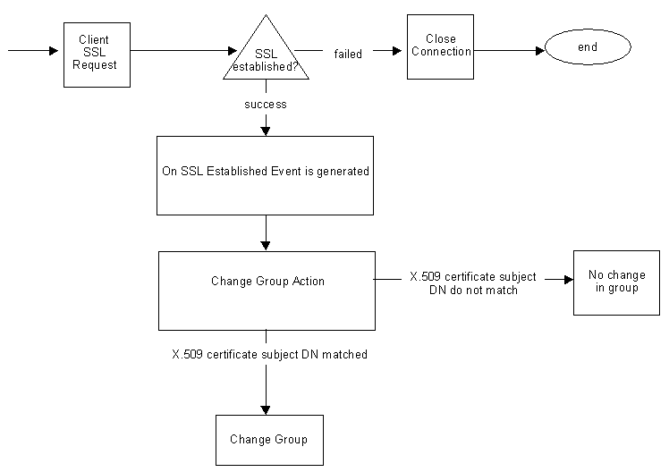

Directory Proxy Server can verify both client and server certificates, provided the trusted root CA certificate for the certificate being validated is installed and is available to Directory Proxy Server.
Figure 12-2 illustrates how Directory Proxy Server can verify the certificates presented to it by the clients after they establish an SSL session.
Figure 12-2 Certificate-Based Authentication of Clients

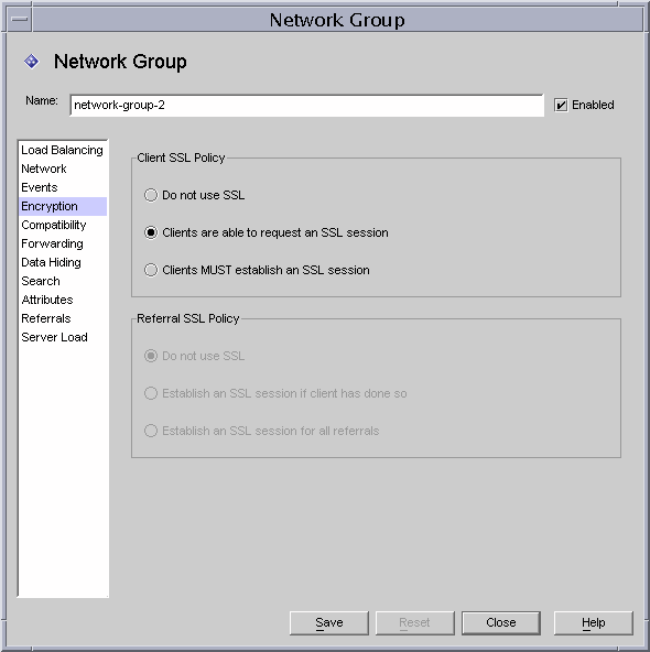

To Make Changes to the Directory Proxy Server Network Groups
Directory Proxy Server uses network groups to identify clients and determine their access privileges to the information contained in an LDAP directory; for details, see Creating and Managing Groups.
In each group that you've configured, set the appropriate options in the Encryption tab to indicate whether you want to force the client to start a TLS session before sending any LDAP operation, leave the decision to the client, or disallow the client to start a TLS session. For example, you might want to enable "SSL is available" and "Clients MUST establish an SSL session" options. For more information about the options presented in the Encryption tab, see Step 9 of To Create a Network Group in Directory Proxy Server.
If referral following is enabled, you should check the Referral SSL Policy. Referral following is enabled by selecting Referrals in the list on the left side of the window.
Directory Proxy Server can follow referrals returned by the backend servers. The LDAP URLs returned must be in RFC 2255 format. If no host port is given, the client must have some knowledge of an appropriate LDAP server to contact.
Directory Proxy Server interprets LDAP URLs with no host or port number as a referral to the same host that issued the referral. For example:

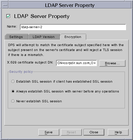

To Make Changes to the LDAP Server Properties
The Encryption tab in the LDAP Server Property window enables you to define SSL-enabled communication criteria for each LDAP server. For details, see Creating LDAP Server Property Objects.
Make the following changes to the appropriate LDAP Server property objects, and save your changes.
- Set the "Security policy" option to an appropriate value so that Directory Proxy Server will always establish SSL/TLS to the backend server, never establish TLS/SSL to the backend server, or only establish SSL/TLS with the backend server when the client does the same to Directory Proxy Server.
- Set the "X.509 certificate subject DN" field to the LDAP server's certificate subject name (the subject attribute in the X.509 certificate). If specified, Directory Proxy Server will attempt to match the certificate subject with the subject present on the LDAP server's certificate and will reject a TLS session if there is a mismatch. (This attribute allows Directory Proxy Server to authenticate the LDAP server to which it is connecting. Directory Proxy Server accepts any name if this attribute is not set.)
