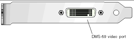

DMS-59 Video Port
FIGURE B-1 shows the Sun XVR-300 x8 graphics accelerator DMS-59 video port.
FIGURE B-1 Sun XVR-300 x8 Graphics Accelerator DMS-59 Video Port
