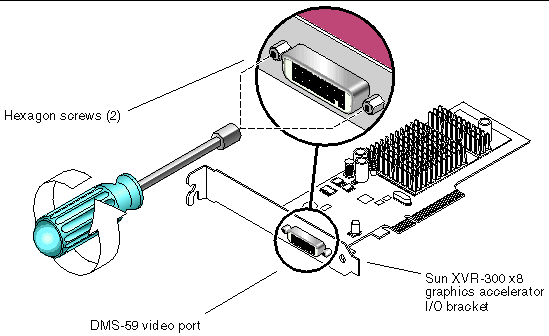

Your system might require replacing the Sun XVR-300 x8 graphics accelerator full-height bracket with a low-profile bracket. The low-profile bracket is included in the installation kit.
1. Remove the two hexagon screws that secure the mounting bracket to the board assembly and set them aside (FIGURE 2-1).
Use a 1/8-inch hexagon socket screwdriver.
FIGURE 2-1 Replacing the I/O Bracket
2. Remove the full-height bracket by sliding the bracket off the board assembly DMS-59 video port connector.
3. Install the low-profile bracket by placing it on the board assembly in the same orientation.
4. Secure the bracket to the board assembly by replacing the two hexagon screws and tightening them.
