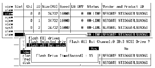

Note - The following steps only work if there is no I/O activity and the drive is visible to the controller. Under certain fail scenarios, the controller might not be able to detect the failed drive. |
a. On the RAID firmware Main Menu, choose "view and edit Drives" and press Return.
b. Select the drive you want to identify and press Return.
c. Choose the "Identifying scsi drive" function.
d. Choose "flash all But selected drive" to flash the activity LEDs of all of the drives in the drive channel except the selected drive, and press Return.
e. Type a time interval and press Return.
f. Confirm your choice by choosing Yes and pressing Return.
The read/write LEDs of all drives except the selected drive flash.

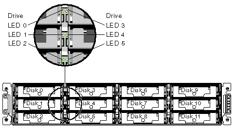

Before replacing a disk drive, perform the following steps to ensure that you have identified the correct defective disk for removal.
Caution - To prevent any possibility of data loss, it is strongly recommended that you back up the data prior to removing disk drives. |
1. Examine the back of the array, and record the cable connections.
2. Physically locate the defective disk drive.
A solid amber LED next to a drive on the front panel of the JBOD indicates a failed disk drive. For details, refer to the Sun StorEdge 3000 Family Installation, Operation, and Service Manual for your array.

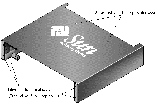

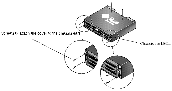

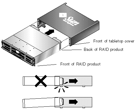

You can make a rack-ready array into a tabletop array or make a tabletop array into a rack-ready array. These procedures require attaching or removing a tabletop cover, also known as a tabletop skin, as shown in the following figure.

4. On the top of the array, remove the top two back center screws with a Phillips No. 1 screwdriver and discard these screws.
5. Slide the back of the array into the front of the tabletop cover until the front of the array is flush with the front of the tabletop cover (see FIGURE 2-6).
Note - As you slide the array into the cover, keep the back of the array tilted slightly upward to avoid bumping the edge of the array on the metal feet of the cover. |
6. Loosely attach the front of the tabletop cover to the front ears of the array with two 10-32 x 1/4-inch Phillips panhead screws on each side (see FIGURE 2-7).
7. Attach the top center back of the tabletop cover to the array with two new black flathead 4-40 x 1/4-inch screws and a Phillips No. 1 screwdriver.
8. Tighten the front screws (from Step 6) with a Phillips No. 2 screwdriver.

3. Remove the 10-32 x 1/4-inch Phillips panhead screws which attach the tabletop cover to the array, with a Phillips No. 2 screwdriver, and discard these screws.
4. On the top of the array, remove the top two back center black flathead 4-40 x 1/4-inch screws with a Phillips No. 1 screwdriver and keep these screws.
5. Pull the front of the chassis until the chassis is completely removed from the tabletop cover.
