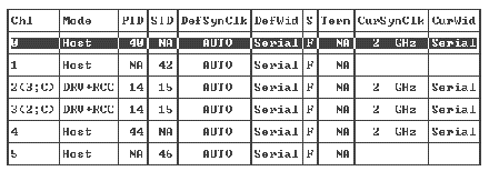

To view and configure channels choose "view and edit channelS" from the Main Menu. See Channel Status Table for a description of the Channel Status Table.
To Check and Configure Host and Drive Channels |
1. From the Main Menu, choose "view and edit channelS" to display the status of all host and drive channels for this controller.

Each controller has a separate RS-232 port as well as an Ethernet port. This architecture ensures continuous communication in case one controller fails. Since the connection is established to only one controller at a time (even when the array is in redundant mode), the CurSyncClk and CurWid settings are displayed for the primary controller. If you map one LUN to the primary controller and another LUN to a secondary controller, only the established connection to the primary controller is displayed. If a primary ID is not mapped to a channel, and a secondary ID is mapped, either ASYNC displays in the CurSyncClk field or the field is left blank.

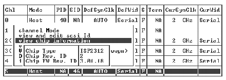

Each controller has multiple channels (I/O paths) and each channel is powered by an I/O processor. The "view chip inFormation" menu option provides information about the host or drive channel's chip type and revision level, and a firmware identifier, which might include version information.
To View Chip Information |
1. From the Main Menu, choose "view and edit channelS."
2. Select a host or drive channel.
3. Choose "view chip inFormation" to display the channel's chip information.
