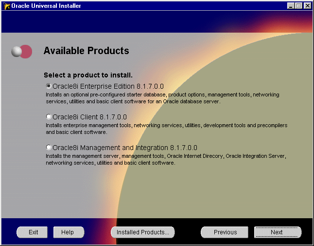

- Click Next. You will see the Available Products screen, illustrated in Figure C-3.
Figure C-3 Available Products Screen
- Click the radio buttons for the product(s) you want to install.

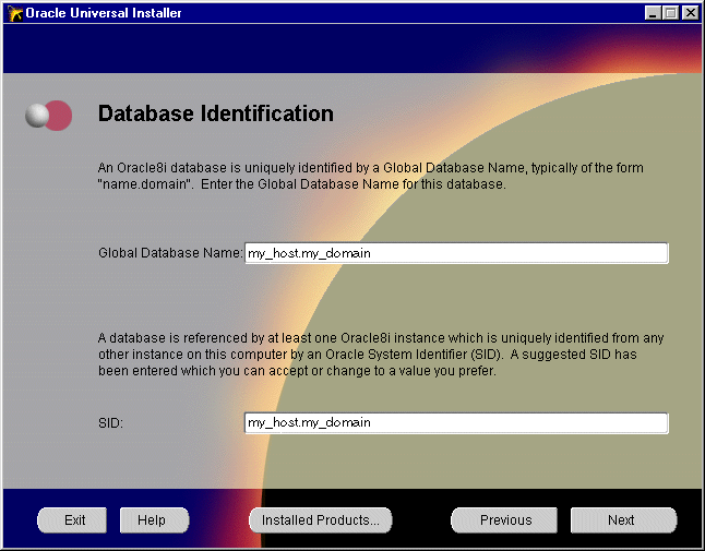

- Click Next. You will see the Database Identification screen, illustrated in Figure C-5.
Figure C-5 Database Identification Screen
- In the Global Database Name field, enter the name you want to use to identify this Oracle database.
- The SID field is automatically populated with whatever you entered in the Global Database Name field. However, if you want to use a different Oracle system identifier, enter the name you want to use.

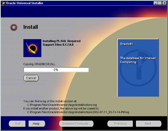

- When you are satisfied that all the settings are correct, click Install. This launches the actual installation process. The Install screen is displayed, as illustrated in Figure C-7.
Figure C-7 Install Screen
- The installation process takes considerable time to complete. If no errors occur, the installation process completes and displays the Configuration Tools screen, illustrated in Figure C-8.

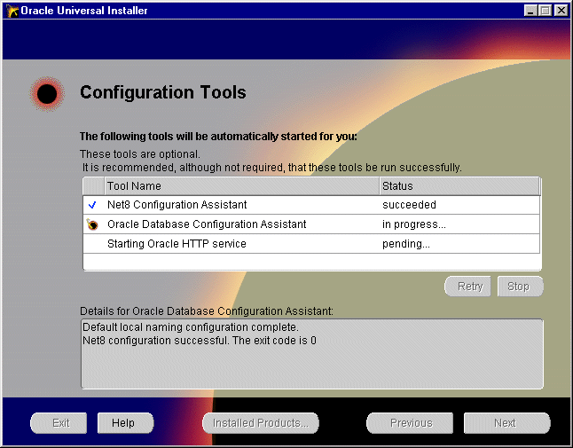

Figure C-8 Configuration Tools Screen
- If you do not want any of displayed tools to be started at the present time, click that tool and click Stop.
If a tool that you would like to be automatically started has encountered some sort of problem launching, click that tool and click Retry.

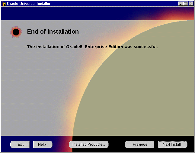

- Click Next. The End of Installation screen is displayed, as illustrated in Figure C-9.
Figure C-9 End of Installation Screen
- If you want to install other Oracle products click Next Install.
If you want to view a list of currently installed products click Installed Products.
If you want to exit the installation program click Exit.

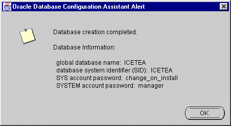

- When you click Exit the Oracle Database Configuration Assistant Alert screen is displayed, as illustrated in Figure C-10.
Figure C-10 Oracle Database Configuration Assistant Alert Screen
- Click OK.
- Return to Oracle on Solaris to complete database configuration and testing before installing ECXpert.
