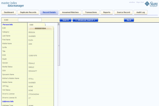

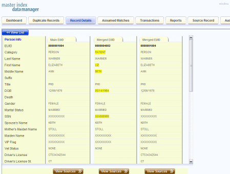

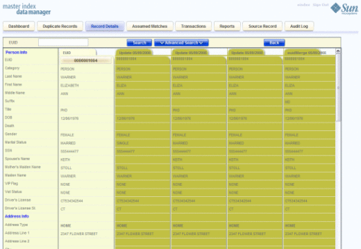

Navigating the MIDM Detail Pages

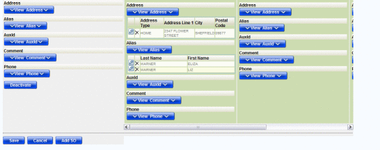

The detail pages display the SBR of the object profile on the left and you can expand the pages to view source records on the right. Child objects appear below the parent object, and you can expand and collapse the information for each type of object. If you are viewing a comparison of object profiles, you can expand the source records of one object profile at a time. The following figure illustrates a sample of the Record Details page and shows the SBR to the left of three source records. Each detail page includes scrollbar navigation within the larger browser window so you can control the display of data.
Figure 3 Sample Record Details Page
Figure shows the Record Details window where
you can view profile details.

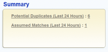

Viewing Summary Information From the Dashboard
The Dashboard provides a short summary of important transactions that have occurred in the past 24 hours. You can view how many of these transactions occurred and link to the search pages to view more information.
Figure 4 Summary Box on the Dashboard
Figure shows the Summary Box on the Dashboard.
ProcedureTo View Summary Information
  1. In the tabbed headings, click Dashboard.
    The Summary box displays the number of potential duplicate and assumed match transactions that have occurred in the past 24 hours.
  2. To view additional information about potential duplicates, click Potential Duplicates in the Summary box, and then perform a search as described in Working with Potential Duplicate Profiles on the MIDM.
  3. To view additional information about assumed match transactions, click Assumed Matches in the Summary box and then perform a search as described in Working with Assumed Matches on the MIDM.

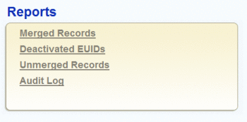

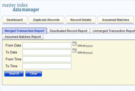

Accessing Reports and Audit Logs From the Dashboard
The Dashboard provides quick links to the search pages for different types of production reports that give you information about the status of your data.
Figure 5 Reports Box on the Dashboard
Figure shows the Reports box on the Dashboard.
ProcedureTo Access Reports and Audit Logs From the Dashboard
  2. To view a Merged Record report, click Merged Records and then perform a search as described in Running MIDM Reports.
  3. To view a Deactivated Record report, click Deactivated EUIDs and then perform a search as described in Running MIDM Reports.
  4. To view an Unmerged Record report, click Unmerged Records and then perform a search as described in Running MIDM Reports.
  5. To view an audit log, click Audit Log and then perform a search as described in Viewing the MIDM Audit Log.

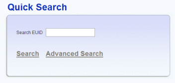

Performing a Quick Search (EUID Lookup)
To search for an object profile using only an object’s EUID, you can enter the EUID number in the Quick Search box of the Dashboard. This type of search should result in only one matching profile.
Figure 6 Quick Search
Figure shows the Quick Search box on the Dashboard.
ProcedureTo Perform Quick Search
  2. In the Quick Search section, enter the object’s EUID.
  3. Click Search to initiate the search.
    The Record Details page appears, displaying detailed information about the object whose EUID you entered.
  4. To perform a more advanced search with multiple criteria fields and options, click Advanced Search.

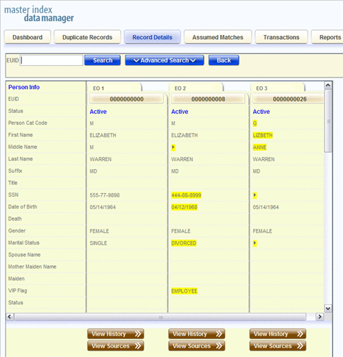

You can perform a lookup of multiple EUIDs from the Dashboard to compare object profiles in a side-by-side view on the Record Details page. To lookup multiple EUIDs, specify each EUID in the Compare EUIDs box on the Dashboard. You can enter from two to four EUIDs to compare in the search results list.
Figure 7 Compare EUIDs Box on the Dashboard
Figure shows the Compare EUIDs box on the Dashboard,
where you can enter multiple EUIDs for a search.
ProcedureTo Perform an EUID Comparison Lookup
  2. In the Compare EUIDs box, enter at least two, and up to four, EUIDs.
  3. Click Compare.
    The Record Details page appears with each matching profile displayed side-by-side.

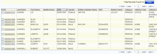

The Search Results List
The search results list appears under the search fields and displays a list of object profiles found in the database that closely match the search criteria you entered. The results list appears in a table, with the number of profiles returned for the search displayed above the table. This page displays information to help you identify the object profile, such as the EUID or address information. The search results list appears differently depending on which type of search is performed and how the lists are configured. For more information about search results, see Working with Search Results on the MIDM.

You can perform a search by EUID for multiple profiles from the Dashboard. You can enter from one to four EUIDs in the Compare EUIDs section. The resulting profiles appear in a side-by-side display on the Record Details and you can compare record information.
Figure 12 EUID Comparison Lookup
Figure shows the comparison lookup page, where
  3. click Compare.

Viewing the Results of a Search
The matching profiles that result from an object search appear in table format below the search criteria. The table displays a limited number of fields contained in the SBR of the object profile.
Figure 13 Search Results List
Figure shows a search results list.
ProcedureTo View the Results of a Search
  1. Using one of the searches described in Searching for Object Profiles on the MIDM, perform a search for the object whose profile you want to access.
    If more than one record matches the criteria, the search results list appears below the criteria.
  2. In the results list, view the information presented for each returned profile to determine which profile you want to view.
  3. To view additional address or telephone information for a profile, click the address component or telephone number you want to view.
    A popup window appears, as shown in the following figures.

  5. To navigate through the results list pages, do any of the following:
    • To view the following page of search results, click Next>.
    • To return to the previous page of results, click <Previous.
    • To view the first page of search results, click <<First.
    • To view the last page of search results, click Last>>.
  6. To select a profile to display on the Record Details page in view mode, click the EUID of that profile or select the check box next to the EUID and click Compare.
  7. To select multiple profiles to compare on the Record Details page, select the check boxes next to the EUIDs you want to compare, and then click Compare.
  8. To return to the Search Results list from the Record Details page, click Back.
  9. To perform a new search, click Clear in the search criteria section of the page.
  10. To print the results in a report, click Print.

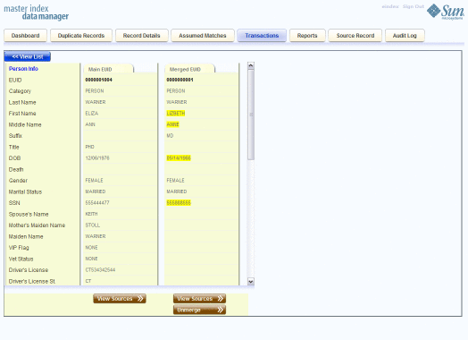

Object Profile Transaction Histories
You can view a history of all transactions performed against object profiles either by performing a search for specific records, as described in Searching for Object Profiles on the MIDM, or by performing a Transaction History search on the Transactions page, as described in Viewing Transaction Histories on the MIDM. You can trace the events that modified an object profile from the time the profile was added to the master index application to the most previous transaction, including merged and deactivated profiles.
The Transaction History page allows you to view a side-by-side comparison of one object profile before and after a transaction occurred against that profile. You can also compare an SBR against an SBR, an SBR against a source record, and a source record against a source record. From associated Transaction History pages, you can unmerge previously merged profiles.

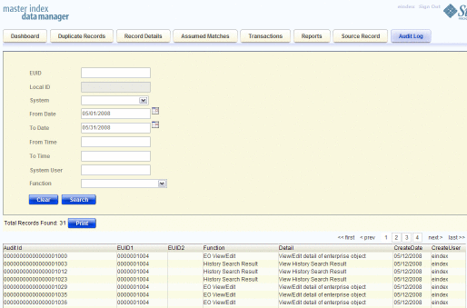

The Master Index Audit Log
The audit log allows you to track and view all instances in which information about the objects in the master index application was accessed through the MIDM. If audit logging is enabled, an audit log entry is created each time the MIDM accesses database tables that contain object information. The audit log keeps a record of each time the tables are accessed, along with the database function used to access the tables, the login ID of the user accessing the tables, the date and time the tables were accessed, and the EUIDs of the object profiles that were accessed. The audit log is enabled and disabled in the midm.xml file in the master index project.

Viewing Object Profiles on the MIDM
The Record Details page displays object profiles in a series of pages from which you can select and view profiles. You can view information associated with any of the SBR or source record components in an object profile. The SBR contains the information that is determined to be the most current and accurate information about that object from all local systems. By default, when the Record Details page first appears in view mode, only the information in the SBR is visible.
Figure 16 Record Details Page in View Mode
Figure shows the Record Details page of the MIDM in
view mode.
ProcedureTo View an Object Profile
  1. Using one of the search methods described in Searching for Object Profiles on the MIDM, display the object profile you want to view on the Record Details page.
  2. To view different types of information in the SBR for the displayed object, simply scroll through the visible data fields.
  3. To view source records belonging to the profile, scroll to the bottom of the data fields and then click View Sources.
    All source records for the profile appear in a side-by-side comparison view.
  4. From the Record Details page, perform any of the following functions. The buttons you click are all located at the bottom of the SBR.
    1. To modify object information, click Edit EUID and follow the appropriate procedure under Modifying Profile Information on the MIDM.
    2. To view a history of transactions for the displayed profile, click View History (for more information, see Viewing Transaction Histories on the MIDM).
    3. To deactivate a profile, click Deactivate (for more information, see Deactivating a Profile or Source Record).
    4. To view an image of both profiles involved in the most recent merge transaction, click View Merged Records.
      An image appears of both profiles as they were prior to the merge. This option is only available if the displayed profile is currently merged with another profile.
    5. To view a merge history tree for the profile, click View Merge Tree.
  5. When you are done viewing a profile, do any of the following. The buttons you click are located at the top of the page.
    1. To return to the search results list, click Back.
    2. To look up another profile by EUID, enter the EUID in the field in the upper left and click Search.
    3. To perform an advanced search for another profile, click Advanced Search.

The MIDM allows you to compare two or more object profiles side-by-side to check for similarities and differences. You can also compare different components of the same object profile and you can compare two or more source records from the same or different profiles.
Comparing Two or More Object Profiles
To compare two or more object profiles, you can either perform an EUID comparison lookup from the Dashboard, or you can select multiple records from a Record Details search. From the resulting comparison page, you can compare the resulting profiles and you can view the source records for the displayed profiles.
Figure 18 Record Details Page - Multiple Object Profiles
Figure shows the Records Detail page with three object
profiles displayed side-by-side.
ProcedureTo Compare Two or More Object Profiles
  1. Perform a search for the object profiles you want to compare, using one of the following methods:
    • If you know the EUIDs of the profiles you want to compare, lookup the EUIDs from the Dashboard as described in Performing an EUID Comparison Lookup .
    • If you do not know the EUIDs of the profiles to compare, perform a search on the Record Details page as described in Searching for Object Profiles on the MIDM, select the check boxes next to the EUIDs to compare, and then click Compare.
      The records appear on the Record Details page in a side-by-side comparison view.

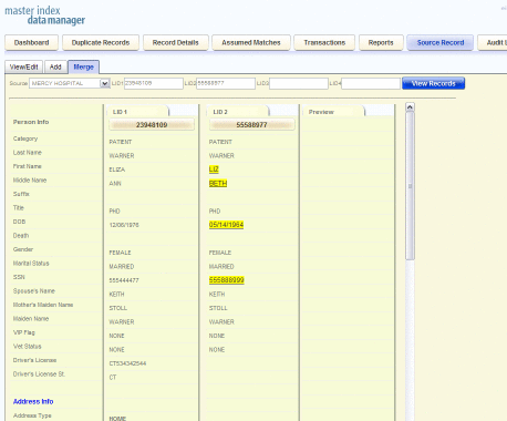

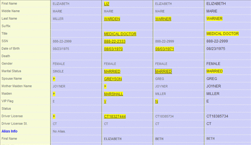

Comparing Source Records From One Source System
To compare source records directly without accessing them from an object profile, you need to know the system and local ID numbers for the records. On the Source Record page, you can only compare records that originated from the same system.
Figure 20 Source Records Comparison
Figure shows two profiles in a side-by-side comparison
with differences between the two highlighted.
ProcedureTo Compare Source Records From One Source System
  1. In the tabbed headings, click Source Record.
  2. Click the Merge sub-tab.
  3. In the Source field, select the name of the source system from which the records you want to compare originated.
  4. In the Local ID fields, enter at least one and up to four local IDs.
    Note –
    If any of the Local ID fields allows alphabetic characters, the search is case-sensitive.
  5. Click View Records.
    Any matching source records appear side-by-side in a comparison view.
  6. To view the object profile for one of the source records, click View EUID under that source record.
    Tip –
    Clicking View EUID takes you out of the Source Records page and into the Record Details page. To return to the Source Record comparison page, click Back on the Record Details page.
  7. To merge any of the displayed source records, see Merging Source Records on the MIDM.

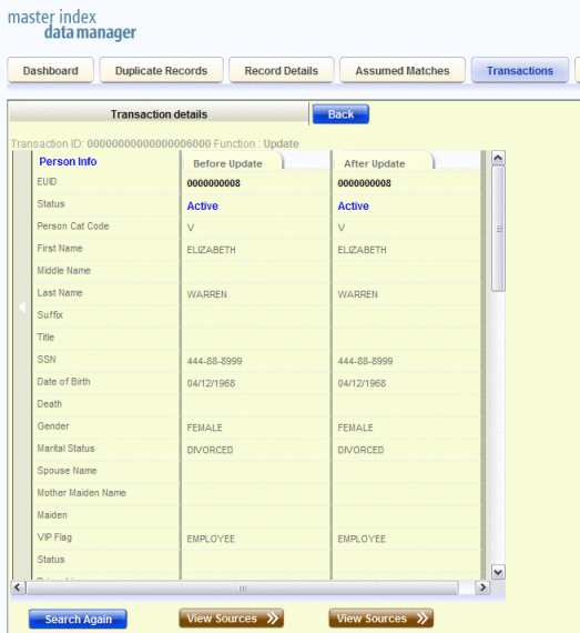

Using the Transactions function, you can view historical information for a specific object and compare the object’s profile before and after a specific transaction occurred to determine what information was modified as a result of the transaction. You can access the transaction history for a profile from the Record Details page, or you can access transaction histories for one or more profiles from the Transactions page.
When you display a transaction history from the Record Details page, all of the transactions for the displayed object profile appear in chronological order, with the earliest transaction on the left and the most recent transaction on the right. When you display a transaction history record from the Transactions page, the image of the profile as it was prior to the transaction appears on the left side of the comparison page. The image on the right reflects the object’s information after the transaction occurred.

  5. Click a transaction number of a result to view the transaction on the Transactions comparison page.
    Figure 24 Transaction History Comparison Page
    Figure shows the images of a profile before and after
a transaction occurred.
    Note –
    If you are viewing an unmerge transaction, the active record prior to being unmerged is displayed on the left. The after image of the two records that were unmerged during the transaction is displayed on the right.
  6. To view the source records for either the before or after profile, click View Sources beneath the profile image.
  7. If you are viewing a merge transaction that has not been unmerged, you can unmerge the records here. For more information, see Unmerging Object Information on the MIDM.

ProcedureTo View the Audit Log
  1. Obtain information about the instances you want to view, such as the EUID, a time frame for when they occurred, the type of function that caused the audit log entries, the user who performed the functions, and so on.
  2. In the tabbed headings, click Audit Log to open the Audit Log search page.
    Figure 27 Audit Log Search Page
    Figure shows the Audit Log search page.
  3. Enter values into any of the search fields as criteria. For more information about these fields, see About Audit Log Search Fields on the MIDM.
    Note –
    The EUID field takes precedence over all other search fields on this page. You can only enter a local ID as search criteria after you have entered the corresponding system.
  4. Click Search.
  5. On the Audit Log search results list, view the instances in which the data was accessed. For information about the fields displayed on this page, see About Audit Log Results Fields on the MIDM.
    Figure 28 Audit Log Search Results List
    Figure shows the results of an audit log search.

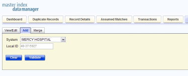

Step 2: Specify a System and Local ID
Each object profile is associated with at least one source record. Before you add data to an object profile, you must specify the object’s local ID in a specific system. This creates the source record component of the object profile.
Figure 29 Add Source Record - System and Local ID
Figure shows the first page that appears when
you create a new profile.
ProcedureTo Specify a System and Local ID
  1. Complete Step 1: Obtain Information about the Object.
  2. In the MIDM tabbed headings, select Source Record.
    The Source Record page appears.
  3. Click the Add tab on the Source Record page.
  4. In the System field, select the name of the source system from which the new record originated.
  5. In the Local ID field, enter the local ID assigned to the new record by the specified system.
    Note –
    The name of the Local ID field might have been modified for your use. See your system administrator for more information.
  6. Click Validate.
    If the record does not already exist, the page changes to display profile fields.

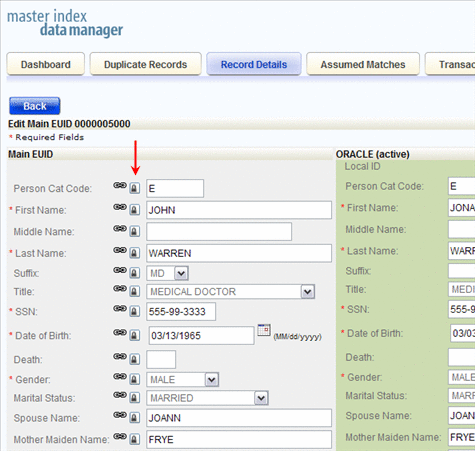

Modifying Parent Object Information in a Profile

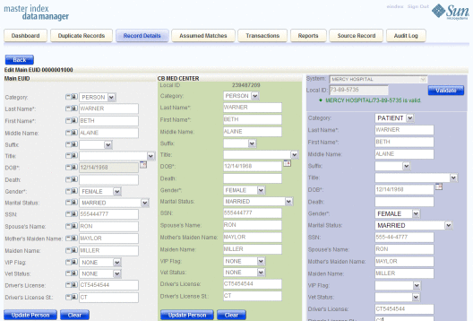

The Record Details page has an edit mode, where you can modify field values in the displayed object profile. The following figure shows the Record Details page in edit mode.
Figure 32 Record Detail Page - Parent Object
Figure shows parent object fields for editing.

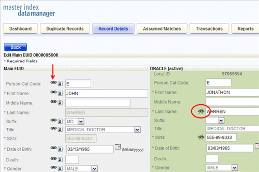

ProcedureTo Modify a Parent Object in a Profile
  1. Using one of the search methods described in Searching for Object Profiles on the MIDM, display the object profile you want to modify on the Record Details page.
  2. At the bottom of the page, click Edit EUID.
  3. To update the SBR, do the following:
    1. For each field in the parent object you want to modify, click the padlock icon to the left of the field to modify, and then modify the value of the field.
    2. Click Update parent_object under the fields you modified (where parent_object is the name of the parent object.
      Note –
      You can only modify SBR fields directly if you have permissions to do so.
  4. To update a source record, modify the parent object fields in any of the displayed system objects.
  5. When you are done modifying information, click Update parent_object (where parent_object is the name of the parent object).
  6. Click Save at the bottom of the page, and click OK on the information dialog box that appears.
    The page refreshes, and, if you modified a source record, the SBR is recalculated based on the new information.

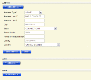

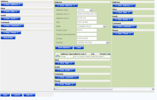

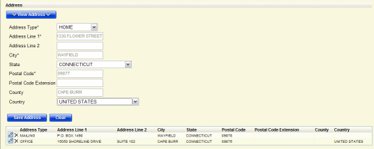

Adding a Child Object to an Object Profile
If additional information becomes available about an object, you might need to add a new child object to the object profile. For example, if additional address information becomes available, you might need to add a new address record to the affected source record. You cannot add a child object to the SBR.
Figure 33 Record Details Page - Child Objects
Figure shows child object fields for adding or
editing a child object.
ProcedureTo Add a Child Object to an Object Profile
  3. Click View child_type in the column containing the source record you want to modify.
    For example, to add an address record, select View Addresses.
  4. In the empty field, enter the new information for the child object.
  5. Beneath the record you updated, click Save child_type.
  6. Scroll to the bottom of the page and click Save.
  7. Click OK on the information dialog box that appears.
    The page refreshes and the SBR is recalculated based on the new information.
Modifying a Child Object in a Profile
If information about a child object changes, you might need to modify information for an existing child object. You cannot modify information in child object in the SBR. The following figure shows a child object on the Record Details page in edit mode.

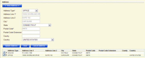

Figure 34 Record Details Page – Edit Child Object
Figure shows a child object displayed on the
ProcedureTo Modify a Child Object in a Profile
  3. In the source record you want to modify, click View child_type, where child_type is the name of the child object type you want to add. For example, to modify an address record, select View Addresses.
    Empty child object fields appear along with a list of existing child objects of the selected type.
  4. In the child object list, click the pencil icon next to the child object you want to modify.
    The field values for the selected child object are populated into the child object fields.
  5. Modify any fields for the child object.
  6. Beneath the record you updated, click Save child_type.
  7. Scroll to the bottom of the page and click Save.
  8. Click OK on the information dialog box that appears.

Adding a Child Object to a Source Record
If additional information becomes available about an object, you might need to add a new child object to a source record. For example, if additional address information becomes available, you might need to add a new address record to the affected source record.
Figure 37 Source Record Page - Add Child Object
ProcedureTo Add a Child Object to a Source Record
  1. In the MIDM tabbed headings, click Source Record.
  2. If necessary, click the View/Edit sub-tab.
  3. In the System field, select the name of the system for the source record you want to modify.
  4. In the Local ID field, enter the local ID for the record you want to modify.
  5. Click Search.
    If a matching source record is found, it appears on the Source Record page in view mode.
  6. At the bottom of the page, click Edit.
  7. Click View child_type, where child_type is the name of the type of child you want to add.
    The child object section expands to display empty fields for the object.
  8. Enter information into the empty child object fields.
  9. Click Save child_type.
  10. When you are done adding information, click Save at the bottom of the page.
  11. Click OK on the information dialog box that appears.
Modifying a Child Object in a Source Record
If information about an object changes, you might need to modify information for an existing child object. You can make those changes on the Source Record page.
Figure 38 Source Record Page – Edit Child Object
Figure shows the child object of a source record
in edit mode.
ProcedureTo Modify a Child Object in a Source Record
  5. Click Search.
    If a matching record is found, it appears on the Source Record page in view mode.
  7. Click View child_type, where child_type is the name of the type of child you want to modify.
    The child object section expands to display empty fields for the object along with a list of existing child objects.
  8. Click the pencil icon next to the child object you want to modify.
    The child object fields are populated with the values from the child object you selected.
  9. Modify any of the child object fields.
  10. Click Update child_type.
  11. When you are done modifying information, click Save.
  12. Click OK on the information dialog box that appears.

Figure 39 Source Record Page – Delete Child Object
Figure shows a child object in a source record
ready to be deleted.
ProcedureTo Delete a Child Object From a Source Record
  5. Click Search.
  7. Click View child_type, where child_type is the name of the type of child you want to delete.
    The child object section expands to display a list of existing child objects.
  8. Click the delete icon next to the child object you want to modify.
    The delete icon looks like an “X”.
  9. When you are done modifying information, click Save, and the click OK on the information dialog box that appears.
    The page refreshes, and the SBR of the object profile is recalculated based on the new information.

Locking an SBR Field
When you lock a field in an SBR, that field can only be updated through the MIDM by a user who has overwrite permissions. Locking a field in the SBR removes the survivor calculator from the update process for that field and any updates made to or by source records will not update the locked fields in the SBR. You can only lock fields in the parent object.
The following figure shows an object profile with three locked fields in the SBR (as indicated by the open padlock icons in the column beneath the red arrow).
Figure 40 Locked Fields in an SBR Indicated by Open Padlocks
Figure shows fields with locked field values
in the SBR.
ProcedureTo Lock a Field in the SBR
  1. Using one of the search methods described in Searching for Object Profiles on the MIDM, display the object profile containing the field you want to lock on the Record Details page.
  3. Scroll to the SBR field you want to lock. Only parent object fields can be locked.
  4. If necessary, change the value of the field to be locked.
  5. Click the padlock icon to the left of the field.
    Note –
    A closed padlock indicates an unlocked field that can be locked. An open padlock indicates a locked field that can be unlocked.
  6. Click OK On both dialog boxes that appear.
  7. Click Save at the bottom of the page, and then click OK on the confirmation dialog box.
    The field is now locked and cannot be edited by updates to source records until the lock is removed. The link icon is also removed since a locked field cannot be linked to a source record field.

Overriding the Survivor Calculator's SBR
Linking an SBR field to a field in a source record is one way to ensure that the value for that field is not recalculated by the survivor calculator each time the object profile is updated. If you determine that a value in a specific source system is the most accurate data and should always be used in the SBR, you can link the field values and override the survivor calculator's version of the SBR. If you unlink a linked field, the value of that field is automatically recalculated by the survivor calculator as soon as the unlink action is performed. You can only link field values from the parent object.
Linking an SBR Field to a Specific Source Record
When you link a field in an SBR to a field in one of the profile's source records, the value of the field will always equal the value of the field in the source record, even when the source record field is updated. Linking a field in the SBR to a source record removes the survivor calculator from the update process for that field. Any updates made to or by other source records in the profile will not update the linked field in the SBR. Use linking when you have very high confidence that the field value from a specific source record is likely to be the most accurate and current value. You cannot link an SBR field if it is locked for editing.
The following figure shows two linked fields in an object profile, as indicated by the link icons to the left of the fields in the source record. All other fields have the link icon in the SBR.
Figure 42 Linked Fields in an SBR
Figure shows SBR fields whose values are linked
to a source record.
ProcedureTo Link an SBR Field to a Source Record Field
  1. Using one of the search methods described in Searching for Object Profiles on the MIDM, display the object profile containing the field you want to link on the Record Details page.
  3. Scroll to the SBR field you want to link.
  4. Click the chain–link icon to the far left of the field.
    A popup window appears where you can specify the source record to link.
  5. On the popup window, select the source system code and the local ID of the source record to which you want to link the selected field.
  6. Click OK on the dialog boxes that appear.
    The link icon moves from the SBR field to the source record field, and the lock icon is removed (because a field cannot be both linked and locked). The SBR field is now linked and can only be edited by updates to the source record to which it is linked.

Adding a Source Record to an Object Profile
If an object has local IDs in addition to those already recorded in the master index application, you can add the local IDs to the object’s profile by adding a source record to the profile. To add a local ID to an object profile, you need to specify information such as the system that assigned the local ID, certain parent object information, and the local ID itself. When you add a source record to an object profile, the survivor calculator determines what changes, if any, should be made to the SBR.
You cannot add a new local ID and system pair to an object profile if that same local ID and system pair already exists in another object profile.
Figure 44 Record Details Page – Add Parent Information
Figure shows adding a source record on the Record
Details page.
ProcedureTo Add a Source Record to an Object Profile
  3. At the bottom of the page, click Add SO.
    A new column appears to the right of the existing records for you to add the new source record.
  4. Enter the system and local ID for the new source record, and then click Validate.
    If no existing record match the system and local ID you entered and the local ID is of a valid format, a message appears letting you know validation succeeded.
  5. Enter information in the parent object fields.
  6. For each child object to add, do the following:
    1. Click Add child_type in the column containing the new source record.
      For example, to add an address record, select Add Addresses.
    2. Enter the new information for the child object.
    3. Beneath the child object you updated, click Save child_type.
  7. Scroll to the bottom of the column and click Save.
  8. Click OK on the dialog box that appears.

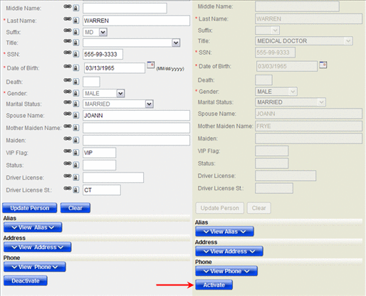

If an object profile is deactivated in error or becomes active again, you can reactivate that profile. Reactivating a profile returns the profile to its status just prior to when it was deactivated.
Figure 46 Record Details Page - Reactivate
Figure shows the View/Edit page with the Activate
button visible for an EUID.
ProcedureTo Reactivate an Object Profile
  1. Using one of the search methods described in Searching for Object Profiles on the MIDM, display the object profile you want to reactivate on the Record Details page.
  2. At the bottom of the page, click Activate.
  3. Click OK on the information dialog box that appears.
    The profile is reactivated in the database.

      The Duplicate Records results list appears with key information for each potential duplicate record displayed.
  4. In the results list, compare the displayed information to determine whether you want to view a detailed comparison of the potential duplicate profiles.
    Figure 49 Potential Duplicate Search Results List
    Figure shows the results of a Potential Duplicate search.

ProcedureTo Combine Duplicate Profiles From the Comparison Page
  1. Perform a search for potential duplicates on the Duplicate Records page, as described in Finding Potential Duplicate Profiles on the MIDM.
  2. To view a detailed comparison for a set of potential duplicate profiles, click the Preview button to the left of the profiles.
    Tip –
    The Preview button is the blue chevron button to the left of the potential duplicate profiles.
  3. On the Duplicate Records comparison page, determine which of the displayed profiles you want to keep and then click the EUID of that profile.
  4. Click the EUIDs of any other associated profile you want to merge into the profile you selected above.
    Each profile changes color to indicate it is selected.
    Figure 50 Duplicate Records – Selecting Profiles to Merge
    Figure shows two potential duplicate records selected
for a merge.
  5. Under the far right column, click Preview.
    The merge preview profile appears, allowing you to view the profile as it will appear after the merge.
    Figure 51 Duplicate Records – Merge Preview Profile
    Figure shows the merge preview profile for two potential
duplicate profiles.
  6. Compare the field values in the profiles to be merged to determine which values to populate into the kept profile. Click any values you want to keep.
    Note –
    Selecting a value to keep in the merge result profile creates a link from the SBR to the source record field that populated the field. For example, if the first name field from Record A is populated from Source Record 1, and you merge Record A into Record B and select the first name value from Record A, alink is created from the first name field in the resulting SBR to the first name field in Source Record 1. For more information on linking SBR fields to source record fields, see Overriding the Survivor Calculator's SBR.
  7. Review the merge preview profile, and then click Merge to finalize the merge.
  8. On the confirmation dialog box that appears, click OK.
    The surviving profile appears.
  9. Review the surviving object profile to determine whether any source records need to be merged or deactivated.

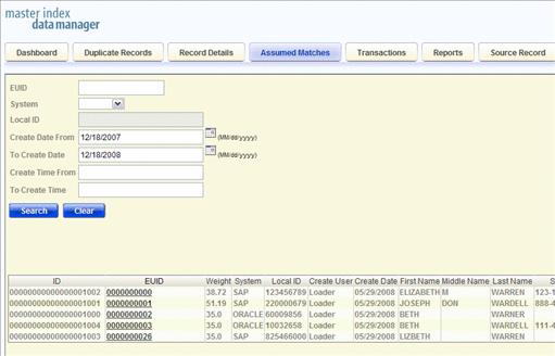

Finding Assumed Matches on the MIDM
You can find object profiles that were updated by an assumed match using the Assumed Matches function of the MIDM. When you search for assumed matches, you can select an object profile to view from a results list to determine whether the assumed match was made correctly.
ProcedureTo Find Assumed Matches
  1. Obtain information about the object profile you want to view, such as their EUID, a system in which they are registered, or the login ID of the user who added the record that caused the update.
  2. In the tabbed headings, select Assumed Matches.
    The Assumed Matches search page appears.
    Figure 56 Assumed Matches Search Page
    Figure shows the Assumed Match Search page.
  3. On the Assumed Matches search page, enter the search criteria (for more information, see About Assumed Matches Search Fields).
  4. Click Search.
    The Assumed Match Result page appears (for more information, see About Assumed Match Results Fields on the MIDM).
    Figure 57 Assumed Matches Search Results List
    Figure shows the results of an assumed match search.
  5. In the Results list, click the EUID of the assumed match profile you want to view.
    The Assumed Matches page appears with the assumed match profile displayed.
    Figure 58 Assumed Matches Comparison Page
    Figure shows two profiles involved in an assumed match
transaction.
  6. To view a transaction history of the profile, click View History at the bottom of the page.
  7. To undo the assumed match transaction, follow the instructions provided under Reversing an Assumed Match on the MIDM.
The fields located on the Assumed Matches search page allow you to specify information about the assumed match profiles you want to view.
Table 8 Assumed Matches Search Fields
In this field …
type or select ...
EUID
The enterprise-wide unique identification number of the profile you want to view.
System
The external system with which the object profile that caused the assumed match is associated.
Local ID
The local ID associated with the object profile in the specified system. The name of this field might be different for your implementation.
Create Date From
A beginning create date for the profiles you want to view. The query is performed for transactions that were created between the Create Date From (and Create Time From) and the To Create Date (and To Create Time).
To Create Date
The ending create date for the profiles you want to view.
Create Time From
The beginning create time for the profiles you want to view (using 24-hour notation). If no time is entered, the default value is 00:01 (12:01 A.M.).
To Create Time
The ending create time for the profiles you want to view (using 24-hour notation). If no time is entered, the default value is 24:00.
The fields located in the assumed match results list help you to identify an assumed match transaction to display on the Assumed Matches comparison page. The fields described in the following table always appear in the results list, but the list can be configured to include additional fields.
Table 9 Assumed Match Results Fields
This field …
displays this information …
ID
The assumed match ID of the transaction that caused the assumed match.
EUID
The enterprise-wide unique identification number of the object profile that was updated by the assumed match.
Weight
The matching probability weight between the updated profile and the record that caused the assumed match.
System
The system with which the record that caused the assumed match is associated.
Local ID
The local ID in the above system for the record that caused the assumed match. The name of this field might be different for your implementation.
Create User
The login ID of the user who added the profile that created the assumed match.
Create Date
The date and time the transaction that caused the assumed match occurred.

ProcedureTo Merge Object Profiles
  1. Perform a search for the object profiles you want to merge using any of the search procedures described in Searching for Object Profiles on the MIDM.
  2. In the results list, select the check boxes to the left of the profiles you want to merge.
    You can select from two to four profiles.
  3. Click Compare.
    The Comparison page appears.
    Figure 60 Comparison Page - Merging Object Profiles
    Figure shows the Record Details comparison page.
  4. Determine which of the displayed profiles you want to keep, and then click the EUID of that profile.
  5. Determine which of the displayed profiles you want to merge into the profile you just selected, and then click their EUIDs.
  6. Click Preview.
    The merge preview profile appears so you can review the results of the merge before finalizing it.
    Figure 61 Comparison Page - Merge Preview
    Figure shows the merge preview record.
    Caution – Caution –
    If you merge more than two profiles together, you can only unmerge the last two profiles that are merged (as determined by the master index application). Before proceeding, make sure that the profiles should be merged.
  7. Compare the highlighted field values to determine which to keep in the final profile. Select each value you want to keep in the merge preview profile.
    Note –
    Selecting a value to keep in the merge result profile creates a link from the SBR to the source record field that populated the field. For example, if the first name field from Record A is populated from Source Record 1, and you merge Record A into Record B and select the first name value from Record A, a link is created from the first name field in the resulting SBR to the first name field in Source Record 1. For more information on linking SBR fields to source record fields, see Overriding the Survivor Calculator's SBR.
  8. Click Merge.
  9. Click OK on the confirmation dialog box that appears.
  10. Review the surviving profile of the merge to be sure no source records need to be deactivated or merged.

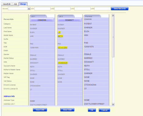

You can merge source records from one object profile into a source record from another object profile or you can merge source records within one profile, as long as both source records originated from the same system. You can also specify which, if any, information to save from the non-surviving source record. When you merge source records, the non-surviving source record is transferred into the object profile of the surviving source record and is given a status of merged. The SBRs of the surviving profiles are automatically recalculated.
ProcedureTo Merge Source Records
  1. In the tabbed headings, select Source Record.
  3. In the Source Record search fields select the source system for the records, enter two local IDs for the source records you want to merge, and then click View Records.
    The source record comparison page appears.
    Figure 62 Source Record Page– Merging Source Records
    Figure shows the Source Record Comparison page.
  4. Determine which source records you want to merge, and click their local IDs.
    Tip –
    To learn more about the source records by examining the profiles to which they belong, click View EUID under the record you want to view. Once you are done viewing the profile, click Back to return to the Source Record page.
  5. Click Keep LID#, where # is the heading number of the source record you want to retain after the merge.
    The merge preview record appears.
    Figure 63 Source Record Page – Merge Preview Record
    Figure shows two source records selected for
a merge along with their merge preview record.
  6. Compare the highlighted fields in the source records to determine which value you want to keep. Click a highlighted value to add it to the merge preview record.
  7. At the bottom of the page, click OK.
    After you merge two source records, the surviving source record is updated, and the non-surviving source records are transferred to the “merge to” profile and is marked as merged. The SBRs for the object profiles involved in the merge are recalculated. If a “merge from” profile no longer has any source records, it is deactivated.

ProcedureTo Unmerge Object Profiles
  1. In the MIDM tabbed headings, click Transactions.
  2. Perform a search for the object profiles to unmerge.
    For information about the search fields on this page, see About Transaction History Search Fields on the MIDM.
  3. Select a transaction to unmerge from the search results list.
    Note –
    This must be an EUID merge transaction.
    Figure 64 Unmerge Page
    Figure shows the Unmerge page.
  4. Review the two displayed profiles to verify they should be unmerged.
    Caution – Caution –
    If you are unmerging profiles that were merged in a transaction that included three or four profiles, only the last two profiles merged will be unmerged. The remaining profiles cannot be unmerged.
  5. At the bottom of the page, click Preview Unmerge.
    A preview of the unmerged record appears.
  6. Verify the preview, and then click Unmerge.
  7. On the confirmation dialog that appears, click OK.
Reports are run from the Reports page of the MIDM. You need the appropriate security permissions to run the production and activity reports from the MIDM. Production and activity reports require that a time period be defined in the search criteria, and certain reports take additional search criteria.
ProcedureTo Run Reports From the MIDM
  1. In the MIDM tabbed headings, click the Reports tab.
    The Reports Search page appears.
    Figure 66 Reports Search Fields
    Figure shows the Reports Search fields.

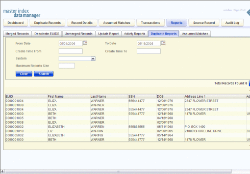

  2. On the Reports Search page, select the type of report to run from Reports sub-tabs.
  3. Enter the search criteria (for more information, see About Report Search Fields on the MIDM).
  4. Click Search.
    The selected report appears, as shown in the following figure .
    Figure 67 Potential Duplicate Report Sample
    Figure shows a sample Potential Duplicates Report.
  5. To sort the report by a single column, click that column name.
  6. To change whether the column is sorted by ascending or descending order, click again on the column.
  7. To print the report, click Print in the upper right portion of the window.
The report search fields let you specify a date range for each report. For Potential Duplicate reports, you can also specify the status of the potential duplicates returned by the search.
Table 10 Report Search Fields
In this field ...
type or select ...
From Date
The start date for the report. The report will retrieve transactions that occurred beginning on this date through the date specified in the To Date field.
From Time
The start time for the report, in the format HHmmss.
To Date
The end date for the report.
To Time
The end time for the report, in the format HHmmss.
Report Maximum Size
For Potential Duplicate and Assumed Match reports only, the number of records to display for the report. This allows you to limit the size of the report, which can grow quite large in some cases.
System
For Potential Duplicate reports only, the source system of the potential duplicate profiles to retrieve. You can specify all systems by leaving this field blank. This field is not visible for any other type of report.
