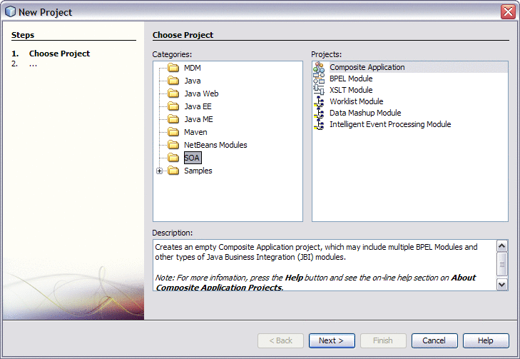

Right-click in the NetBeans Projects window, and then select New Project.
The New Project Wizard appears.
Under Categories, select SOA; under Projects, select Composite Application.
Click Next.
The Name and Location window appears.
Enter a unique name for the project. You can also modify the location of the project files.
Click Finish.

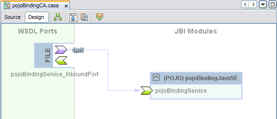

The new project appears in the projects list and the Composite Application appears in the CASA Editor.
Drag the POJO Service Engine project to the JBI Module section of the CASA Editor.
Click Build.
The WSDL port and JBI Module both appear in the CASA Editor with the endpoints connected.
Save the changes to the Composite Application.
