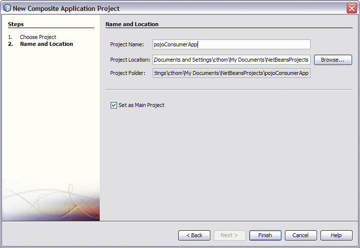

Right-click in the NetBeans Projects window, and then select New Project.
The New Project Wizard appears.
Under Categories, select SOA; under Projects, select Composite Application.
Click Next.
The Name and Location window appears.
Enter a unique name for the project. You can also modify the location of the project files.
Click Finish.

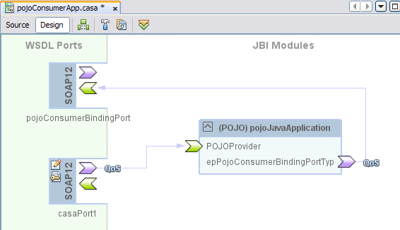

Drag the POJO Service Engine project to the JBI Module section of the CASA Editor.
Click Build.
If you configured the POJO consumer from an existing WSDL document, the WSDL port for the consumer appears and is connected to the POJO application.
If you added the consumer to a provider that was created with binding, the WSDL port for the provider also appears and is connected to the POJO application.
If you did not configure the consumer from an existing WSDL document, drag the appropriate WSDL binding from the Palette to the WSDL Ports section of the CASA Editor and connect it to the consumer endpoint as shown above.
If the provider was not created with binding, drag the appropriate WSDL binding from the Palette to the WSDL Ports section of the CASA Editor and connect it to the provider endpoint as shown above.
Click Next.
Click Finish.
Click Build.
The WSDL port for the consumer appears and is connected to the POJO application.
Save the changes to the Composite Application.
