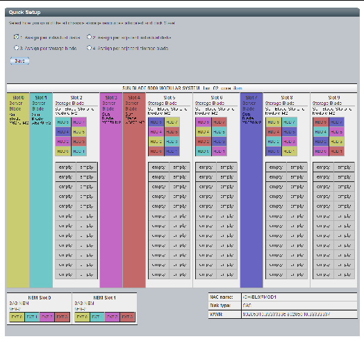

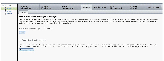

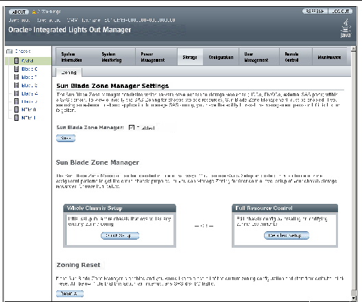

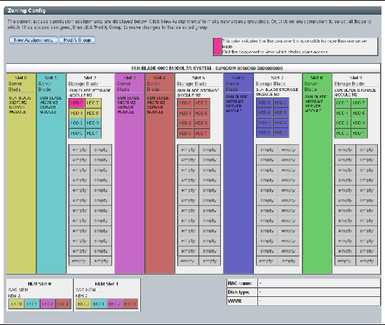

The Sun Blade Zone Manager is accessible through the CMM ILOM Storage tab. It provides two options for setting up the storage configuration:

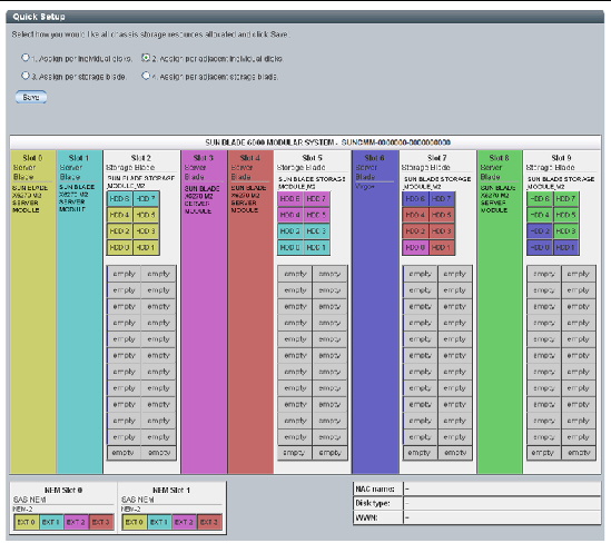

The following example shows one of the configurations available through Quick Setup.
Note - NEM0 and NEM1 targets appear in the Zone Manager when these NEMs are installed; however, external SAS connections in the Sun Blade Zone Manager are not supported at this time. |
See Creating the Chassis Storage Access Configuration Using Quick Setup for more information on Quick Setup.

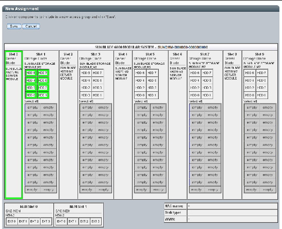

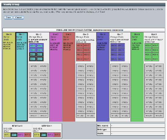

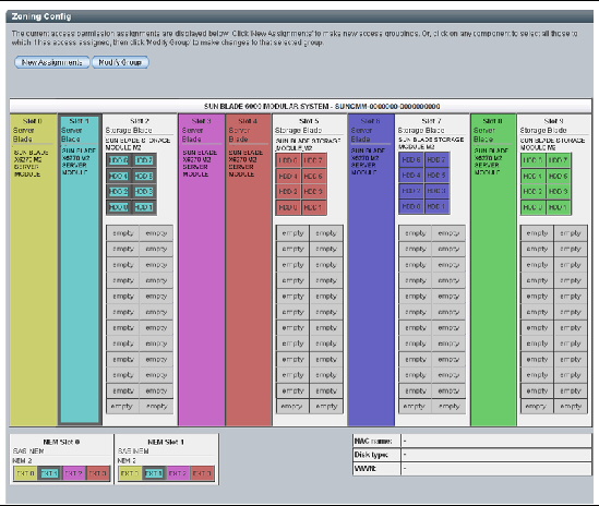

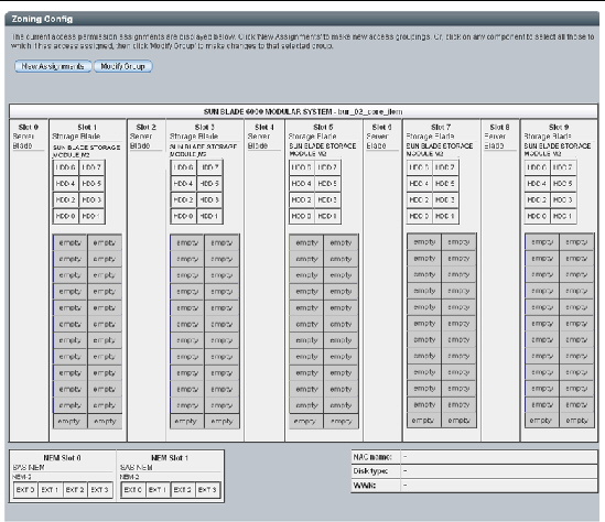

Detailed Setup enables you to make changes to the zoning configuration that you set up in Quick Setup or to make individual assignments of storage devices to server blades. The following example shows drives being selected for removal from the server blade assignment.
Drives HDD4-HDD7 are selected and highlighted in blue. When the configuration is saved, these storage devices will no longer be associated with the server blade in Slot 1.
For more information on changing a zoning configuration using Detailed Setup, see View and Modify the Chassis Storage Configuration Using the Web Interface.

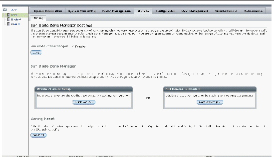

Follow these steps to access and enable the Zone Manager using the web interface:
1. Open a web browser and log in to the CMM by entering the following URL:
Where chassis_sp_ipaddress is the IP address of your chassis service processor.
2. Log in as the root user account.

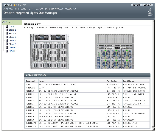

The CMM ILOM main page is displayed.
Note - In the left pane, installed server blades are listed, but not installed storage modules. This is because the CMM ILOM controls storage module Integrated Lights Out Management functions. |

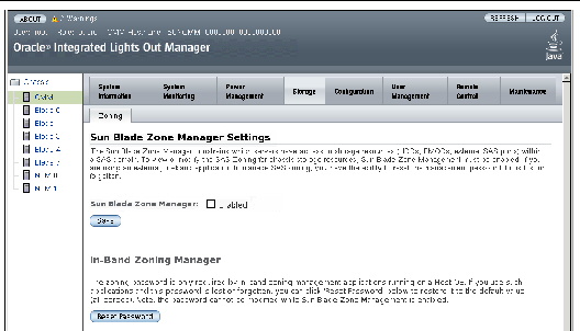

3. Click on CMM in the left Chassis navigation pane and then click the Storage tab.
The Zone Manager Settings sub-page is displayed.
4. Enable CMM zoning by clicking the Enable check box, and then clicking the Save button.
This enables you to create, view, and manage zoning settings through the CMM.

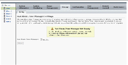

You might get the following message if the CMM ILOM services are still initializing:
If you get this message, wait an additional five minutes and then try again. You need to close and reopen, or refresh the page.

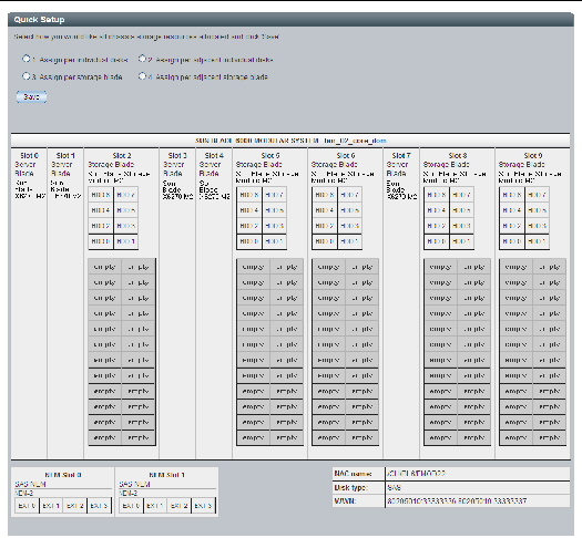

Quick Setup is a wizard for automating the process of creating an initial chassis storage access configuration for SAS-2 compliant CPU blades. Quick Setup is only available through the ILOM web interface. There is no Quick Setup equivalent for the CLI.
This section covers the following topics:
The Quick Setup option through the ILOM web interface enables you to choose from four different configuration options to zone the blades and storage devices in the chassis.

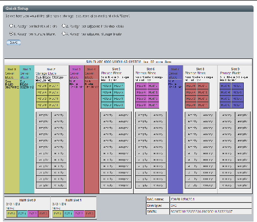

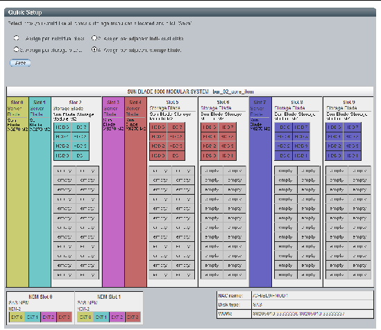

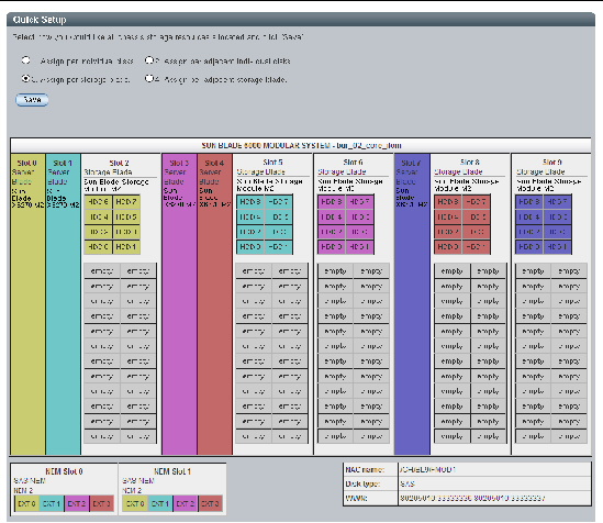

There are four options available for Quick Setup described in the following topics:
This option uses a round-robin algorithm to assign disks to hosts. Ownership of disks is spread evenly across available storage modules.
This option is best for fault tolerance where the failure or removal of a single storage module will not bring down an array.
This option equally divides the number of storage devices among the server blades. All servers are assigned as close to the same number of disks as possible.
Instead of assigning the storage in a round-robin fashion among all available storage blades, the storage is assigned from storage blades that are adjacent to the server blades. If there are no storage blades adjacent to the server blade, then the nearest possible storage blade is used.
This is a good option to use if you have more server blades than storage blades, and want to have an equal number of storage devices assigned to each storage blade.
This option looks for servers (starting at Slot 0) and assigns the closest available storage module. If there are seven servers and three storage modules, only the first three servers will be assigned a storage module.
This option is best to use when there are an equal number of storage blades and modules or more storage blades than modules. Otherwise, some server blades will not be assigned to any storage device.
This option looks for servers with storage modules in adjacent slots and one per server. If the server does not have a storage module in an adjacent slot, it is not assigned any storage.
This option works best when there are an equal number of storage blades and server blades, and each server blade has a unique storage blade installed adjacent to it.
Before You Begin: Ensure that your chassis configuration meets the requirements in Supported Hardware and Firmware Configurations.
1. Access the Sun Blade Zone Manager. See Accessing the Sun Blade Zone Manager.

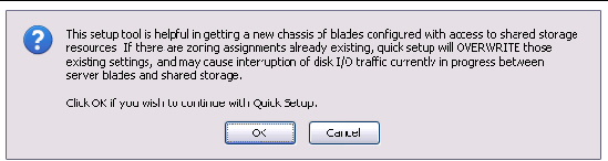

2. In the Sun Blade Zone Manager section, click the Quick Setup button.

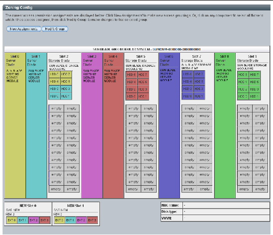

3. Click OK if you are willing to overwrite any existing zoning.
The Quick Setup screen appears.
Note that any HDD slots that do not have a storage device installed are labeled “empty.” These slots are not included in the Quick Setup configuration.

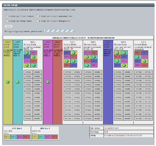

4. Choose one of the Quick Setup options.
See Quick Setup Options for explanation of each option.
After you make the selection, the screen shows the color-coded zoning assignments between the CPU blades and storage devices (HDDs). Although the Sun Blade Zone Manager assigns the NEM0 and NEM1 External SAS connections, these connections are not officially supported.
Note - Until you click the Save button, the configuration is not saved. |
5. Click the Save button to save the configuration.
See Saving the Chassis Storage Access Configuration for more information on what happens when you save the configuration.

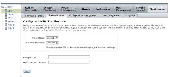

See Backing Up the Storage Access Configuration.

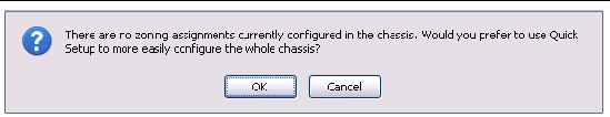

The following message appears if you do not have a chassis storage configuration set up.
Clicking Cancel will open the Detailed Setup page.
Clicking OK will open the Quick Setup page. See Creating the Chassis Storage Access Configuration Using Quick Setup for more information on Quick Setup.
4. Click the New Assignments button.

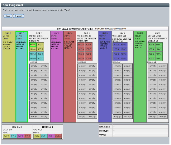

5. Click on a server blade and then click on the HDDs to be assigned to the server blade. Alternatively, select more than one server blade for the assignment.
Note that any HDD slots that do not have a storage device installed are labeled “empty.” These slots cannot be assigned to a server blade.

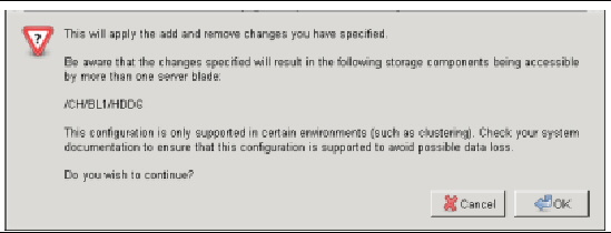

Caution - If you assign an HDD to more than one server blade, ensure that the server blade is enabled for multipathing. For more information see Assign Multiple Server Blades to a Storage Device Using the Web Interface. |
Although the Sun Blade Zone Manager can assign them, NEM0 and NEM1 External SAS connections are not supported at this time.
6. Click Save to save the configuration.

You can use the Detailed Setup through the web interface or the CLI to view or modify the current chassis storage access configuration.
Use one of the procedures in the following table to view or modify the current storage configuration.

2. In the Sun Blade Zone Manager section, click the Detailed Setup button.
The current chassis zoning configuration is displayed, as shown in the following example.
Note - Any HDD slots that do not have a storage device installed are labeled “empty.” These slots cannot be assigned to a server blade. |
3. To modify a blade/storage group, select a blade that is part of the group.
The storage that is assigned to the group will be highlighted.
4. Click the Modify Group button.
The group that you selected is still highlighted.
5. To remove a storage device that is in the group, click on it.
The following illustration shows HDD 4-7 selected to be unassigned from the processor blade in Slot 1.
6. Click Save to remove the modules from the group.

8. To make a new storage group assignment, click the New Assignments button.
9. Click on the server blade and storage devices that you want to include in the group.
In the following example, the selected storage group is highlighted in green.
HDD 4-7 are now assigned to Slot 0.
In the following example, HDD6 in storage module Slot 2 is assigned only to the server blade in Slot 0.

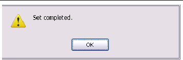

4. To assign HDD6 to both the server blade in Slot 0 and the server blade in Slot 1, click Slot 1 and click HDD6 in Slot 2.
The following message appears.
The following example shows the HDD6 in Slot 2 colored pink to indicate that it is shared by more than one server blade.

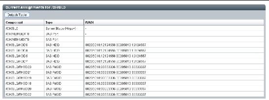

3. Select one of the server blade slots.
In this example, Slot 0 is selected.

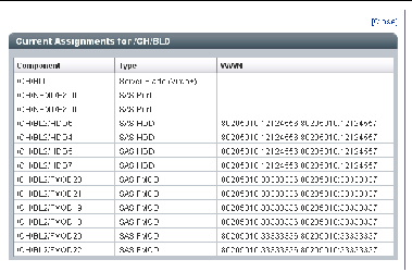

4. Scroll down to the Current Assignments table.
All of the storage device assignments for the selected server blade are shown in table format.
5. To detach the table from the rest of the screen, click Detach Table.

1. After saving a configuration in the Quick Setup or Detailed Setup screen, Click the Maintenance tab for the CMM.
The CMM maintenance sub-tabs are displayed.
2. Click the Backup/Restore tab.
The Configuration Backup/Restore page is displayed.
3. Select Backup from the Operation drop-down list.
4. Fill out the information on the page to create your backup file.
For complete instructions on using ILOM Backup/Restore, refer to the Oracle Integrated Lights Out Manager (ILOM) 3.0 Web Interface Procedures Guide.
2. Navigate to Storage --> Zoning.
If Zoning is enabled, a Reset All button is available on the Zone Manager Settings page.
3. Click the Reset All button to reset the current zoning assignments.

The zoning password is only required by in-band zoning management applications running on a Host OS.
If you use such applications and this password is lost or forgotten, restore the password to the default value (all-zeroes).
Note - The Sun Blade Zone Manager must be disabled to reset this password. |
The following procedures are included in this configuration:
If Zoning is disabled, a Reset Password button is available on the Zoning page.
3. Click the Reset Password button to reset the password to the default (all zeros).
