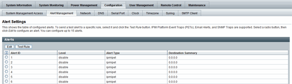

Create or Edit Alert Rules |
Follow these steps to configure alert rules:
1. Log in to the ILOM SP web interface or the CMM ILOM web interface.
2. Select Configuration --> Alert Management.
The Alert Settings page appears.
3. In the Alert Settings page, do the following:
a. Select the radio button for alert rule you want to create or edit.
b. In the Actions drop-down list box, select Edit.
A dialog appears displaying the property values associated with the alert rule.
c. In the properties dialog box, specify values for an alert type, alert level, and alert destination.
If the alert type you specify is an SNMP Trap, then you can optionally define a community name or user name value for authenticating the receipt of the alert message.
For more information about the property values you can specify for an alert rule, see “About Alert Management“ in the Oracle Integrated Lights Out Manager (ILOM) 3.0 Concepts Guide.
d. Click Save to apply the values specified and to close the properties dialog.

Generate Test Alerts |
Follow these steps to generate test alerts:
3. In the Alert Settings page, click the Send Test Alert button.
ILOM generates test alerts to each of the alert rule configurations enabled on the Alert Settings page.
Send Test Email Alert to Specific Alert Destination |
Follow these steps to send a test email alert:
3. In the Alert Settings page, perform the following steps to send a test email alert:
a. Select the radio button of the alert rule.
b. Click the Test Rule button to send a text email alert to the alert rule destination.
