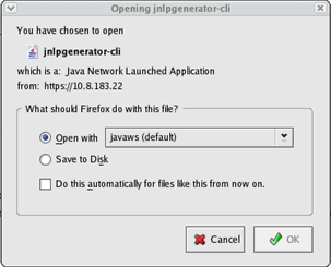

Follow these steps to specify the 32-bit JDK when starting the service for the Storage Redirection CLI using the Mozilla Firefox web browser.
1. Log in to the ILOM SP web interface.
2. Click Remote Control --> Redirection--> Launch Service.
A dialog appears indicating the file type chosen to start the service.
3. In the Opening jnlpgenerator-cli file dialog, do the following:
a. Specify one of the following options for accessing the 32-bit JDK file.
If you select this option, you will not need to subsequently sign in to the ILOM web interface to start the service. You will be able to start the service directly from a command window or terminal.
If you select this option, the jnlp file is not saved on your local system and you will need to subsequently sign in to the ILOM web interface to start the service prior to launching the Storage Redirection CLI.
b. (Optional) Select the check box for Do this automatically for files like this from now on then click OK.

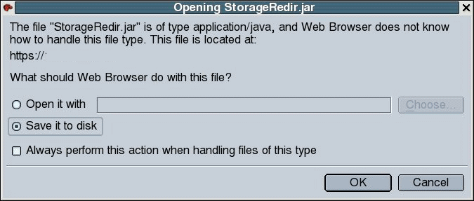

1. In the ILOM SP web interface, select Remote Control --> Redirection.
The Launch Redirection page appears.
The Opening StorageRedir.jar dialog appears.
3. In the Opening StorageRedir.jar dialog, click Save it to Disk, then click OK.
4. In the Save As dialog, save the StorageRedir.jar file to a location on your local system.

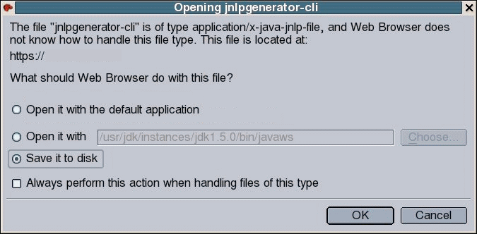

The Opening Jnlpgenerator-cli dialog appears.
3. In the Opening Jnlpgenerator-cli dialog, select Save it to disk, then click OK.
4. In the Save As dialog, specify the location where you want to save the jnlpgenerator-cli file.
5. Open the jnlpgenerator-cli file using a text editor and modify the port number referenced in this file.
<application-desc> <argument>cli</argument> <argument>2121</argument> </application-desc>
In the <application-desc> you can change the second argument to any port number that you want to use.
6. Save the changes you made and close the jnlpgenerator-cli file.
