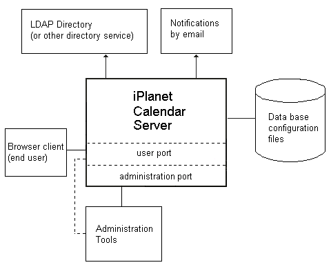

Architectural Overview
The following sections provide a general overview of the iPlanet Calendar Server product architecture which consists of the following subsystem components:
Figure 1 illustrates iPlanet Calendar Server general architecture:
Figure 1    iPlanet Calendar Server Architectural Overview

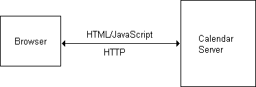

HTTP Protocol
iPlanet Calendar Server provides a default web calendar client (Calendar Express) and a general purpose HTTP server to support HTTP clients that request calendar data. Figure 2 illustrates, at the highest level, how Calendar Server operates.
Figure 2    HTTP as Primary Transport
Calendar Server uses HTTP as its primary client. It receives commands encoded in HTML and sends replies as HTML and JavaScript. The data returned from requests is not formatted for display. The embedded JavaScript generates HTML which it sends to a visible frame accessed by a web browser. The user experience is the same as if the HTML was loaded from a server. The advantage is that for many operations, JavaScript can handle everything locally and does not need to contact the server. This provides a faster screen update for the user while lightening the load on the Calendar Server.

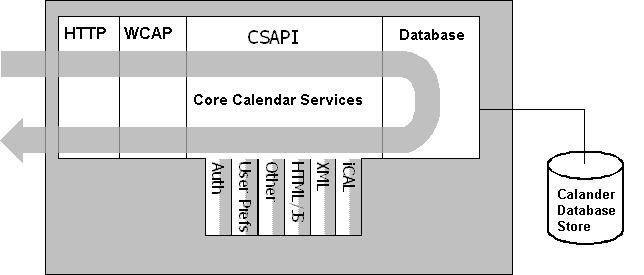

Web Calendar Access Protocol (WCAP)
The Web Calendar Access Protocol (WCAP) is a simple calendar protocol for storing, retrieving, and administering calendars. WCAP interprets HTTP requests and sends them to the core calendar services for execution. WCAP then receives commands from the core services, then encodes them into HTML format and returns them to the browser client.
Core Calendar Services
Commands enter through the HTTP protocol subsystem as WCAP. The core services make data requests to the calendar database where information is stored or retrieved and then returned in HTML format. The core system then translates:
Calendar Server Application Program Interface (CSAPI)
The Calendar Server Application Program Interface (CSAPI) enables third party application developers to add functionality to Calendar Server or change how it performs certain operations. CSAPI provides supports in four major functional areas:
For example, the default mechanisms used by Calendar Server for user authentication and storing user preferences relies on LDAP, but an ISP may have an existing infrastructure for authenticating users and saving user information that is not based on LDAP. An ISP can use CSAPI to override these default mechanisms and utilize their existing authentication and user directory services.
Supported Format Encoding
Calendar Server supports the following format encoding (all embedded within HTML):
Other formats can be added by third parties by developing a translator DLL or shared library using the Calendar Server Application Program Interface (CSAPI), an API for extending the Calendar Server.
Figure 3 is a detailed diagram of the iPlanet Calendar Server components and data flow design.
Figure 3
Subsystems and Data Flow
