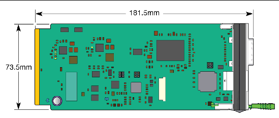

This section includes the mechanical specifications for dimensions and weight. The AMC.2-CU meets the PICMG 3.0 AdvancedTCA Specification R2.0 ECN002 and AMC.0 R2.0 for all mechanical parameters.
The AMC.2-CU conforms to the PICMG AMC.0 single-width, full-height AMC form factor for all mechanical parameters. Mechanical dimensions are shown in the illustration and are outlined in the following table.
FIGURE A-1 AMC.2-CU PCB Dimensions
