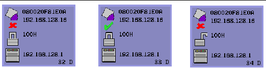

The following icons are displayed when there might be a security breach.
Definition: The client is refusing to connect to a server because it is unable to verify the validity of the Sun Ray server.
This error can occur only if an unknown Sun Ray server intercepts the messages and tries to emulate a valid Sun Ray server. This is a session security breach.
Definition: The server is refusing to grant a session to the client because the client is unable to fulfill the server's security requirements.
1. Check the client's firmware version.
This error may occur with firmware versions earlier than 2.0 if the server is configured for hard security mode.
As an alternative, confirm whether your site requires hard security mode. If not, the session can be enabled with soft security mode.
When a site policy disallows pseudo sessions, DTUs configured as token readers display the Card Reader icon instead of the Login Dialog box card.
Definition: The Card Read Error OSD icon appears whenever the firmware is unable to read the card due to one of the following causes:
Definition: If the current authentication policy allows access only by card, this OSD icon appears and prompts the user to insert a card.
Definition: The Access Denied OSD icon appears when the current authentication policy denies access to the presented token. Specifically, this icon is displayed if a disabled card has been inserted into a DTU.
