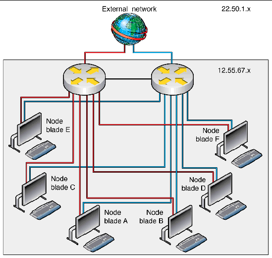

The following shows an example VRRP network configured with VRRP tracking.
FIGURE 3 Layer 3 Network Configured with VRRP
In this example, the two switch blades are redundant gateways between the node blades and the external network. The node blades are in the 12.55.67.x subnet, whereas the external network is in the 22.50.1.x subnet. An instance of VRRP is configured so that if either switch blade fails, the node can still reach the external network. VRRP tracks are added to provide more robust failover conditions.
Layer 3 VRRP Configuration
The following code example shows how to configure the example network shown in FIGURE 3.
CODE EXAMPLE 2 Configuring a Layer 3 Network With VRRP
vlan database
vlan 101
vlan routing 101
exit
configure
ip routing
ip vrrp
!interswitch link needs to be in both VLANs
interface 0/2
vlan participation exclude 1
vlan participation include 101
vlan tagging 101
exit
!node blade A is in 101
interface 0/3
vlan pvid 101
exit
!node blade B is in 101
interface 0/4
vlan pvid 101
exit
!node blade C is in 101
interface 0/5
vlan pvid 101
exit
!node blade D is in 101
interface 0/6
vlan pvid 101
exit
!node blade E is in 101
interface 0/7
vlan pvid 101
exit
!node blade F is in 101
interface 0/8
vlan pvid 101
exit
!external network
interface 0/20
ip address 22.50.1.5 255.255.255.0
exit
interface 4/1
!the other switch is set to 12.55.67.19
ip address 12.55.67.18 255.255.255.0
ip vrrp 102
ip vrrp 102 ip 12.55.67.20
!the other switch is set to 253
ip vrrp 102 priority 250
ip vrrp 102 mode
exit
!track remote server
track 1 ip route 22.50.1.15/24 reachability
!track local link state If any link goes down, failover
track 2 interface 0/3 line-protocol
track 3 interface 0/4 line-protocol
track 4 interface 0/5 line-protocol
track 5 interface 0/6 line-protocol
track 6 interface 0/7 line-protocol
track 7 interface 0/8 line-protocol
track 8 interface 0/20 line-protocol
!track local route
track 9 interface 4/1 ip routing
!Assign values to each track and assign the tracks to the vrrp instance
vrrp 102 track 1 decrement 40
vrrp 102 track 2 decrement 40
vrrp 102 track 3 decrement 40
vrrp 102 track 5 decrement 40
vrrp 102 track 6 decrement 40
vrrp 102 track 7 decrement 40
vrrp 102 track 8 decrement 40
vrrp 102 track 9 decrement 40
exit
