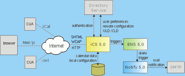

Figure 1-1 shows a minimal iPlanet Calendar Server (iCS) 5.0 system. It consists of a single iPlanet Calendar Server instance, a directory service, and support for event notifications.
Figure 1-1 Minimal
iPlanet Calendar Server System
Table 1-1 is the key to the abbreviations in Figure 1-1.

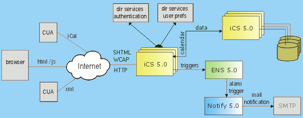

iPlanet Calendar Server is scalable both vertically and horizontally. On a single machine it can run in multiple processors, or it can be split up to run on multiple machines. Figure 1-2 depicts three iPlanet Calendar Server HTTP "front end" services, using three other iPlanet Calendar Server "database" services. All six of these instances can run on separate machines. The abbreviation "dwp" in this figure stands for Database Wire Protocol. For further information on this new protocol and the various configuration possibilities using horizontal scalability, see Horizontal Scalability.
Figure 1-2 Scalable System

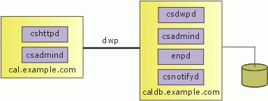

Network Front End, Database Back End
In this configuration, illustrated in Figure 1-4, browsers and other clients connect to the calendar server at the HTTP Service front-end, labeled cal.example.com in this example. All requests for calendar data are routed to the Database Service, labeled caldb.example.com in this example. Notice that the front end requires only cshttpd and csadmind since it is not doing any database processing. The back end, conversely, does not need cshttpd, but does require csdwpd, enpd, and csnotifyd.
Figure 1-4    Network Front End, Database Back End

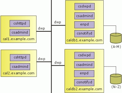

Multiple Front Ends, Multiple Back Ends
In this configuration, illustrated in Figure 1-5, clients are routed to one of the front end HTTP Services by some external mechanism that you provide. Please note that the session ID returned at login is valid only on the host where the login occurred. All requests for this session ID must be routed to the same host or the user will be forced to login again. In this example, the database has also been split, with calendars A-M on the caldb1.example.com server, and calendars N-Z on the caldb2.example.com server. A CSAPI plug-in handles mapping between calendar IDs and the name of the server on which it can be found. The default CSAPI implementation provided in iPlanet Calendar Server 5.0 uses an algorithm to associate a calendar ID with a server name.
Figure 1-5    Multiple Front Ends, Multiple Back Ends

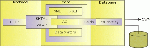

Figure 1-6 represents the logical flow through these subsystems. A section follows on each of the subsystems.
Figure 1-6    Server Architecture
SHTML and WCAP
SHTML and WCAP are based on HTTP. Requests enter through the HTTP protocol layer. This is a minimal HTTP server implementation, streamlined to support calendar requests. Clients use either SHTML or WCAP to submit requests. WCAP is an open protocol that can perform all server commands (except for certain administrative commands). It can be used by clients that need raw, unformatted calendar information. It can also be used to obtain a JavaScript based user interface. This user interface was the only one available in iPlanet Calendar Server 2.x, but in version 5.0, it has been replaced with a new SHTML-based user interface. This new approach, based on XML and XSLT specifications, generates a user interface in response to commands. In response to an incoming request, the UI generator uses an XML specification to build a document tree with calendar and user data, subject to access control. The XSLT specification then traverses the document data tree and emits HTML. One of the benefits of this design is that it results in fewer interactions between the client and server and fewer bits being sent overall. Previously, in iPlanet Calendar Server 2.x, the system returned embedded JavaScript, which generated HTML at the client. The XML/XSLT approach generates output that is rendered faster by browsers.
For backward compatibility, the iPlanet Calendar Server 2.x design will continue to work, with WCAP requests returning a combination of HTML text and JavaScript as the default. As in iPlanet Calendar Server 2.x, commands using the .wcap extension may also request output as XML wrapped in HTML, or as iCalendar wrapped in HTML.
For a description of the WCAP protocol, see the iPlanet Calendar Server Programmer's Reference.
Core
Inside the Core subsystem, other divisions include the Access Control subsystem, the UI Generator subsystem (either SHTML, using XML and XSLT, or WCAP, using data translators), and a Caldb Subsystem. CSAPI plug-ins reside in the Core.
The protocol processes the command and sends it to the Core for execution. There are four types of commands:
  • Calendar manipulation-For Calendar manipulations requiring database actions, the protocol sends requests to the Core's Access Control subsystem. The Access Control subsystem uses the generic Caldb subsystem to perform calendar read and write operations.
    The Caldb subsystem uses a database-technology-specific subsystem to perform its operations. For this version of iPlanet Calendar Server with the Berkeley database implementation, this subsystem is capable of dealing with a local database file or making Database Wire Protocol (DWP) requests to the appropriate machine.
    The Database subsystem returns data in a low-level format. The Core UI generator (either SHTML or WCAP) translates the low-level data into the desired output. Commands with the .shtml extension always default to HTML. Commands with the .wcap extension return the output format requested. WCAP remains the only open protocol the server supports. Use it to retrieve unformatted calendar data.
    Note HTML/js, which was the default UI output for iPlanet Calendar Server 2.x, has been deprecated in favor of .shtml for iPlanet Calendar Server 5.0.
  • User attributes-Requests for user attributes go to the Core's directory service. iPlanet Calendar Server 5.0 makes use of plug-ins to obtain external services, such as directory services. The product ships with a plug-in for LDAP services. To customize your installation, you can write other plug-ins to support non-LDAP directory services.
  • Authentication-Requests for authentication go to the Core's default LDAP directory service. iPlanet Calendar Server 5.0 ships with three different authentication options:
    • CSAPI authentication Internal authentication.
    • Proxy Authentication SDK. External plug-in authentication.
    • Single Sign-on authentication. Applications form circles of trust in a single domain.
    An API for customization exists for CSAPI authentication and the Proxy Authentication SDK. For more information, see the iPlanet Calendar Server Programmer's Reference.
  • Miscellaneous-Requests for miscellaneous services go to other Core subsystems.
Database
iPlanet Calendar Server 5.0 uses the csBerkeley subsystem using the Berkeley DB from Sleepycat. The database API is not public.
