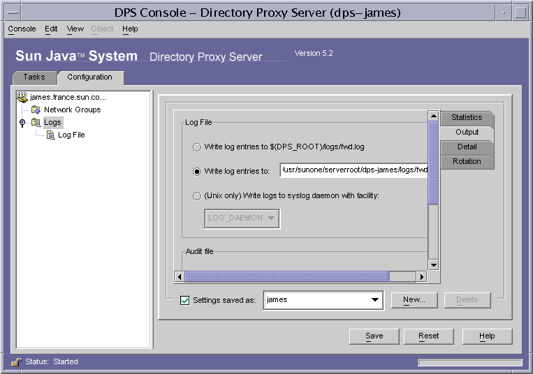

- Select the Output tab and specify where log entries should be sent and whether to log audit traces.
Log file. Displays options governing where Directory Proxy Server will write its log entries.
Write log entries to $(dps_ROOT)/logs/fwd.log. This is the default setting in which Directory Proxy Server will write its log entries to the file $(dps_ROOT)/logs/fwd.log where $(dps_ROOT) is the directory under the server root where Directory Proxy Server is installed, typically /usr/sunone/servers/dps-<hostname> or \Program\Files\sunone\Servers\dps-<hostname>.
Write log entries to. Specify an alternative file to which Directory Proxy Server will direct its log entries. The file separator must follow UNIX conventions regardless of platform.
Write logs to syslog daemon with facility. (UNIX only) Choose a syslog facility code that Directory Proxy Server will use to log entries. This setting should be chosen only if this log property is to be used by Directory Proxy Server installed on a UNIX machine.
Audit File. Displays options governing where Directory Proxy Server will write its audit log entries. For this feature to work, audit logging must be enabled by selecting the "Client auditing information" option in the Statistics tab.
Write audit entries with other log entries. This is the default setting in which Directory Proxy Server will write its audit log entries to the same output specified in the log file settings above.
Write log entries to. Specify an alternative file to which Directory Proxy Server will direct its audit log entries. The file separator should follow UNIX conventions regardless of platform.
Write audits to syslog daemon with facility. (UNIX only) Choose a syslog facility code that Directory Proxy Server will use to log audit entries. This setting should be chosen only if this log property is to be used by Directory Proxy Servers hosted on a UNIX machine.

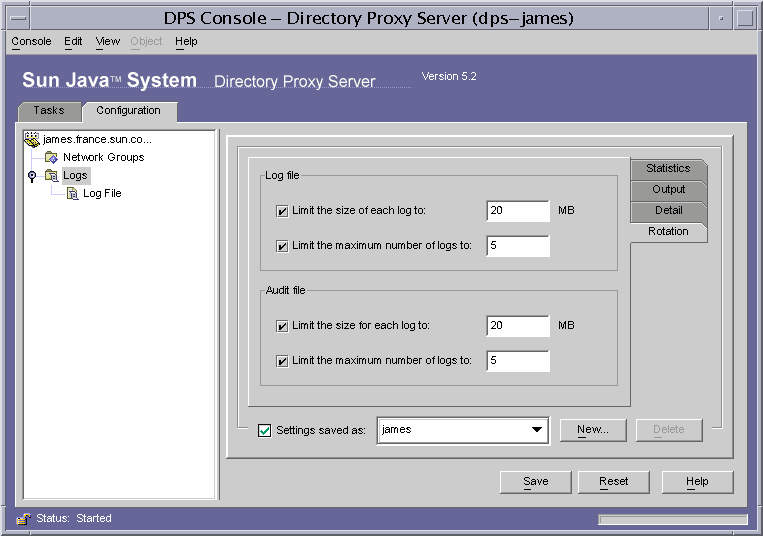

- Select the Rotation tab to control how logs are sized and rotated.
Log file. Displays options limiting the size and maximum number of Directory Proxy Server log files.
Limit the size of each log to. Enter the maximum size in megabytes for each log file.
Limit the maximum number of logs to. Enter the maximum number of log files to be created and rotated.
Audit file. Displays options limiting the size and maximum number of Directory Proxy Server audit files.
Limit the size of each log to. Enter the maximum size in megabytes for each audit log file.
Limit the maximum number of logs to. Enter the maximum number of audit log files to be created and rotated.
