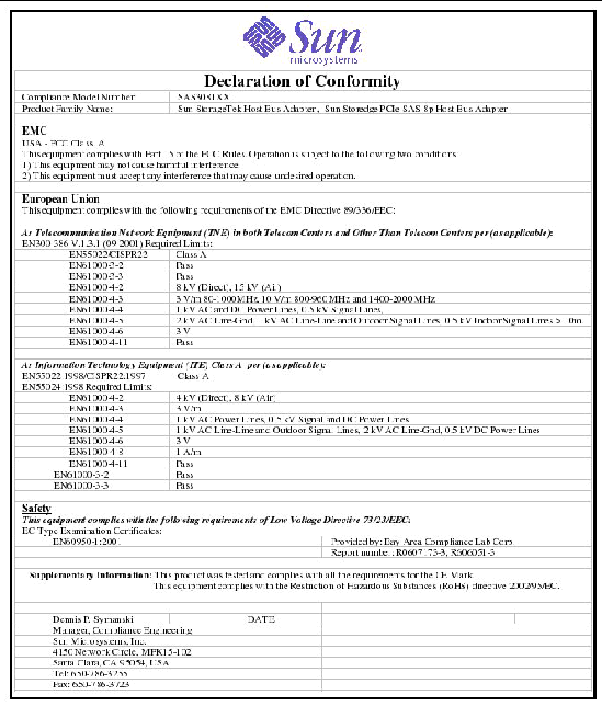

Declaration of Conformity, Regulatory Compliance, and Safety Statements
This appendix contains the following information that applies to the Sun StorageTek PCI Express SAS 8-Channel HBA:
Safety Agency Compliance Statements
