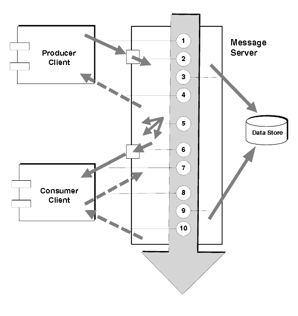

Factors That Affect PerformanceMessage latency and message throughput, two of the main performance indicators, generally depend on the time it takes a typical message to complete various steps in the message delivery process. These steps are shown below for the case of a persistent, reliably delivered message. The steps are described following the illustration.
Figure 11-1 Message Delivery Through a Message Queue Service
- The message is delivered from producing client to message server
- The message server reads in the message
- The message is placed in persistent storage (for reliability)
- The message server confirms receipt of the message (for reliability)
- The message server determines the routing for the message
- The message server writes out the message
- The message is delivered from message server to consuming client
- The consuming client acknowledges receipt of the message (for reliability)
- The message server processes client acknowledgment (for reliability)
- The message server confirms that client acknowledgment has been processed
Since these steps are sequential, any step can be a potential bottleneck in the delivery of messages from producing clients to consuming clients. Most of these steps depend upon physical characteristics of the messaging system: network bandwidth, computer processing speeds, message server architecture, and so forth. Some, however, also depend on characteristics of the messaging application and the level of reliability it requires.

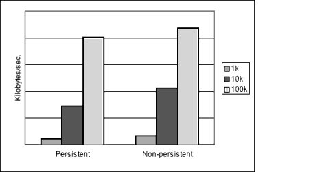

Delivery Mode (Persistent/Non-persistent Messages)
Persistent messages guarantee message delivery in case of message server failure. The broker stores the message in a persistent store until all intended consumers acknowledge they have consumed the message.
Broker processing of persistent messages is slower than for non-persistent messages for the following reasons:
- A broker must reliably store a persistent message so that it will not be lost should the broker fail.
- The broker must confirm receipt of each persistent message it receives. Delivery to the broker is guaranteed once the method producing the message returns without an exception.
- Depending on the client acknowledgment mode, the broker might need to confirm a consuming client’s acknowledgment of a persistent message.
The differences in performance between the persistent and non-persistent modes can be significant. Figure 11-2 compares throughput for persistent and non-persistent messages in two reliable delivery cases: 10k-sized messages delivered both to a queue and to a topic with durable subscriptions. Both cases use the AUTO_ACKNOWLEDGE acknowledgment mode.

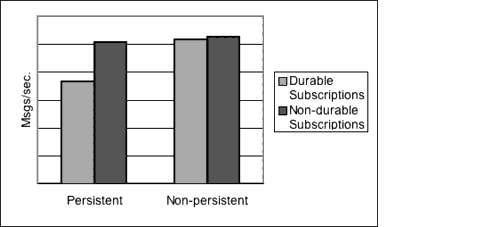

Durable and Non-durable Subscriptions
Subscribers to a topic destination fall into two categories, those with durable and non-durable subscriptions.
Durable subscriptions provide increased reliability but slower throughput, for the following reasons:
- The Message Queue message server must persistently store the list of messages assigned to each durable subscription so that should a message server fail, the list is available after recovery.
- Persistent messages for durable subscriptions are stored persistently, so that should a message server fail, the messages can still be delivered after recovery, when the corresponding consumer becomes active. By contrast, persistent messages for non-durable subscriptions are not stored persistently (should a message server fail, the corresponding consumer connection is lost and the message would never be delivered).
Figure 11-3 compares throughput for topic destinations with durable and non-durable subscriptions in two cases: persistent and non-persistent 10k-sized messages. Both cases use AUTO_ACKNOWLEDGE acknowledgment mode.
You can see from Figure 11-3 that the performance impact of using durable subscriptions is manifest only in the case of persistent messages; and the impact in that case is because persistent messages are only stored persistently for durable subscriptions, as explained above.

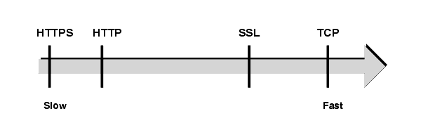

Transport Protocols
Message Queue software allows clients to communicate with the message server using various low-level transport protocols. Message Queue supports the connection services (and corresponding protocols) described in Connection Services.
The choice of protocols is based on application requirements (encrypted, accessible through a firewall), but the choice impacts overall performance.
Figure 11-5 Transport Protocol Speeds
Figure 11-5 reflects the performance characteristics of the various protocol technologies:
- TCP provides the fastest method to communicate with the broker.

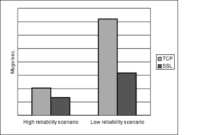

- SSL is 50 to 70 percent slower than TCP when it comes to sending and receiving messages (50 percent for persistent messages, closer to 70 percent for non-persistent messages). Additionally, establishing the initial connection is slower with SSL (it might take several seconds) because the client and broker (or Web Server in the case of HTTPS) need to establish a private key to be used when encrypting the data for transmission. The performance drop is caused by the additional processing required to encrypt and decrypt each low-level TCP packet.
Figure 11-6 compares throughput for TCP and SSL for two cases: a high reliability scenario (1k persistent messages sent to topic destinations with durable subscriptions and using AUTO_ACKNOWLEDGE acknowledgment mode) and a high performance scenario (1k non-persistent messages sent to topic destinations without durable subscriptions and using DUPS_OK_ACKNOWLEDGE acknowledgment mode).
Figure 11-6 shows that protocol has less impact in the high reliability case. This is probably because the persistence overhead required in the high reliability case is a more important factor in limiting throughput than the protocol speed.
Figure 11-6 Performance Impact of Transport Protocol

Once a protocol that meets application needs has been chosen, additional tuning (based on the selected protocol) might improve performance.
A protocol's performance can be modified using the following three broker properties:
For TCP and SSL protocols, these properties affect the speed of message delivery between client and broker. For HTTP and HTTPS protocols, these properties affect the speed of message delivery between the Message Queue tunnel servlet (running on a Web server) and the broker. For HTTP/HTTPS protocols there are additional properties that can affect performance (see HTTP/HTTPS Tuning).
The protocol tuning properties are described in the following sections.

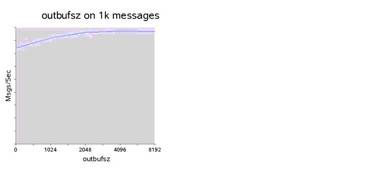

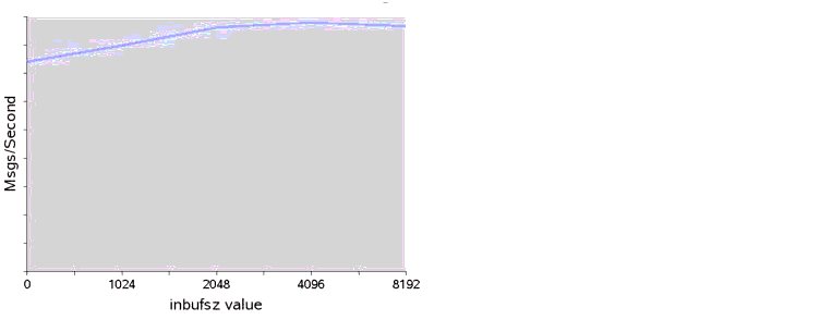

inbufsz/outbufsz
The inbufsz property sets the size of the buffer on the input stream reading data coming in from a socket. Similarly, outbufsz sets the buffer size of the output stream used by the broker to write data to the socket.
In general, both parameters should be set to values that are slightly larger than the average packet being received or sent. A good rule of thumb is to set these property values to the size of the average packet plus 1k (rounded to the nearest k).
For example, if the broker is receiving packets with a body size of 1k, the overall size of the packet (message body + header + properties) is about 1200 bytes. An inbufsz of 2k (2048 bytes) gives reasonable performance.
Increasing the inbufsz or outbufsz greater than that size may improve performance slightly; however, it increases the memory needed for each connection.
Figure 11-7 shows the consequence of changing inbufsz on a 1k packet.
Figure 11-7 Effect of Changing inbufsz on a 1k (1024 bytes) Packet
Figure 11-8 shows the consequence of changing outbufsz on a 1k packet.
Figure 11-8 Effect of Changing outbufsz on a 1k (1024 bytes) Packet
