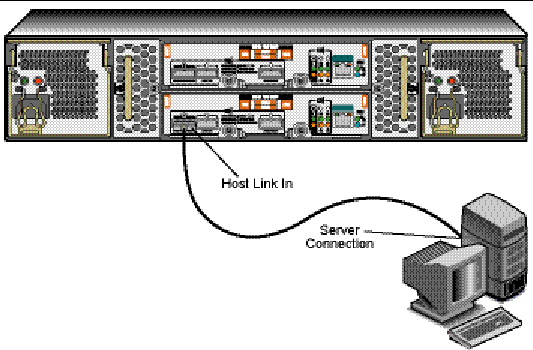

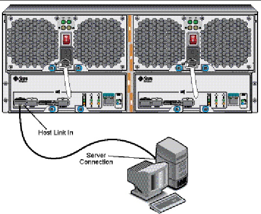

1. Locate the Host or SIM Link In (SIM 0) connector at the back of the tray (FIGURE 3-1 and FIGURE 3-2).
2. Connect the SAS Host or SIM Link In connector to a SAS port on the data host.
FIGURE 3-1 J4200 Array Connected to a Management System
FIGURE 3-2 J4400 Array Connected to a Management System

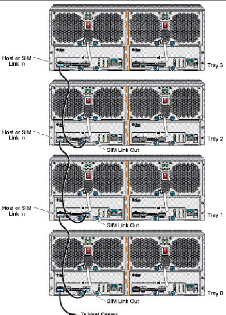

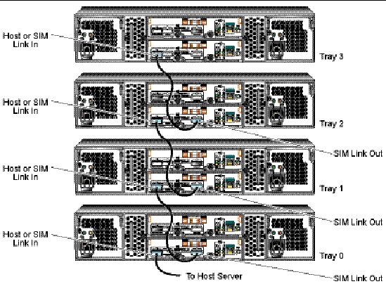

FIGURE 3-3 shows a Sun Storage J4200 Array interconnected with three other J4200 arrays.
FIGURE 3-3 Interconnected J4200 Arrays
FIGURE 3-4 shows a Sun Storage J4400 array interconnected with three other J4400 arrays.
FIGURE 3-4 Interconnected J4400 Arrays

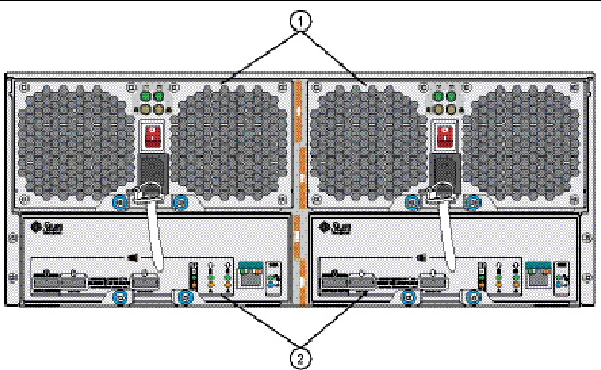

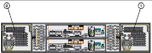

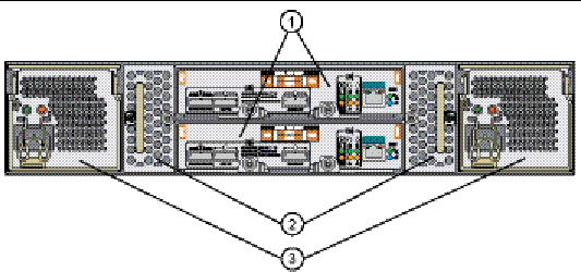

FIGURE 3-5 and FIGURE 3-6 show the J4200 and J4400 array rear components, including the two power supplies with universal power input connectors.
FIGURE 3-5 J4200 Array Rear Components
FIGURE 3-6 J4400 Array Rear Components
