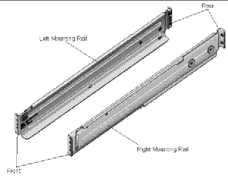

The rail kits for both the J4200 array and J4400 array contain the appropriate cabinet rails and all required mounting hardware for installing in any of the supported cabinet types. Each rail adjusts to cabinet rail depths from 24 inches (60.96 cm) to 36 inches (91.44cm).
FIGURE 1 Left and Right Mounting Rails (J4200 Array Rails Shown)

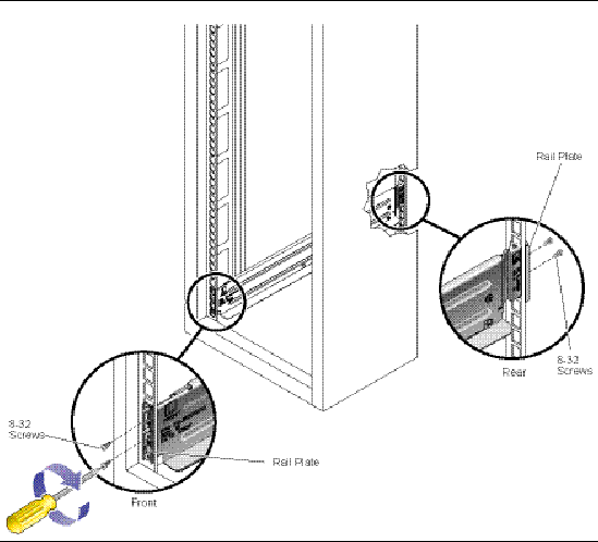

2. Start at the front of the cabinet. Install one of the M6 rail plate brackets to each side of the rack (see FIGURE 3).
a. With the text on the bracket facing toward you, align the two pins of the rail plate bracket with the holes on the cabinet rail.
b. For the J4200 and J4400 rack mounting plates, insert an M6 screw in the lower hole and tighten. For the J4400, insert an additional M6 screw in the top hole.
3. At the back of the cabinet, repeat step 2 to install the remaining two M6 rail plate brackets.
FIGURE 3 Attaching the Rail Plates to the Cabinet Rail for the J4200 Array

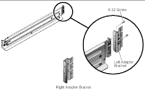

1. Install the rear rail adapter brackets onto the left and right rails. (See FIGURE 5.)
| Note - Rails are labeled L (left), Front and Rear, and R (right), Front and Rear. (See FIGURE 1.) |
2. Insert and tighten two 8-32 screws (four 8-32 screws for the J4400) to secure the adapter bracket to each rail.
FIGURE 5 Attaching the Adapter Brackets to the Rail (J4200)

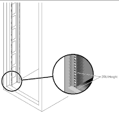

3. Starting at the bottom of the cabinet, locate the appropriate mounting unit height. The J4200 array requires two standard rack units (2RU) and the J4400 array requires four standard rack units (4RU) of vertical space in the cabinet (See FIGURE 6).
| Note - Each standard rack unit (RU) consists of three mounting holes in the left and right cabinet rails. |
FIGURE 6 Locating the Rack Unit (RU) Height for the J4200 Array

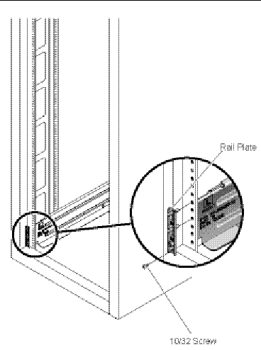

4. At the front of the cabinet, install the 10-32 rail plate brackets to the left and right cabinet rails.
a. With the text on the bracket facing our, align and insert the two pins of the rail plate bracket into the cabinet rail holes.
b. For the J4200 and J4400 rack mounting plates, insert a 10-32 screw in the lower hole and tighten. For the J4400, insert an additional 10-32 screw in the top hole.
FIGURE 7 Attaching the Rail Plates to the Cabinet Rail (J4200)

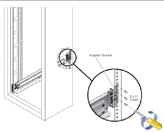

5. For ease of installation, attach the left and right rails from the back of the cabinet. (See FIGURE 8.) Follow these steps for the left rail:
a. Position the front of the rail inside the cabinet, insert the rail holes onto the two pins of the front rail plate bracket.
b. Adjust the rail length to fit the size of the cabinet.
Be sure to align the rail flange so that the mounting holes at the front correspond to those at the back of the cabinet.
c. Align and insert the rear rail pin into the cabinet rail hole.
d. Add three 10-32 screws (six 10-32 screws for the J4400) to secure the rear adapter to the rack. (See FIGURE 8.)
e. From the front of the cabinet, insert two 8-32 screws (four 8-32 screws for the J4400) to secure the rail to the cabinet.
f. Repeat Step a through Step e for the right rail.
Caution - Make sure you install the front screws into the rail bracket to secure the rail to the rack to avoid damage to the device or person installing the device. |
FIGURE 8 Securing the Adapter Brackets to the Cabinet Rail (J4200)

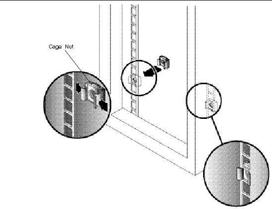

2. At the front of the cabinet, snap a cage nut into the lower hole of the 2RU of the right rail (and an additional cage nut in the top hole of the 4RU for the J4400). Repeat for the left rail. (See FIGURE 9.)
FIGURE 9 Inserting Cage Nuts Into the Cabinet Rail Mounting Holes (J4200)
