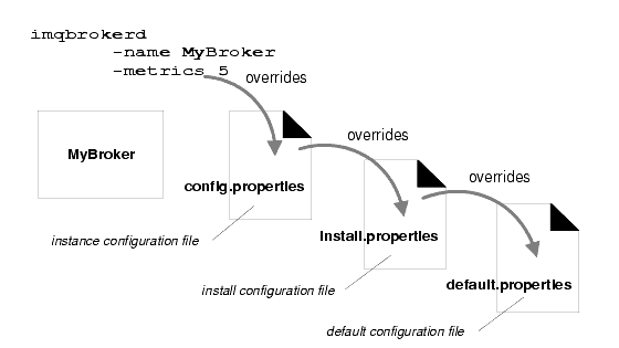

Merging Property Values
At startup, the system merges property values in the different configuration files. It uses values set in the installation and instance configuration files to override values specified in the default configuration file. You can override the resulting values by using imqbrokerd command options. This scheme is illustrated in Figure 5-1.
Figure 5-1    Broker Configuration Files
Diagram showing that command line options override config.properties options, which override install.properties options, which override default options.
