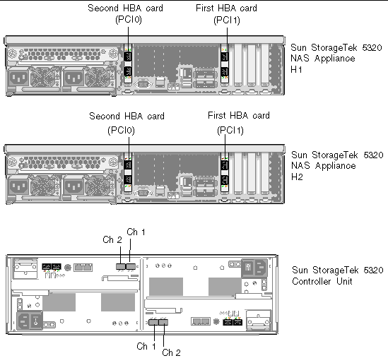

FIGURE 4-1shows the ports of a cluster appliance and controller units.
Note - HBA cards for storage connections are inserted only in PCI slot 1 (PCI1) and PCI slot 0 (PCI0) of each server in the Sun StorageTek 5320 NAS Cluster Appliance. |

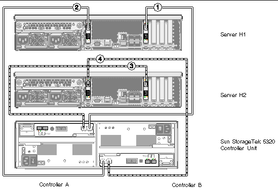

Use the instructions in this section if you are connecting one controller unit to the Sun StorageTek 5320 NAS Cluster Appliance.
1. Connect the HBA port 1 (top port) of the first HBA card (PCI1) on the Sun StorageTek 5320 NAS Cluster Appliance H1 to the Controller A Ch 1 port.
The H1 and H2 cluster pairs are identifed by the software serial number located on a printed label at the front of the server. (See Sun StorageTek 5320 NAS Appliance Server.)
2. Connect the HBA port 1 of the second HBA card (PCI0) on the cluster appliance H1 to the Controller B Ch 1 port.
3. Connect the HBA port 1 of the first HBA card on the cluster appliance H2 to the Controller A Ch 2 port.
4. Connect the HBA port 1 of the second HBA card on the cluster appliance H2 to the Controller B Ch 2 port.
Note - The preceding figure is for illustrative purposes only. The units have more space between them when they are installed in a cabinet. |

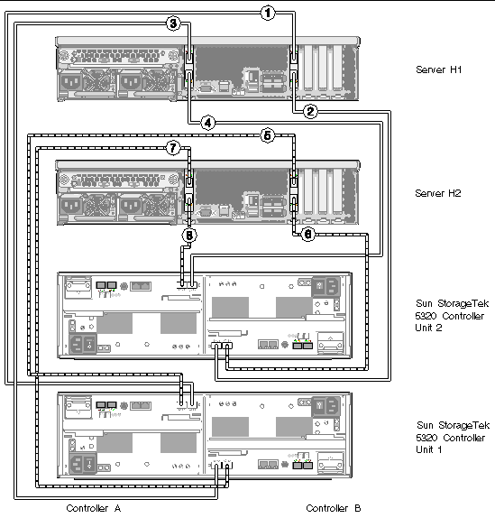

Use the instructions in this section and refer to FIGURE 4-3 if you are connecting two controller units to the Sun StorageTek 5320 NAS Cluster Appliance.
1. Connect the HBA port 1 (top port) of the first HBA card (PCI1) on the Sun StorageTek 5320 NAS Cluster Appliance server H1 to the Controller A Ch 1 port on the first (bottom) controller unit (Unit 1).
2. Connect the HBA port 2 of the first HBA card on the cluster appliance H1 to the Controller B Ch 1 port on the second (top) controller unit (Unit 2).
3. Connect the HBA port 1 of the second HBA card (PCI0) on the cluster appliance H1 to the Controller B Ch 1 port on Unit 1.
4. Connect the HBA port 2 of the second HBA card on the cluster appliance H1 to the Controller A Ch 1 port on Unit 2.
5. Connect HBA port 1 of the first HBA card (PCI1) on the cluster appliance H2 to the Controller A Ch 2 port on Unit 1.
6. Connect HBA port 2 of the first HBA card on the cluster appliance H2 to the Controller B Ch 2 port on Unit 2.
7. Connect HBA port 1 of the second HBA card (PCI0) on the cluster appliance H2 to the Controller B Ch 2 port on Unit 1.
8. Connect HBA port 2 of the second HBA card on the cluster appliance H2 to the Controller A Ch 2 port on Unit 2.

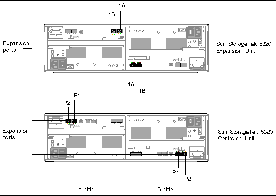

Each controller unit uses Controller A and Controller B expansion ports to connect to FC-AL ports at the back of an expansion unit (FIGURE 4-4).
The cabling differs depending on the number of expansion units you are connecting:

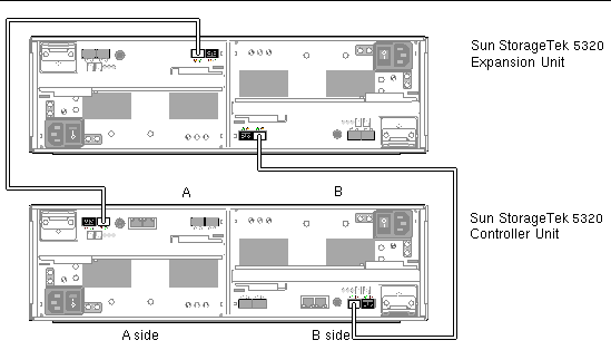

To connect a controller unit and one expansion unit, two 2-meter fiber cables are required. Refer to FIGURE 4-5.
1. Connect one fiber cable between the A side expansion port P1 of the controller unit and the A side port 1B of the expansion unit.
2. Connect one fiber cable between the B side expansion port P1 of the controller unit and the B side port 1B of the expansion unit.

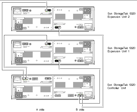

To connect a controller unit and two expansion units, four 2-meter fiber cables are required. Refer to FIGURE 4-6.
1. Connect one fiber cable between the A side expansion port P2 of the controller unit and the A side port 1B of expansion unit 2.
2. Connect one fiber cable between the A side expansion port P1 of the controller unit and the A side port 1B of expansion unit 1.
3. Connect one fiber cable between the B side expansion port P1 of the controller unit and the B side port 1B of expansion unit 1.
4. Connect one fiber cable between the B side expansion port P2 of the controller unit and the B side port 1B of expansion unit 2.

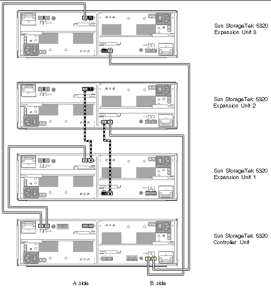

To connect a controller unit and three expansion units, six 2-meter fiber cables are required. Refer to FIGURE 4-7.
1. Connect one fiber cable between the A side expansion port P2 of the controller unit and the A side port 1B of expansion unit 3.
3. Connect one fiber cable between the A side port 1A of expansion unit 1 and the A side port 1B of expansion unit 2.
4. Connect one fiber cable between the B side expansion port P1 of the controller unit and the B side port 1B of expansion unit 2.
5. Connect one fiber cable between the B side expansion port P2 of the controller unit and the B side port 1B of expansion unit 3.
6. Connect one fiber cable between the B side port 1B of expansion unit 1 and the B side port 1A of expansion unit 2.

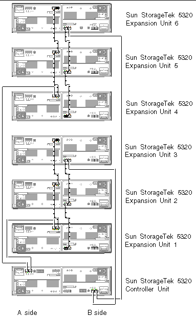

To connect a controller unit and six expansion units, twelve 2-meter fiber cables are required. Refer to FIGURE 4-8.
Note - In a configuration with two controller units, a maximum of four expansion units can be attached to each controller unit. |
1. Connect one fiber cable between the A side expansion port P2 of the controller unit and the A side port 1B of expansion unit 4.
4. Connect one fiber cable between the A side port 1A of expansion unit 2 and the A side port 1B of expansion unit 3.
5. Connect one fiber cable between the A side port 1A of expansion unit 4 and the A side port 1B of expansion unit 5.
6. Connect one fiber cable between the A side port 1A of expansion unit 5 and the A side port 1B of expansion unit 6.
7. Connect one fiber cable between the B side expansion port P1 of the controller unit and the B side port 1B of expansion unit 3.
8. Connect one fiber cable between the B side expansion port P2 of the controller unit and the B side port 1B of expansion unit 6.
9. Connect one fiber cable between the B side port 1B of expansion unit 1 and the B side port 1A of expansion unit 2.
10. Connect one fiber cable between the B side port 1B of expansion unit 2 and the B side port 1A of expansion unit 3.
11. Connect one fiber cable between the B side port 1B of expansion unit 4 and the B side port 1A of expansion unit 5.
12. Connect one fiber cable between the B side port 1B of expansion unit 5 and the B side port 1A of expansion unit 6.

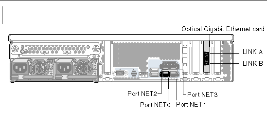

Each server in a Sun StorageTek 5320 NAS Cluster Appliance uses a dedicated Ethernet connection to communicate with its partner and perform periodic "health checks." The port used for the health check connection is referred to as the heartbeat port. The NET0 Gigabit Ethernet port is used for the heartbeat.
The Sun StorageTek 5320 NAS Cluster Appliance is commonly configured with two Gigabit Ethernet cards. FIGURE 4-9 shows a single card configuration.
Use a Cat5 Ethernet cable to connect the two servers' NET0 heartbeat ports.
The appliance must be configured with a second optical Gigabit Ethernet card.
Connect a fiber optic cable from the network to the top (LINK A) and connect another fiber optic cable from the network to the bottom (LINK B) optical Gigabit Ethernet connector on the back of each of the Sun StorageTek 5320 NAS Cluster Appliances.
Later, when you configure the system (see Initial Sun StorageTek 5320 NAS Cluster Appliance Configuration), the ports will be identified on the LCD as shown in TABLE 4-1.
If your system is configured for Fast Ethernet or Gigabit Ethernet networking, refer to FIGURE 4-9 for NIC port locations.
To connect the Sun StorageTek 5320 NAS Cluster Appliance to a Fast Ethernet or Gigabit Ethernet network, connect an RJ-45 unshielded twisted-pair cable from your local area network (LAN) to the NET1 port on the back of each of the Sun StorageTek 5320 NAS Cluster Appliances. For additional LAN connections, continue to connect in order: NET2 and NET3.

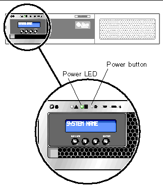

6. Power on server H1 (software serial number ending in "-H1") by using a pen tip or similar implement to press the recessed Power button (FIGURE 4-10).
Caution - Do not power up server H2 until directed in the instructions that follow. |
7. Verify that server H1 has finished booting up, as indicated by the LCD display "QUIET."

9. Power on the server H2 (software serial number ending in "-H2") by pressing the recessed Power button.
10. Wait until server H2's LCD display status is QUIET.
11. Use the instructions in Step 1 through Step 5 to assign server H2's IP address and gateway address.
