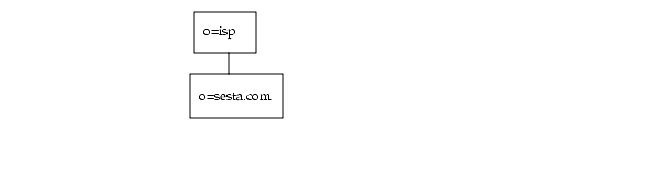

Retaining the Top Level Entry of the Directory Information Tree (DIT)
Before installing Sun ONE Identity Server 6.0 software you will need to verify that the Directory Server 5.1 installation that existed with iPlanet Directory Server Access Management Edition 5.1 is set up to retain the existing DIT structure and ensure proper installation. To retain the Sun ONE Identity Server 5.1 DIT structure, the top level entry must have the iplanet-am-service-status attribute set. Depending on your installation, this attribute may or may not be set at the top level of your DIT. For example, in the default installation of the Sun ONE Portal Server 6.0 release, the DIT might have a hierarchical structure with o=isp at the top of the structure and an organization such as o=sesta.com beneath it, as is shown in Figure 12-1.
Figure 12-1  Hierarchical Directory Structure
This figure illustrates a hierarchical directory structure. See the text preceding the figure for details on the structure.
In this case, isp is not really an organization and as such does not have an iplanet-am-service-status attribute set. To retain the Sun ONE Identity Server 5.1 DIT structure, the top level entry, isp, must be updated before you install Sun ONE Identity Server 6.0. If the Sun ONE Identity Server 5.1 Directory Server has an organization (flat DIT) as top level entry, then this change is not necessary before installing Sun ONE Identity Server 6.0.
To update the top level entry of your DIT:
  1. Set the LD_LIBRARY_PATH variable by appending the existing path with a colon and the path to the LIB directory on the directory server as follows:
  2. LD_LIBRARY_PATH=/usr/ldap/lib:/DS_BASEDIR/lib
  3. Export the LD_LIBRARY_PATH variable as follows:
  4. export LD_LIBRARY_PATH
  5. Use the ldapmodify command from the directory server install directory to update the top level entry, if it is not an organization. For example to update the o=isp
  6. /DS_BASEDIR/shared/bin/ldapmodify -D “cn=directory manager” -w PASSWORD
    dn: o=isp
          changetype: modify
    delete: objectClass
    objectClass: iplanet-am-managed-org
    add: objectClass
    objectClass: sunManagedOrganization
    add: iplanet-am-service-status
    iplanet-am-service-status:iPlanetAMAuthService
  7. Use the ldapsearch command to check the attribute settings. For example, to check the settings for o=sales entry, on hostname myserver with the root suffix of dc=sesta,dc=com
  8. /DS_BASEDIR/shared/bin/ldapsearch -v -h myserver -b "dc=sesta,dc=com" -s one "o=sales"
