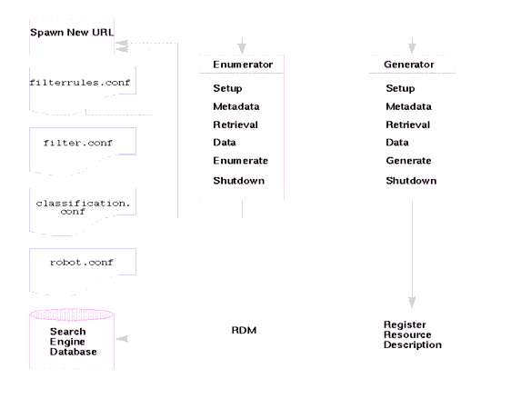

Figure 10-1 illustrates how the Search Engine robot works. In Figure 10-1, the robot examines URLs and their associated network resources. Each resource is tested by both the enumerator and the generator. If the resource passes the enumeration test, the robot checks it for additional URLs. If the resource passes the generator test, the robot generates a resource description that is stored in the Search Engine database.
Figure 10-1  How the Robot Works
This figure illustrates how the robot works. See the text following the figure for a description of the process.
