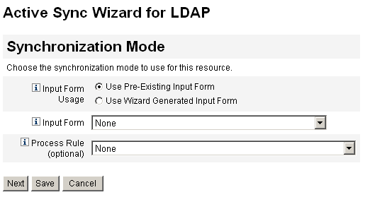

Synchronization Mode
The Synchronization Mode page lets you determine the range of configuration options you can choose during active synchronization setup.
Select from these options:
Input Form Usage — Select the mode to use when setting up active synchronization. You can choose to use a pre-existing form, which limits configuration choices for this resource. Alternatively, you can use a form that is generated by the Active Sync Wizard, which offers a complete set of configuration choices.
- If you select Pre-Existing Input Form (the default), then make selections for these options:
- Input Form — Select an input form that will process data updates. This optional configuration item allows attributes to be transformed before they are saved on the accounts.
- Process Rule — Optionally, select a process rule to run for each incoming account. This selection overrides all other options. If you specify a process rule, the process will be run for every row, regardless of other settings on the resource. It can be either a process name, or a rule evaluating to a process name.
Figure 13-17 Active Sync Wizard: Synchronization Mode, Pre-Existing Form Selections

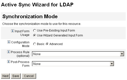

- If you select Use Wizard Generated Input Form, then make selections for these options:
- Configuration Mode — Select whether to use basic or advanced mode within the Active Sync Wizard. Basic mode is the default option. If you select advanced mode, you can define event types and set process rules.
- Process Rule — (Displays with advanced configuration mode only.) Optionally, select a process rule to run for each incoming account. This selection overrides all other options. If you specify a process rule, the process will be run for every row, regardless of other settings on the resource. It can be either a process name, or a rule evaluating to a process name.
- Post-Process Form — (Displays with advanced configuration mode only.) Optionally select a form to run, in addition to the form generated by the Active Sync Wizard. This form overrides any settings from the Active Sync Wizard.
Figure 13-18 Active Sync Wizard: Synchronization Mode, Wizard Generated Form Selections
Click Next to continue with the wizard. The Active Sync Running Settings page appears.

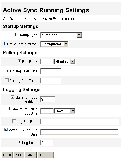

Running Settings
This page allows you to establish the following settings for active synchronization:
Startup Settings
Make selections for Active Sync startup from the following options:
Polling Settings
If you set a polling start date and time that is in the future, polling will begin when specified. If you set a polling start date and time that is in the past, Identity Manager determines when to begin polling based on this information and the polling interval. For example:
In this case, the resource will begin polling on July 25, 2005 (the following Monday).
If you do not specify a start date or time, then the resource will poll immediately. If you take this approach, each time the application server is restarted, all resources configured for active synchronization will begin polling immediately. The typical approach, is to set a start date and time.
Make selections to set up polling:
- Poll Every — Specify how often to poll. Enter a number, and then select the unit of time (Days, Hours, Minutes, Months, Seconds, or Weeks). Minutes is the default unit.
- Polling Start Date —- Enter the day that the first scheduling interval should start, in yyyyMMdd format.
- Polling Start Time — Enter the time of day that the first scheduling interval should start, in HH:mm:ss format.
Logging Settings
Make selections to set up logging information and levels from the following options:
- Maximum Log Archives — If greater than zero, retain the latest N log files. If zero, then a single log file is re-used. If -1, then log files are never discarded.
- Maximum Active Log Age — After this period of time has elapsed, the active log will be archived. If the time is zero, then no time-based archival will occur. If Maximum Log Archives is zero, then the active log will instead be truncated and re-used after this time period. This age criteria is evaluated independently of the time criteria specified by Maximum Log File Size.
Enter a number, and then select the unit of time (Days, Hours, Minutes, Months, Seconds, or Weeks). Days is the default unit.
- Log File Path — Enter the path to the directory in which to create the active and archived log files. Log file names begin with the resource name.
- Maximum Log file Size — Enter the maximum size, in bytes, of the active log file. The active log file will be archived when it reaches maximum size. If Maximum Log Archives is zero, then the active log will instead be truncated and re-used after this time period. This size criteria is evaluated independently of the age criteria specified by Maximum Active Log Age.
- Log Level — Enter the level of logging:
Figure 13-19 is a sample view of the Running Settings page.
Figure 13-19 Active Sync Wizard: Running Settings
Click Next to continue with the wizard. The General Active Sync Settings page appears.

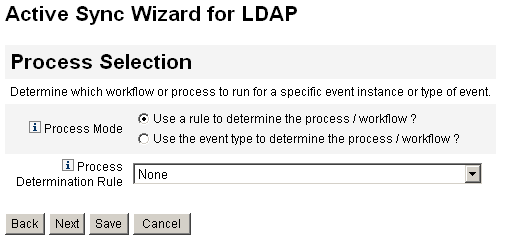

Process Selection
Use this page to set up a workflow or process to run when the user view is checked in for a specific active sync event instance or type of active sync event.
Process Mode
You can select from two modes that determine which workflow or process will run when an active sync event occurs:
After selecting this option, select a rule (process determination rule) from the list.
Figure 13-20 illustrates the Process Selection page where you indicate the rule selection.
Figure 13-20 Active Sync Wizard: Process Selection (Rule)

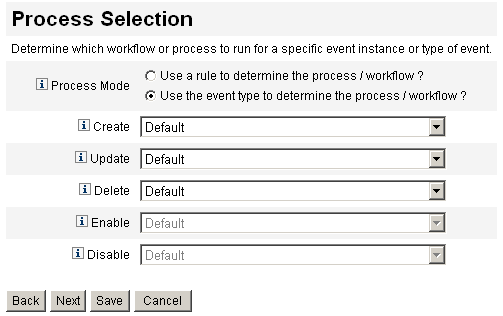

After selecting this option, select a workflow or process to run for each event type listed, as shown in Figure 13-21.
Figure 13-21 Active Sync Wizard: Process Selection (Event Type)

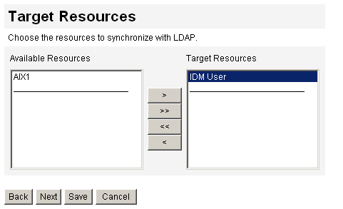

Target Resources
Use this page to specify target resources to synchronize with this resource.
Figure 13-22 Active Sync Wizard: Target Resources

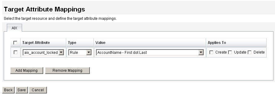

Target Attribute Mappings
Use this page to define the target attribute mappings for each target resource.
Figure 13-23 Active Sync Wizard: Target Attribute Mappings
- Select a target resource from the options list. To add a target attribute to the list, click Add Mapping.
- Select the attribute, type, and attribute value for each target attribute.
- In the Applies To column, select one or more actions (Create, Update, or Delete) to which the mapping will apply.
- Continue making selections for each target resource.
To remove an attribute row from the list, select the row, and then click Remove Mapping.
Click Save to save the attribute mappings and return to the resources list.
