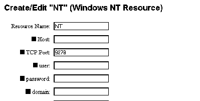

Each resource that you want Identity Manager to communicate with or manage must be defined by a resource object in Identity Manager. Identity Manager requires a resource object for each resource that it must manage. A resource adapter class contains the methods needed to register the resource object in the Identity Manager repository and to manage the external resource.
An adapter’s primary purpose is to define the essential characteristics of this resource type. This information is saved in the Identity Manager repository as a resource object.
Resource objects define the capabilities and configuration of the resource you are managing in Identity Manager, including the information described in Table 4-1.

Resource Attributes
Resource attributes define:
From the perspective of an administrator using the Identity Manager Administrator Interface, these attributes define the field names that are visible in the Identity Manager interface and prompt the user for values.
For Windows NT resources, attributes can include source name, host name, port number, user, password, and domain. For example, the Create/Edit Resource page for a resource type requires a host field in which administrators creating a resource identify the host on which the resource resides. This field (not the contents of the field) is defined in this adapter file.
- Authorized account that has rights to create users on the resource.
For a Windows NT resource, this includes the user and password fields.- Source attributes including the form, the Identity Manager administrator that the adapter will run as, scheduling and logging information, and additional attributes used only in Active Sync methods.
How Resource Attributes Are Defined
Resource attributes are defined in the Java file with the <ResourceAttribute> element as follows:
<ResourceAttribute name='"+RA_HOST+"' type='string' multi='false'\n"+ description='<b>host</b><br>Enter the resource host name.'>\n"+
The description field identifies the item-level help for the RA_HOST field. It cannot contain the characters “<’”. In the preceding example, they are replaced by < and '

Code Example 4-6 shows how prototypeXML defines fields displayed on the Create/Edit Resource page.
Code Example 4-6 prototypeXML Defining Fields Displayed on Create/Edit Resource Page

Identity Manager Rendering of prototypeXML
The Identity Manager Administrator interface displays the resource attributes for the default Windows NT resource as specified in the preceding section.
Figure 4-1 Resource Attributes for Windows NT Resource
