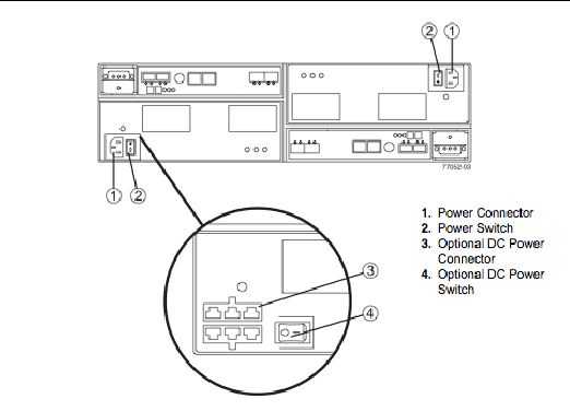

FIGURE B-1 shows the DC Power Connectors and DC Power Switch (item 15).
FIGURE
B-1 DC Power Connectors and DC Power Switch.
Caution - Risk of electrical shock -
This unit has more than one power source. |

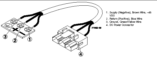

FIGURE
B-2 DC Power Connector Cable and Source Wires

The Sun StorageTek 6140 array is shipped with -48-VDC power connector cables if the DC power option is ordered. The power connector cable plugs into the DC power connector on the back of the array (Figure 6-3 on page 6-3). The three source wires on the other end of the power connector cable connect the array to centralized DC power plant equipment, typically through a bus bar above the cabinet. A qualified service person is required to make this DC power connection. DC Power Connector Cable and Source Wires shows the DC connector cable and the source wires.

4. A qualified service person is required to make the DC power connection per NEC and CEC guidelines. A two-pole 20-amp circuit breaker is required between the DC power source and DC-powered modules for over-current and short-circuit protection. Connect the DC power source wires on the other end of the DC power connector cable to the centralized DC power plant equipment as follows (see DC Power Connector Cable and Source Wires).
a. Connect the brown -48-VDC supply wire to the negative terminal.
b. Connect the blue return wire to the positive terminal.
c. Connect the green/yellow ground wire to the ground terminal.
