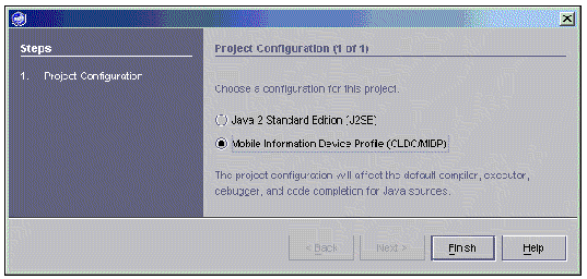

4. In the Project Configuration wizard, select the Mobile Information Device Profile CLDC/MIDP configuration and click Finish.
Configuring the project sets its default compiler, executor, debugger, and Java source code completion. Each project can have its own configuration.
Screenshot showing the project configuration wizard. Buttons are Finish and Help.

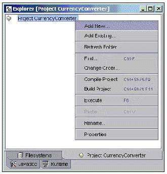

6. Select the Project tab in the Explorer window. Right-click the project name and choose Add New to add new components to the project or choose Add Existing to add existing components to the project.
The Explorer's Project tab displays the name of the current open project. When you first create a project, Mobile Edition IDE opens that project. When you add a new component to the project, you first select a template from the list of available templates, such as a MIDP right arrow MIDlet or MIDP right arrow MIDlet Suite. The appropriate wizard guides you through the steps to create that particular component.
Screenshot showing the Explorer window's Project tab with Add New selected.

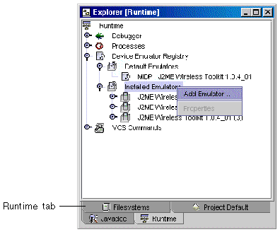

2. In the Explorer window, expand the Device Emulator Registry node. Right-click Installed Emulators and choose Add Emulator.
Screenshot showing the Add Emulator option. The callout indicates the Runtime tab.

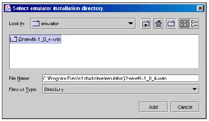

3. From the Select emulator installation directory dialog box, navigate to the directory that contains the emulator. Then click Add.
For the J2ME Wireless Toolkit emulator included with Mobile Edition, the directory is s1studio_install\emulator\j2mewtk-1_0_4-xxx.
Screenshot showing the Select emulator installation directory dialog box. The buttons are Add and Cancel.

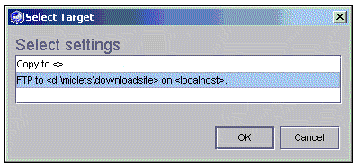

7. To deploy the application, select the MIDlet suite in the Explorer window and choose Tools right arrow Copy File. The Select Target dialog box opens. Select "FTP to <c:\midlets\downloadsite> on <localhost>" and click OK.
Screenshot showing the target settings for the FTP copy executor. Buttons are OK and Cancel.
The application is sent to the specified FTP site.
