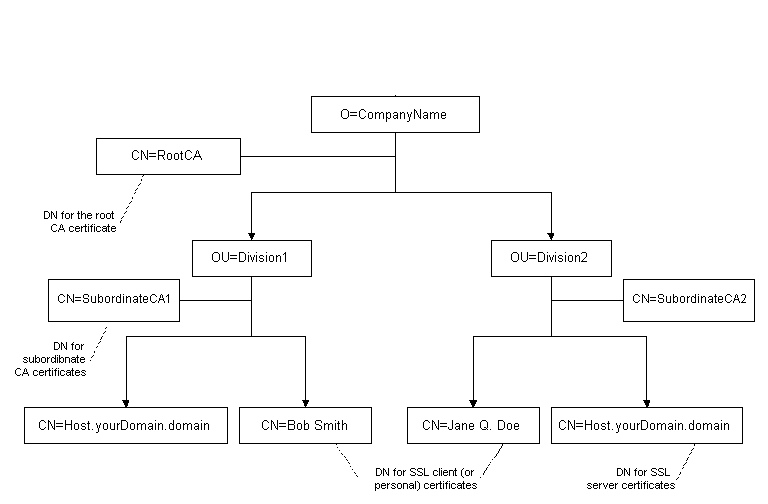

Selecting DNs for Certificates
Figure A-1 illustrates the structure of distinguished names you might select for CA certificates, server certificates, and personal certificates.
Figure A-1    Sample directory hierarchy ![]()
