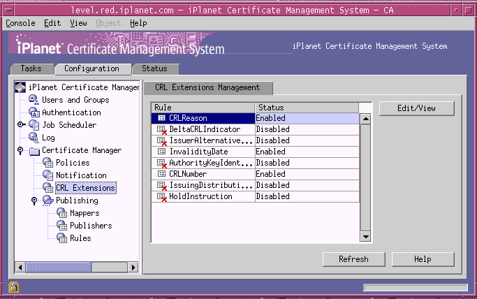

To enable you issue or publish X.509 v2 CRLs (that is, CRLs with extensions), Certificate Management System provides a set of plug-in modules; each module enables you to configure the Certificate Manager to set a particular CRL or CRL-entry extension in CRLs it issues. Plug-in modules are implemented as Java classes and are registered in the CMS publishing framework. The CRL Extensions Management tab of the CMS window (Figure 7-1) lists all the modules that are registered with a Certificate Manager.
When deciding whether to add CRL extensions, keep in mind that not all applications support version 2 CRLs. Among the applications that do support extensions, not all applications will recognize every extension. For general guidelines on using these extensions in CRLs, see Appendix C, Certificate and CRL Extensions.
Figure 7-1    Default CRL extension modules registered with a Certificate Manager ![]()
Table 7-1 lists CRL extension modules that are installed with a Certificate Manager. For instructions on how to configure a Certificate Manager to set CRL extensions, see section "Configuring a Certificate Manager to Publish Certificates and CRLs" in Chapter 19, "Setting Up LDAP Publishing" of CMS Installation and Setup Guide.

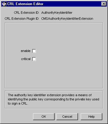

AuthorityKeyIdentifier Rule
The AuthorityKeyIdentifier rule enables you to configure a Certificate Manager to set the Authority Key Identifier Extension defined in X.509 and PKIX standard RFC 2459 (see http://www.ietf.org/rfc/rfc2459.txt ) in CRLs. The extension is used to identify the public key that corresponds to the private key used by a CA to sign CRLs.
The PKIX standard recommends that the CA must include this extension in all CRLs it issues. Therefore, you should consider adding this extension to all CRLs issued by the Certificate Manager. The reason for this is that in certain situations, a CA's public key may change (for example, when the key gets updated) or the CA may have multiple signing keys (either because of multiple concurrent key pairs or because of key changeover). In these cases, the CA ends up with more than one key pair. When verifying a signature on a certificate, other applications need to know which key was used in the signature. The extension, if present in a certificate, enables applications (those that can use the extension) to identify the correct key to use in situations when multiple keys exist; the extension specifies the public key to be used to verify the signature on the CRL.
For general guidelines on setting the authority key identifier extension in CRLs, see authorityKeyIdentifier.
Figure 7-2 shows how configurable parameters for the AuthorityKeyIdentifier rule are displayed in the CMS window.
Figure 7-2    Parameters defined in the AuthorityKeyIdentifier rule ![]()
The configuration shown in Figure 7-2 specifies that the server should not set the authority key identifier extension in CRLs.
Table 7-2 describes these parameters.

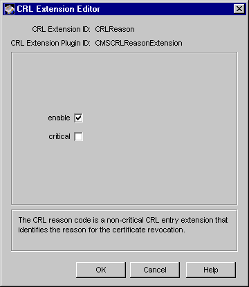

CRLReason Rule
The CRLReason rule enables you to configure a Certificate Manager to set the CRL ReasonCode Extension defined in X.509 and PKIX standard RFC 2459 (see http://www.ietf.org/rfc/rfc2459.txt ) in CRL entries. The extension is used to identify the reason for the revocation of a certificate included in the CRL.
For general guidelines on setting the CRL reason code in CRL entries, see reasonCode.
The revocation reasons defined by the standard are listed in Table 7-4.
Table 7-4    Certificate revocation reasons
Code
Reason
Figure 7-4 shows how the configurable parameters for the CRLReason rule are displayed in the CMS window.
Figure 7-4    Parameters defined in the CRLReason rule ![]()
The configuration shown in Figure 7-4 specifies that the server should set the CRL reason code extension in CRL entries.
Table 7-5 describes these parameters.

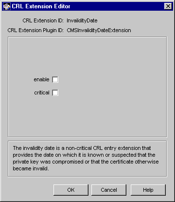

InvalidityDate Rule
The InvalidityDate rule enables you to configure a Certificate Manager to set the Invalidity Date Extension defined in X.509 and PKIX standard RFC 2459 (see http://www.ietf.org/rfc/rfc2459.txt ) in CRLs. The extension is a non-critical CRL entry extension that is used to specify the date on which it is known or suspected that the private key was compromised or that the certificate otherwise became invalid.
For general guidelines on setting the invalidity date extension in CRL entries, see invalidityDate.
Figure 7-6 shows how the configurable parameters for the InvalidityDate rule are displayed in the CMS window.
Figure 7-6    Parameters defined in the InvalidityDate rule ![]()
The configuration shown in Figure 7-6 specifies that the server should not set the invalidity date extension in CRL entries.
Table 7-7 describes these parameters.
