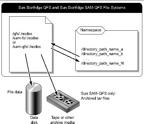

In Sun StorEdge QFS file systems, the .inodes file contains all the metadata except for the directory namespace (which consists of the path names to the directories where the files are stored). The.inodes file is located in the root (/) directory of the file system. For a file system to be restored, the .inodes file is needed, along with the additional metadata.
FIGURE 4-1 illustrates some characteristics of the .inodes file. The arrows indicate that the .inodes file points to file contents on disk and to the directory namespace, and that the namespace also points back to the .inodes file. In SAM-QFS file systems where archiving is being done, the .inodes file also points to archived copies.
The .inodes file is not archived. For more about protecting the .inodes file in these types of file systems, see Guidelines for Performing Metadata Dumps and Backing Up the Metadata in SAM-QFS File Systems.
Note - Sun StorEdge QFS has no archiving capability. For information on backing up Sun StorEdge QFS metadata, see the Sun StorEdge QFS Installation and Upgrade Guide. |
As indicated in FIGURE 4-1, the namespace (in the form of directories) does not point to the archive media. The directory path names for each archived file are copied into the headers of the tar(1) files on the archive media that contain the files, but the directory path names in the tar file headers may get out of sync with the actual locations of the files on the disk.
