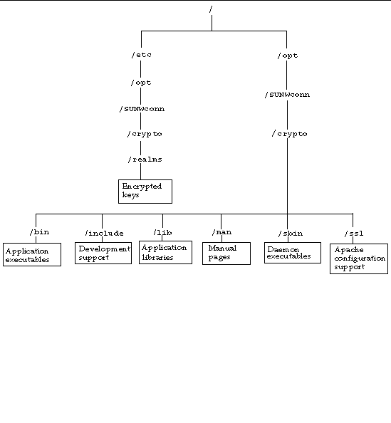

TABLE 2-2 shows the directories created by the default installation of the Sun Crypto Accelerator 1000 software.
FIGURE 2-1 shows the hierarchy of these directories and files.
