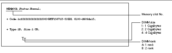

The figure here corrects FIGURE 6-20, “Explanation of DIMM Information,” on page 6-31 in Section 6.4.2.1, “Confirmation of DIMM Information.” The corrected figure is as follows.
FIGURE 6-20 shows an example of how to read the DIMM information displayed in the Type field.
FIGURE 6-20 Example of DIMM Information

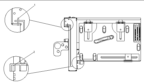

FIGURE 13-6 shows card positioning post and card positioning tab.
FIGURE 13-6 Card positioning post and card positioning tab
The post (item 1 in FIGURE 13-6) is seated in the notch of the bracket of the PCI card. If the post is not properly seated in the notch, the mounting bracket of the card may be bent and the card may end up being affixed in an inclined position on the PCI cassette. If a card is affixed in an inclined position, it will not be in proper electric contact with the socket on the IOU.
The tab (item 2 in FIGURE 13-6) fits in the notch on the lower part of the PCI card. This tab is helpful in positioning the card when it is mounted on the PCI cassette (however, some types of cards do not have the notch).
| Note - When the PCI cassette is removed from the IOU, the tab raises the front of the card from the card connector. |

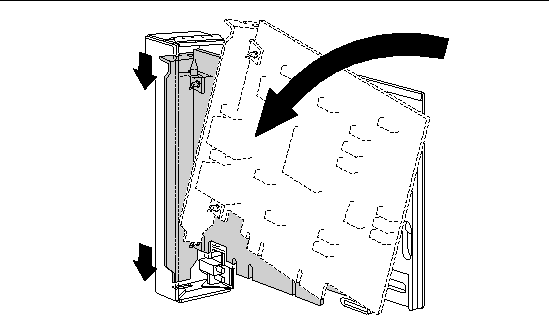

a. Move the PCI card in the direction of the arrow, and mount it on the PCI cassette by inserting the part projecting out at the bottom of the bracket of the PCI card into the hole at the bottom of the front panel of the PCI cassette and inserting the pin of the PCI cassette into the oval hole at the top of the bracket of the PCI card.
FIGURE 13-7 Mounting the PCI Card

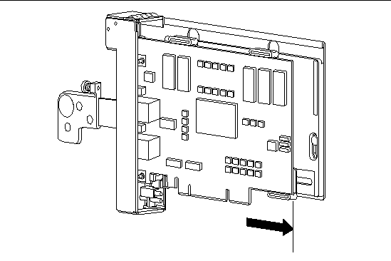

b. Push the PCI card until the notched part on the base plate of the PCI card touches the card-positioning tab from the PCI cassette.
| Note - When fixing the PCI card in position after aligning it with the card positioning tab, do so while pulling the lever about 2 cm from the frame. |
c. Align the PCI card with the center part of the lower latch of the cassette. Then, while pressing the PCI card against the center part of each of the upper latches of the cassette, tighten the fixing screws in the sequence shown in FIGURE 13- 8 to fix the card in position.
FIGURE 13-8 Sequence of Fixing the PCI Card in Position
