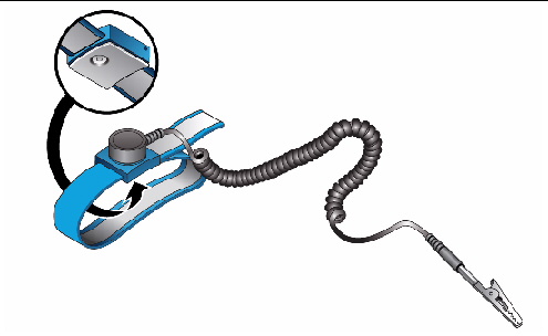

2. Connect an antistatic wrist strap clip to a server grounding port. See Grounding Port Connection Locations.
3. Ensure that the metallic underside of the wrist strap is in direct contact with your skin.
The wrist strap should be snug around the wrist so that it does not rotate.
FIGURE 2-1 Antistatic Wrist Strap Showing the Metallic Underside

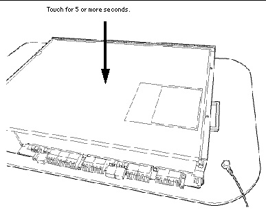

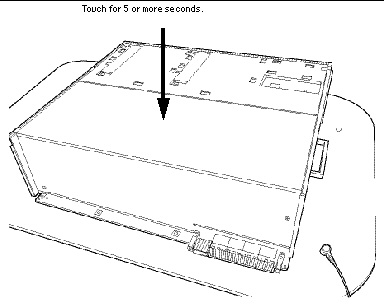

Removing Static Electricity on a CMU and an IOU
a. Prior to mounting a new CMU or IOU, place it on the grounded antistatic conductive mat.
b. Touch the metallic chassis for 5 or more seconds with your bare hand wearing the antistatic wrist strap. (See FIGURE 2-2 or FIGURE 2-3)
You cannot remove static electricity by touching the label.
FIGURE 2-2 Metallic Chassis (CMU)

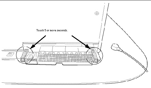

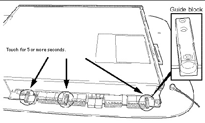

c. Touch each of the designated points on the guide blocks for 5 or more seconds with your bare hand wearing the antistatic wrist strap. (See FIGURE 2-4 or FIGURE 2-5)
FIGURE 2-4 Guide Blocks (CMU)
FIGURE 2-5 Guide Blocks (IOU)

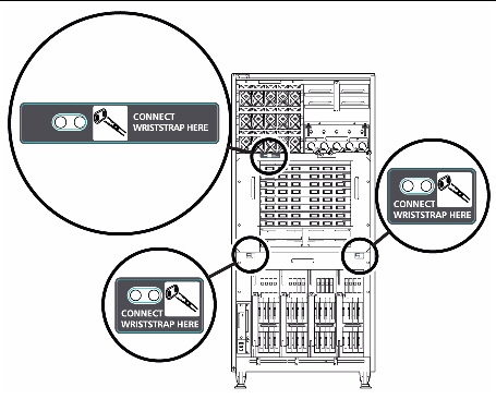

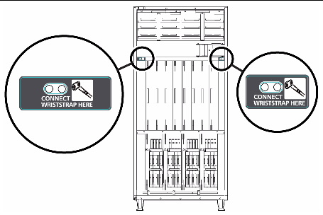

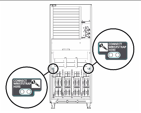

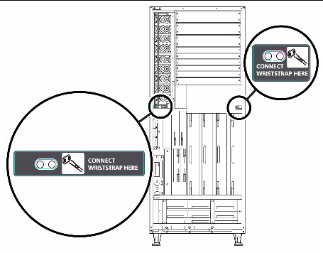

This section provides the information of the grounding port connection locations of the M8000/M9000 servers.
The grounding port can be used to connect the clip of the antistatic wrist strap and the antistatic conductive mat.
FIGURE 2-6 M8000 Grounding Port Connection Locations for the Wrist Strap Clip and the Antistatic Conductive Mat (Front View)
FIGURE 2-7 M8000 Grounding Port Connection Locations for the Wrist Strap Clip and the Antistatic Conductive Mat (Rear View)
FIGURE 2-8 M9000 Grounding Port Connection Locations for the Wrist Strap Clip and the Antistatic Conductive Mat (Front View)
FIGURE 2-9 M9000 Grounding Port Connection Locations for the Wrist Strap Clip and the Antistatic Conductive Mat (Rear View)
