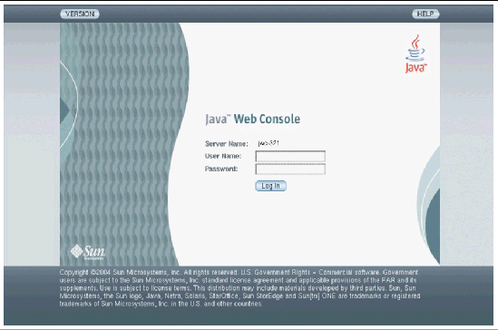

The Login Page is displayed, as shown on page 49.

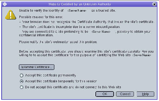

The first time you log in to the DRM server, the site security certificate is displayed, as shown below. This certificate authenticates your hostname as a trusted DRM server.
2. Enter your user name and password and click Log In.

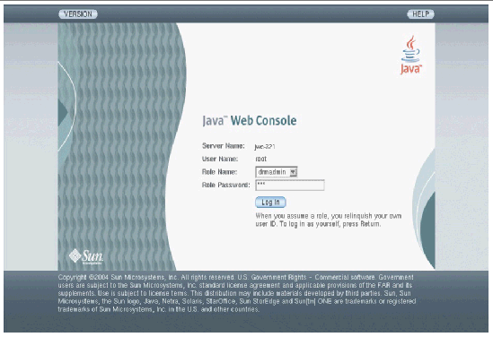

3. If you entered the user name and password of a user with the drmadmin role, select drmadmin from the Role Name list and provide the assigned role password, as shown here:

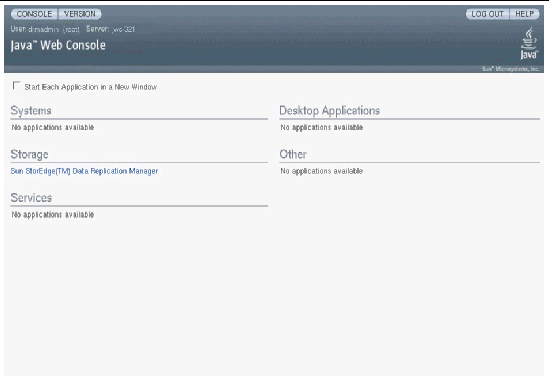

The Java Web Console page is displayed.
5. To access Data Replication Manager, select the Sun StorEdge Data Replication Manager link.

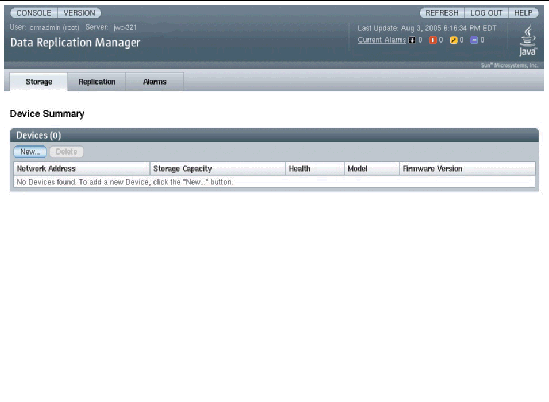

Data Replication Manager displays the Device Summary page, which enables you to manage registered replication devices. You must register devices for them to be listed here. For instructions, see the next section, Registering Devices.

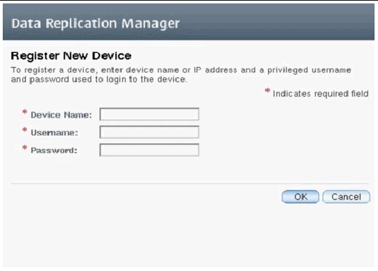

1. Click New on the Device Summary page.
The Register New Device page is displayed.
2. In the Device Name field, type a host name or IP address. In the Username and Password fields, type the user name and password that Data Replication Manager will require for access to the device.
Although Data Replication Manager stores this data on disk, this data is encrypted and cannot be read.
The registration process starts. As part of this process, Data Replication Manager logs in to the device and collects some initial data about the device.
When the process is complete, the Device Summary page displays the new device.
